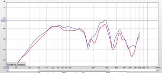

Some further comparsions. Now 8ohm version of L15P200/A (red) vs. L15P540 (blue).
Yeah, P540 indeed is better indeed and it also sounds better IRL. So, tham likes high Fs / low vas drivers?
I also made new TSP measurements for both drivers.

The worst one I have tested was RCF L15P200AK, absolutely no go for Tham but very good standard reflex driver. Even tho it might look like a good candidate according to specs but in practice it just lacks something and sounds horrible. L15P540 is much better as example.
Red, P200AK. Blue, P540
Those response curves illustrates the interesting thing I find about DIY THs in general. If I saw curves like that from a standard 4th order 6th order BP alignment that I was trying to put together, I'd toss the design and go back to the drawing board to come up with something better (like the attached, which shows a lot less out of band noise). But somehow a near identical FR curve is somehow acceptable if the alignment in question is a TH, and people have reported great success with it in actual use. Go figure...
