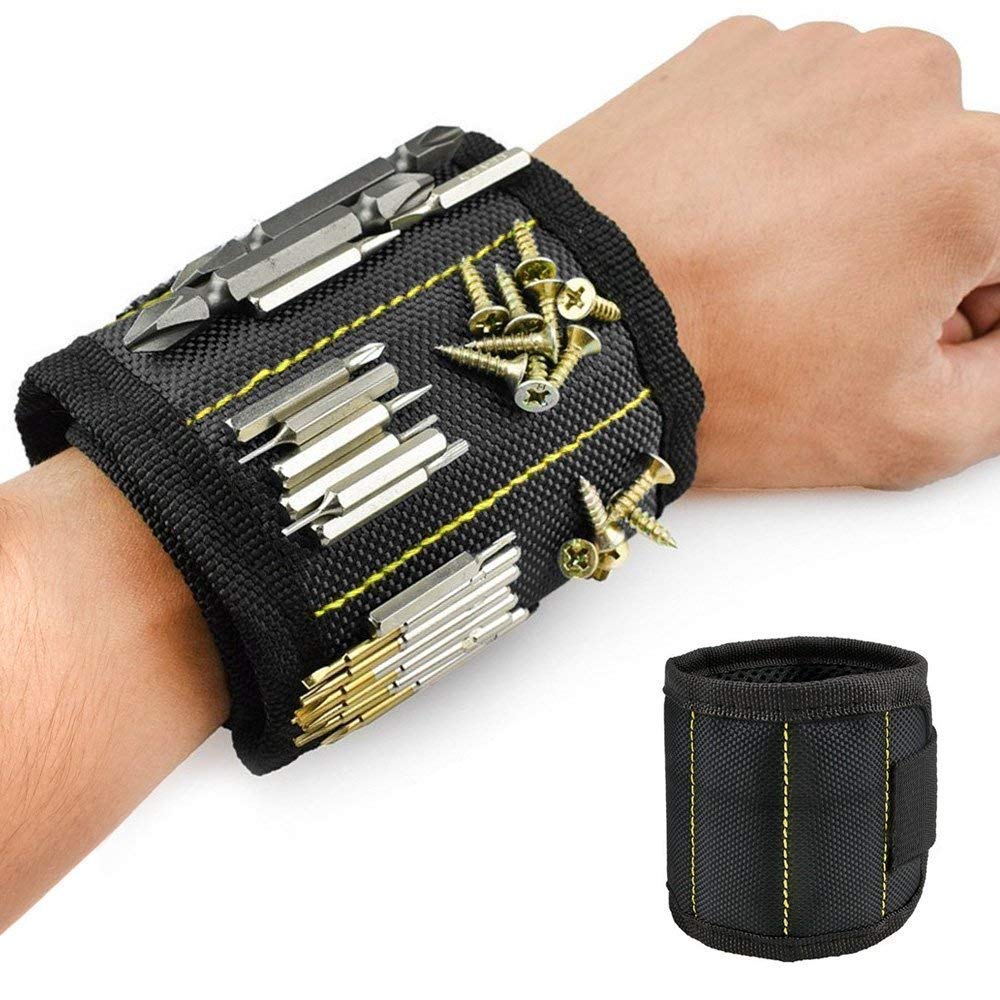

I use one of these now, but I used to use a magnetic bowl...
https://www.amazon.ca/gp/product/B07KH4NVPG/ref=ppx_yo_dt_b_asin_title_o05_s01?ie=UTF8&psc=1
