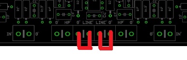

You can damp down the line gain further from times two with a voltage divider at the output. Replacing the 50 Ohm (R15) with a 470 Ohm, then adding another 470 Ohm across the output RCA. That brings a side effect of enlarging the output impedance, which might not be a problem for driving your amp if it has at least 10k input impedance, but it will also bring net gain of times one. Since you are looking for even less gain still. Your amp and speakers combination is probably sensitive. If unity gain proves rather low for you, you can bring it up to one point five by restoring the main gain setting to three.

Do I put the 470 ohm directly across the L/G and R/G outputs - is it best to solder the resistor on the underside of the board at the output connectors or is there a better place?

One 470Ω replaces R15 in each channel. The other one goes between tip and barrel of the line output RCA. But you can alternatively place it underneath the PCB between the line out and line GND pads of each channel.

P.S. If you are ever going to use the two line outputs at the same time, I recommend you wire one of those not from the one next to it but from the HP output on the board. Though with one own equal 49.9Ω resistor to the R15 buffering the main line output. In series with signal hot. So the two utilized parallel outputs won't interfere enough when hooked up to equipment down the chain. Say two power amps for biamping speakers, or a main power amp and a subwoofer's back plate amp etc.
