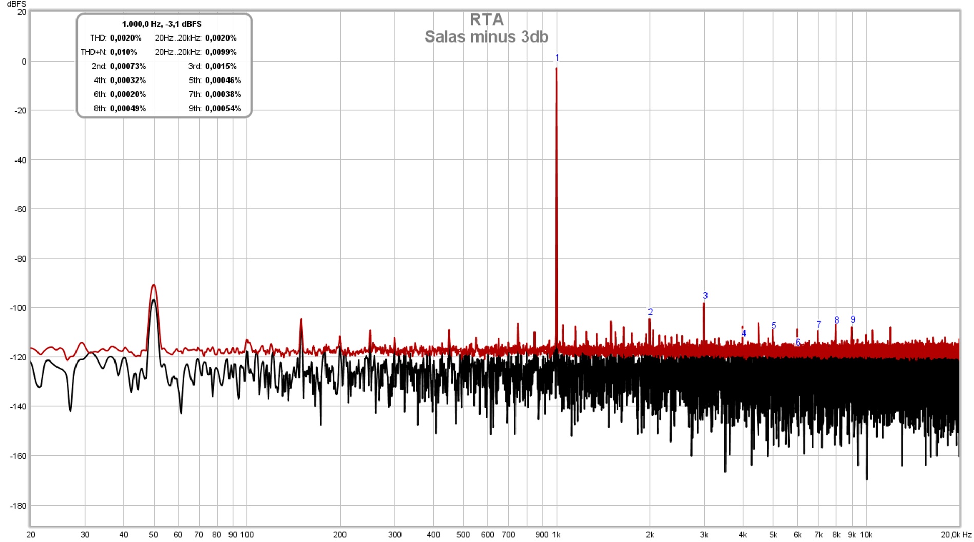

Salas, I have built a DCG3 a longer while ago. I was never really happy with it beside my other Pre/Headamps, which are a very old Raphael tube pre, a Whammy, a USSPA and a DCB1. All of them share a dominant 2nd harmonic distortion profile, which should the DCG3 show as well, when I look at your measures at the very beginning of this thread. It does not, as I found out recently. I have dominant 3rd harmonic and the sound is like that. I have it running at about 120mA and a stereo PSU. Since I would like to get out its abilities I ask you for help. Pls see here my measures.
BR Ernst
BR Ernst

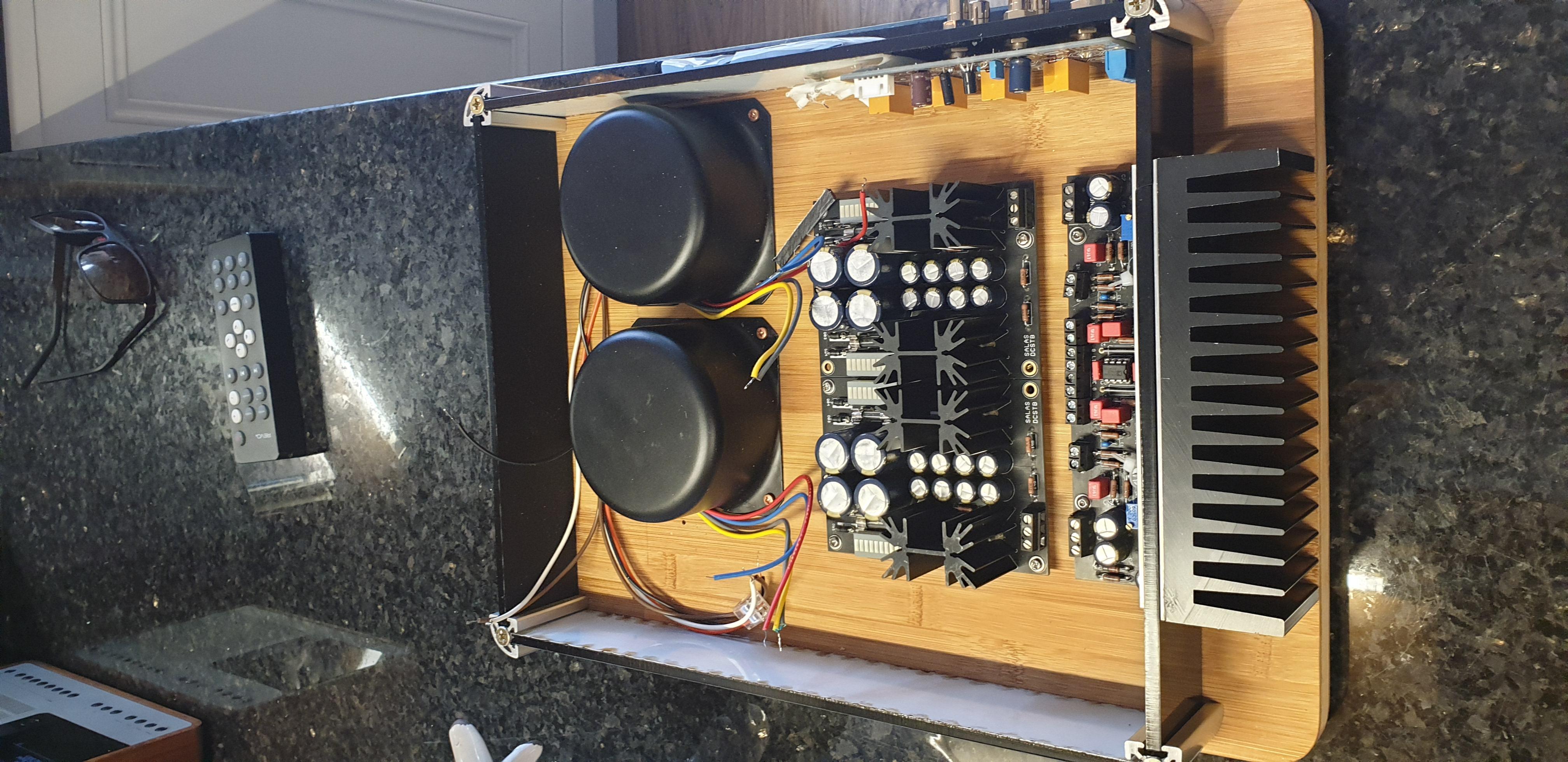

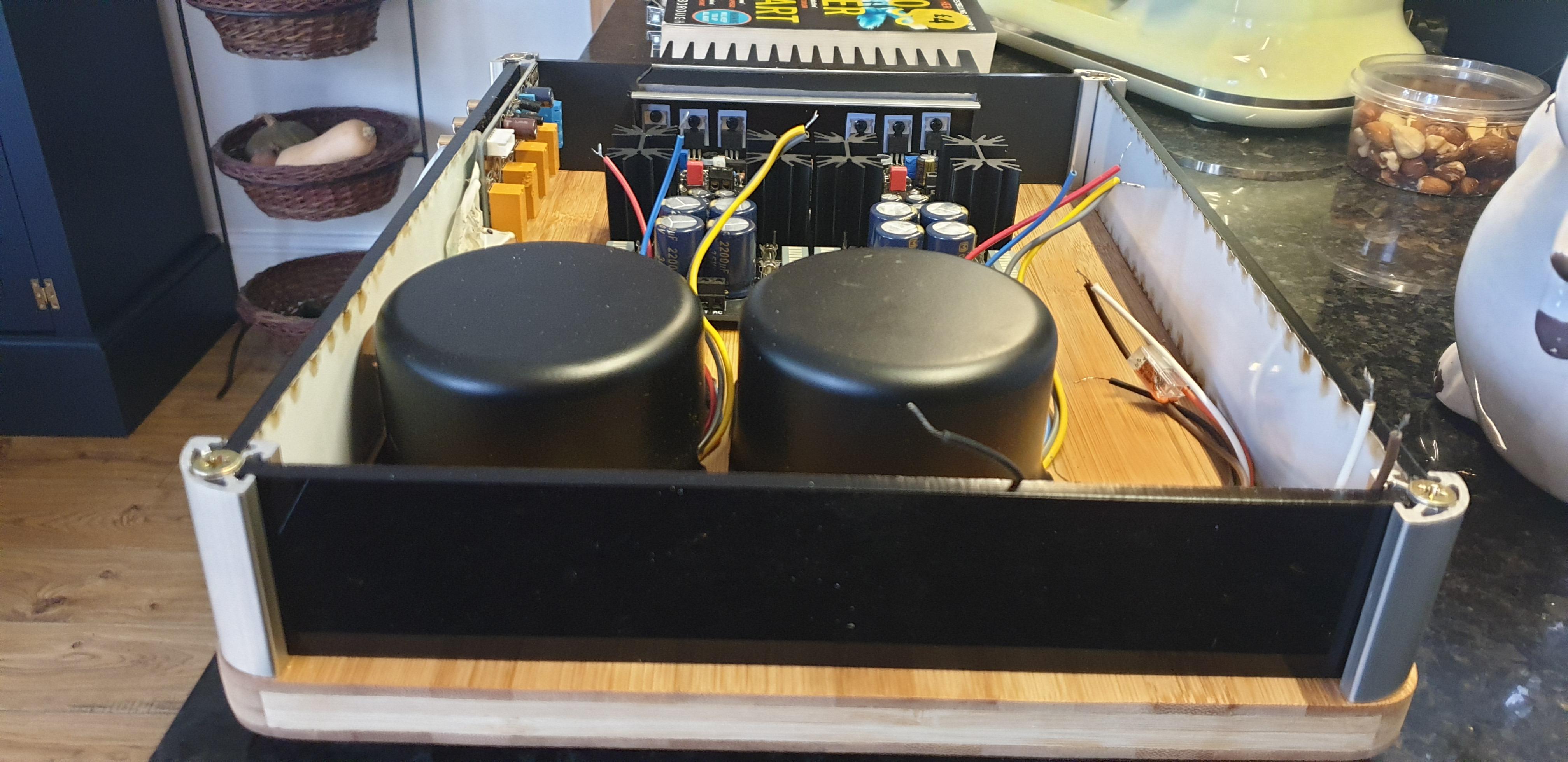

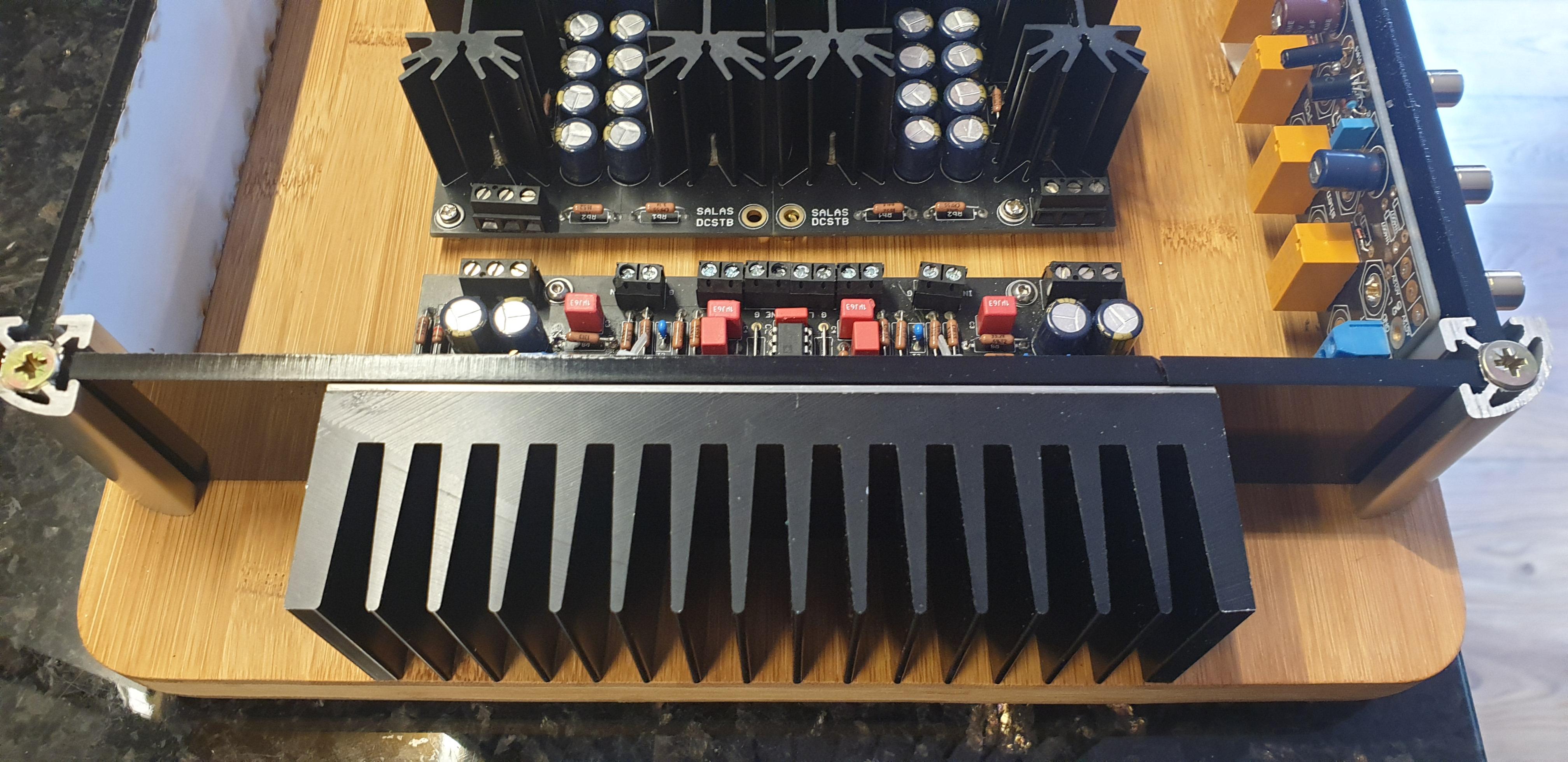

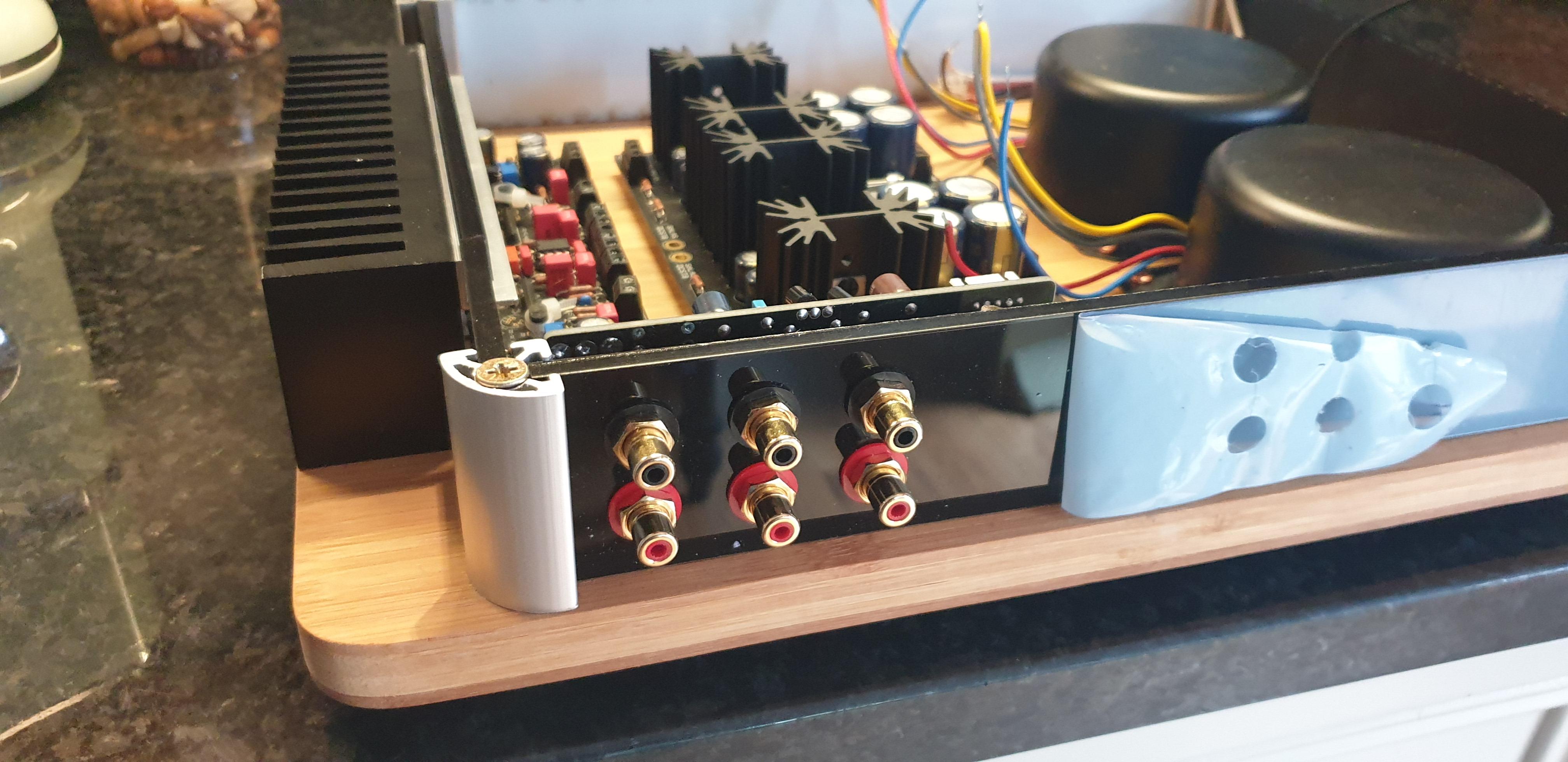

Finally getting mine sorted in a proper chassis.
Thick bamboo chopping block for a base and then some extruded aluminium and gloss black acrylic. Hope it looks nice when finished.
More work to do but I'm getting there!
Ok, thanks! Will come back later. Up to now I just measured loaded as a preamp.Those are otherwise good 1kHz plots. To start with measurements compatibility, load it with rather low impedance headphones also and measure at 400mV RMS across various frequencies.
Ernst
