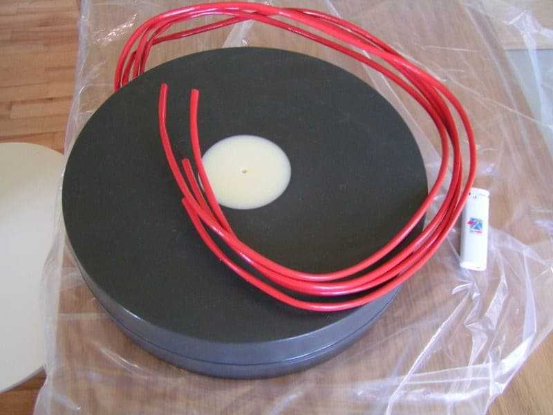

If you get a custom made choke for the MoFo what would the specification be for such a choke? if we go for the high bias version 2.5A. Would this be a choke that can handle at least 3A DC, 50 mH and then as low DC resistance as possible? ...is there any requirements for the DC resistance?

Well my transformer is a bit different since I have voltages gain in my design. I use a 350-400VA double C-core transformer, the induction is 10mH/80mH with a total dc resistance of less that 0.15 Ohm. This means that if one can tolerate a DC offset that is about 150-200mV, you can leave out the output capacitor.
Also, you should se how the induction is over the frequency range, mine work as a perfect inductor to about 14 KHz.

Interesting with the possibility to not use an output capacitor. How low could the value for the inductor be? it would hurt the low frequencies if it is too low I guess. So a 50 mH that has 1 mOhm DC resistance and can work to 20 kHz and handle up to 3A would be nice. Then there will be 2-3 mV DC at the output. I could live with that. It may require a lot of iron and thick cupper wire.
It was also my concern. A 100 kg choke is out of the question. Will check what the possibilities are. Even silver won't make a significant difference. I would nok like more than about 50 mV DC at the output.
proper chokes (OK, it is split load , so Donut is possible) - Donut a' la overkill - Solid State - diyAudio.rs

If you can live with 50mV offset @ 2.5 amp’s you need a choke with a DC resistance of 0.02 ohm, that is total durable.

Think I did something "crazy". Ordered a pair of chokes at the local "transformer pusher". I asked what was possible below 25 kg (50 mH, 3A DC, 20 kHz). I got these options:
Type str. EI 120/60 50mH, 50 mOhm weight 5,5 Kg
Type str. EI 150/50 50mH, 30 mOhm weight 7,7 Kg
Type str. EI 180/60 50mH, 16 mOhm weight 14 Kg
Type str. EI 180/92 50mH, 8 mOhm weight 20 Kg
I went for the big one…….then I will have 20 mV DC at 2.5A bias. This should be OK without output capacitor. Think it could be a fun project during the Autumn. I asked once again to have confirmed that the choke works at 20 kHz. They makes fine output transformers so I think they know what they are doing.
