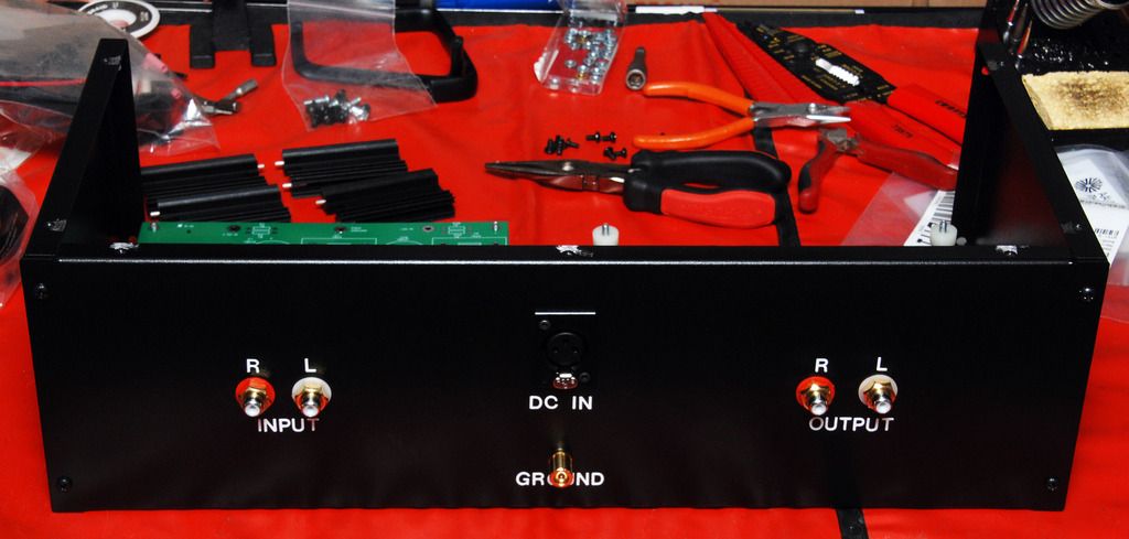

Finally had some free time since finishing the power supply so I did all the cutouts for the Pearl case.
[/URL][/IMG]
The little platform is so I can always make changes or replace parts on the boards without having to remove them. I'll mount both boards and build them as time permits right in the case. I can just remove the top & bottom covers to work on the boards. I have most of the parts and hope to get started stuffing the boards this weekend.

What a GREAT idea - wish I thought of that 15 years ago 🙂I can just remove the top & bottom covers to work on the boards.
I also recommend following Jack's advice of using the female sockets in various places for easy swapping of parts.
Thanks Eric & Jack.
I started stuffing the boards over the weekend. 1st thing I installed were a few sockets for cartridge loading at C15 & R20.
I always hated having to remove boards and start removing wires to make changes or repairs so I started building everything like this with the platform. The only disadvantage is the case needs to be a little deeper. But I find it worth the trade off. If your good with metal, you could make the platform out of steel to keep it really thin and still be strong. I'm not so good with metal, so I use wood. I did have one platform made for me out of steel years ago and it's really nice. But it's a lot less expensive for me to make one out of wood and the deeper case is under $10 extra.
