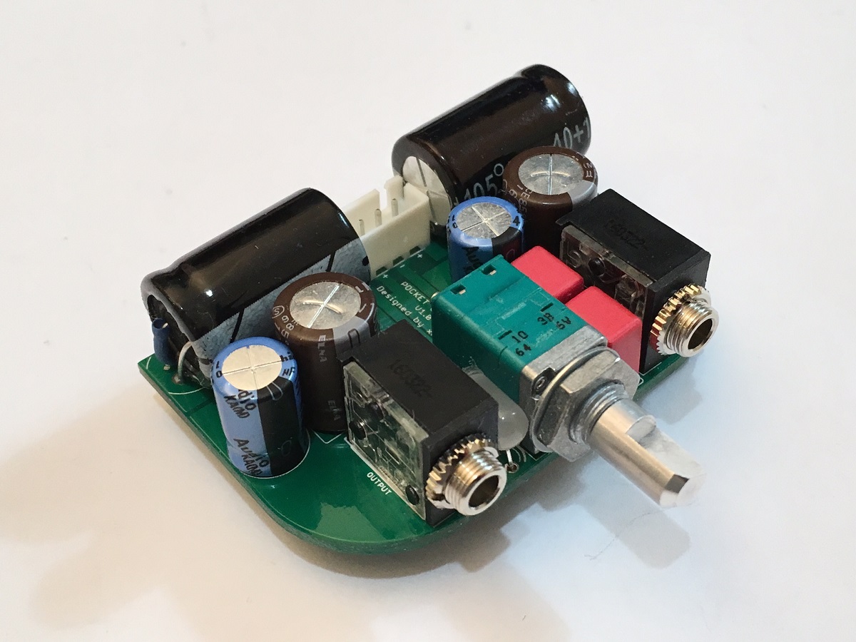

Please forgive me for not stuffing my amp into a tin. Got the PCB and perfectly matched FETs as a gift from X - thank you once again X! Just made a simple perspex enclosure to be used as a desktop amp.
For the rail caps I used Panasonic 2200uF. Panasonic FM 470uF for output caps. All the bypass film caps are low cost unknown brands - could not get those red ones locally, and waiting for the results of Stellar's cap rolling adventure. 😉
Incredible that such a tiny (compared to my tube) amp sounds so huge! Amazing sound. I cannot believe I have a Class A HA amp that cost me only about $30.

Great work! Doesn't need to go into a mint tin - if desktop case works for you that's awesome.
Nice home brew regulated PSU.
The clear case looks awesome. Great for showing off your handiwork! I had a clear-shelled land line telephone in my room as a kid--I found it fascinating. I kinda wish all electronics were see-through...
Cool green caps, stellarelephant! Interested to hear your results with you new bunch of caps.

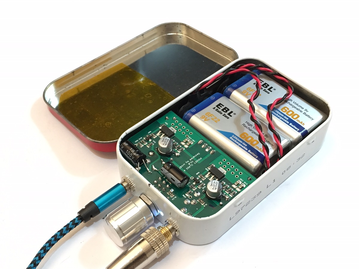

So I just built my "Daily Listener" amp using a set of rather hot running FETs with 62mA bias. I installed 470uF 16v Nichicon AK's and 100uF 16v Elna Silmic II's and RVF 47uF 25v SMT caps on the SMT side. No film bypass caps on output! Relying on the Silmics to carry me through the mids an treble as StellarElephant suggests.

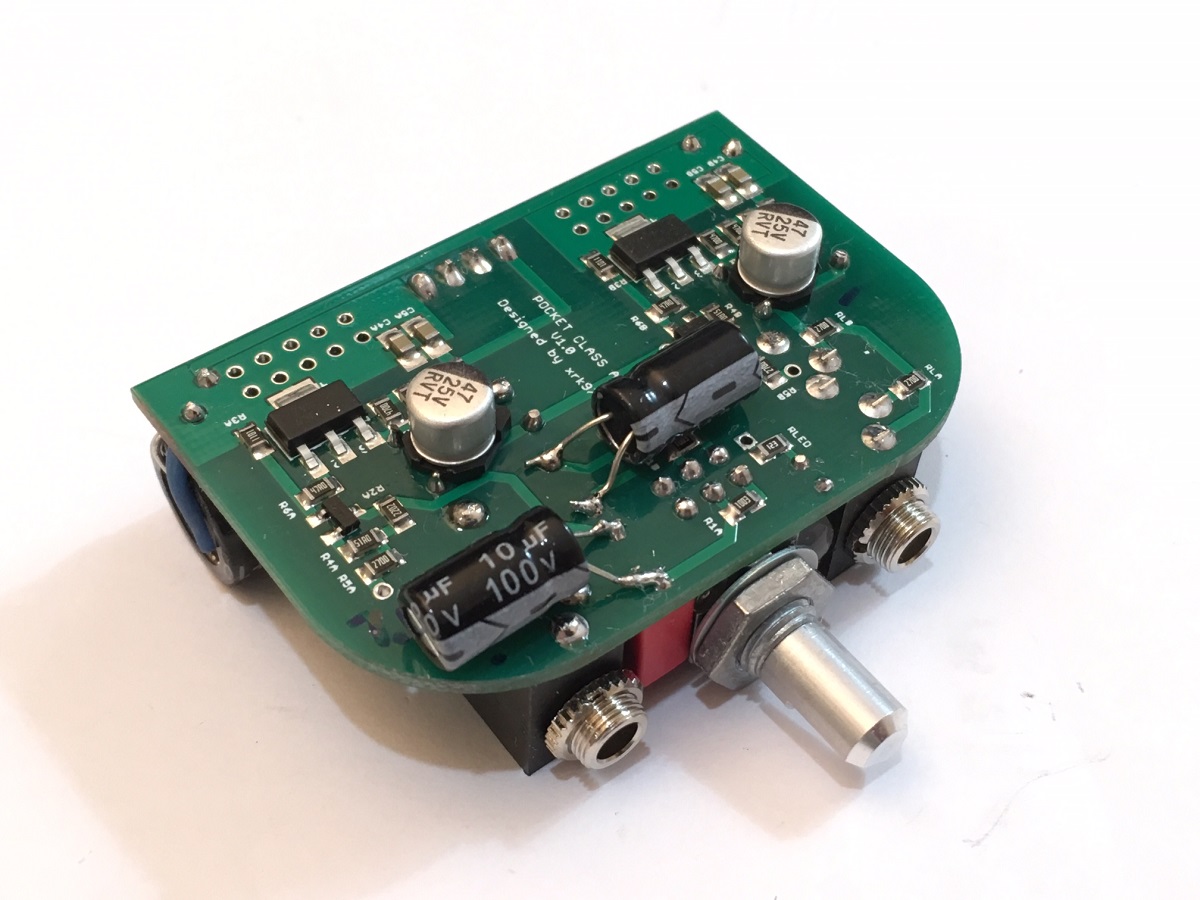

On input, I am using the usual 2.2uF Wima films but now with some no name brand 10uF 100v electrolytic soldered onto the SMT side. They just barely fit under the lid. I am using rather beefy 2200uF 25v no name power rail caps.

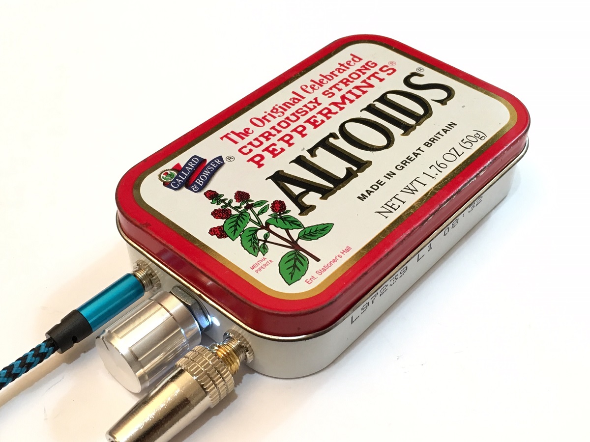

The finishing touch is a 5mm WHITE LED for the power-on indicator. I had to sand down the LED to get it to fit in a 3mm LED space in between the pot body and 3.5mm jack housing. Finally, I happened to find in my fly fishing tackle bag (took my son fishing yesterday) an old Altoids tin that I used to keep flies in. It is painted white on the bottom half and says "Made in Britain". I guess Altoids used to be made in Britain?!
Anyhow, the case looks totally retro and the white LED is a nice touch. The sound is wonderful. I immediately hear the nice sound I was missing with the A5. It is immediately apparent - and I kick myself for not building another daily listener sooner after all my amps were gone.

hey the white altoids tin looks pretty cool, should hang onto this one 😉
