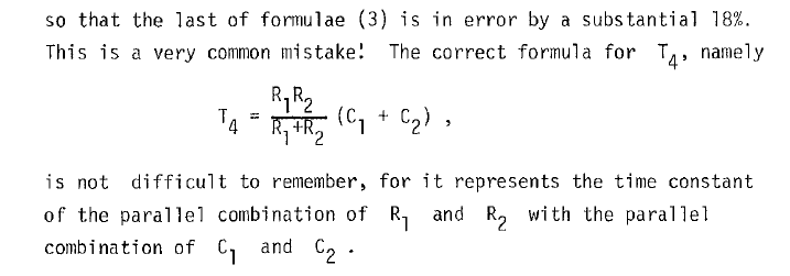

http://www.pearl-hifi.com/06_Lit_Ar...s/Lipschitz_Stanley/Lipshitz_on_RIAA_JAES.pdf

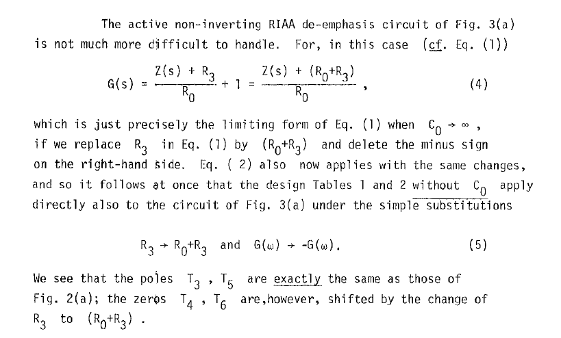

Attached below are the three handwritten sheets in which I derived the equations for the 3 main RIAA time constants (3180usec, 318 usec, 75usec) in less than 8 minutes.In ten minutes? Do me a favour.
For a sanity check I plugged in the component values from the first two RIAA circuits in SSAD 2nd edition, and found that the "318 usec" timeconstants did not match. So I downloaded a copy of Lipschitz's typewritten manuscript from the web: (title page attached). It may be that the component values in the book were computed from the Lipschitz's first mention of "T4"
rather than the correct formula for the noninverting amplifier topology that he presents afterwards. (My derivation on yellow paper matches this formula)
I installed the yellow-paper equations into an existing numerical optimizer program written in C, and ran it to calculate the optimum component values to match the RIAA timeconstants 3180us, 318us, 75us. They are shown in the tables below. Notice that the TC (time constant) values in the 3rd column are closer to the RIAA ideal than the TC values in the 2nd column.

For those fiddling around with RIAA software, I offer this teeny factoid that might make your programming a wee bit easier:
RIAA gain at 1.000 kHz is / should be exactly 19.9110 decibels less than the extrapolated gain at DC: (R1+R2+R3)/R3.
If, like Douglas Self, you prefer to compute component values which give precisely XXX decibels of gain at 1 kilohertz, this above factoid immediately becomes what optimization software calls an "equality constraint"
- (R1+R2+R3)/R3 ==exactly equals== [(XXX decibels) + 19.9110 decibels]
