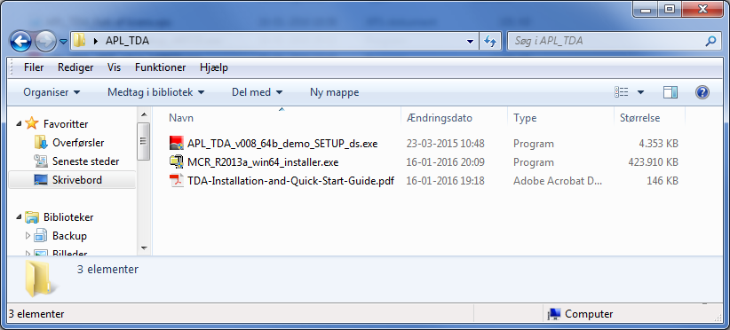

Hi Stefanoo
Cool you will try it out, software is made for pros with good acoustics and audio understanding so help is few and license cost for pros is steep seen with diy eyes but should you end like to have full functions updated version Raimonds Skuruls offered us at diyA license on par student costs over at this diyA thread http://www.diyaudio.com/forums/full...eaker-correction-networks-27.html#post4583863 .
Can i help regarding installation you need three files as seen below, install Matlab Compiler Runtime and install APL_TDA demo.
1. If your Windows OS is 64bit download either 32 or 62 bit version of Matlab Compiler Runtime and APL_TDA and if Windows is 32bit get 32bit version of those two installers.
2. Rightclick Matlab Compiler Runtime and pick run as administrator and follow setup instructions.
3. Rightclick APL_TDA demo and pick run as administrator and follow setup instructions.
4. Go into folder you installed APL_TDA and find the programs exe file then rightclick it and run as administrator should get you going, only thing left before a sweep is adjust sound card settings up in left corner. Although important detail to avoid samplerate mismatch distortion is in Windows sound control panel go adjust sound cards input and output to lock at either 48 or 96kHz that is the two numbers supported into APL_TDA settings too.
Should you like i can share these three files via OneDrive on request.

Byrtt,
thank you very much for your detailed post. Let me ask you:
what is the advantage of using this SW instead of REW?
REW is a proven free tool that doesn't require many other SW to be installed and it's widely used around the net and I am sure it can do all the basic measurements required to analyze room interaction.
Will this other tool offer a different set of measurements the other doesn't?
Look at these two plots,
And:
While looking similar, their function is not the same. Nor is the amount of info you can extract from it. Both have their own purpose to give information to it's user. I use both for different reasons. If I had to choose? It would be APL_TDA.
The Demo only requires one extra piece of software installed beside it's own installation. The other (third) file is a pdf. Even REW uses something else, it does use Java.
If you really want to see if all the hard work done to the room paid off, APL_TDA can tell you a lot. Pretty much the same info can be gained from REW, but it takes a lot of interpretation and shuffling trough tabs. Here you get a visual representation of that interpreted data. None of REW's outputs can give it to you this clear.
ok you convinced me and thanks for your explanation. I will install the APL_TDA tool today.
What is the difference between free and license version and how much is the license version cost?
