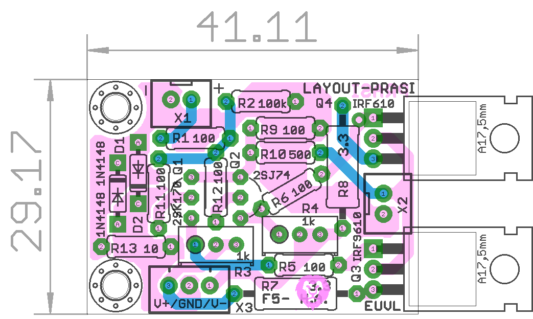

I am looking for a way to shrink that PSU board on the left. Each of those is a 2200uF cap and to get the low level (sub 1mV ripple) filtering I need, I need lots of milliFarads.
This is an F5 class A headamp - sounds wonderful. Sorry, not class D, but let met tell you this: it sounds better than any head amp I have ever heard. Absolutely silent, no distortion, dynamic, clear and detailed. 🙂
http://www.diyaudio.com/forums/pass-labs/271926-f5-headamp-80.html
Btw, anyone interested in making this, you can veroboard it easily enough (4 transistors and a few resistors), or use the new PCB layout from Prasi:
