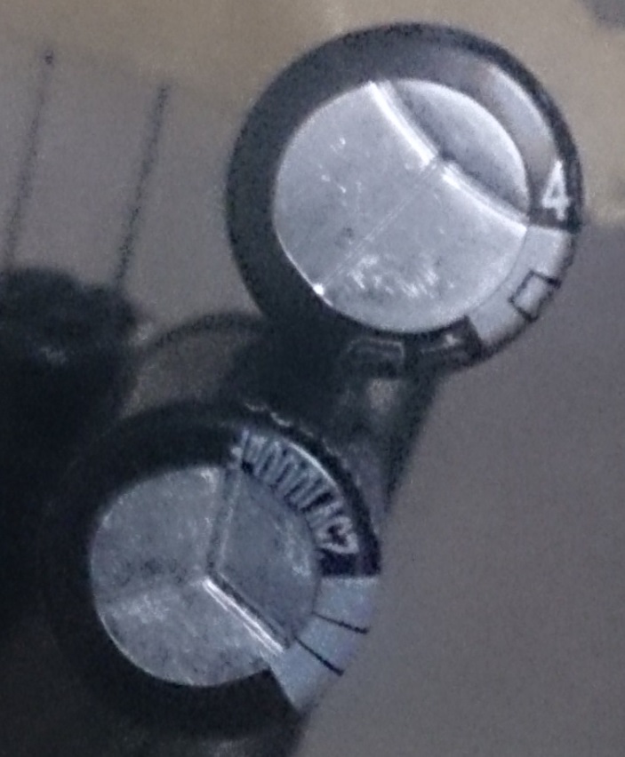

Irribeo our long time supplier in Singapore (not China) claims they are Panasonic .
http://www.mouser.com/ds/2/315/ABA0000C1021-947569.pdf
https://www.amazon.fr/condensateur-chimique-EEUFR1V471L-PANASONIC-heures/dp/B00AZKYUL0
Curious why you claim the "100% certain" by looking at the brochure ?
The Volt(+) marketing brochures box the two electrolytics and label them Panasonic. The electrolytics in the marketing brochures that are labelled Panasonic are 100% certain NOT Panasonic.

If that supplier was Mouser you should send your brochure and Mouser invoice to Panasonic, Digikey might be thankfull

We are measuring the ESR of the capacitor in the image against one Panasonic that was bought from digikey/mouser..should have an answer soon.
