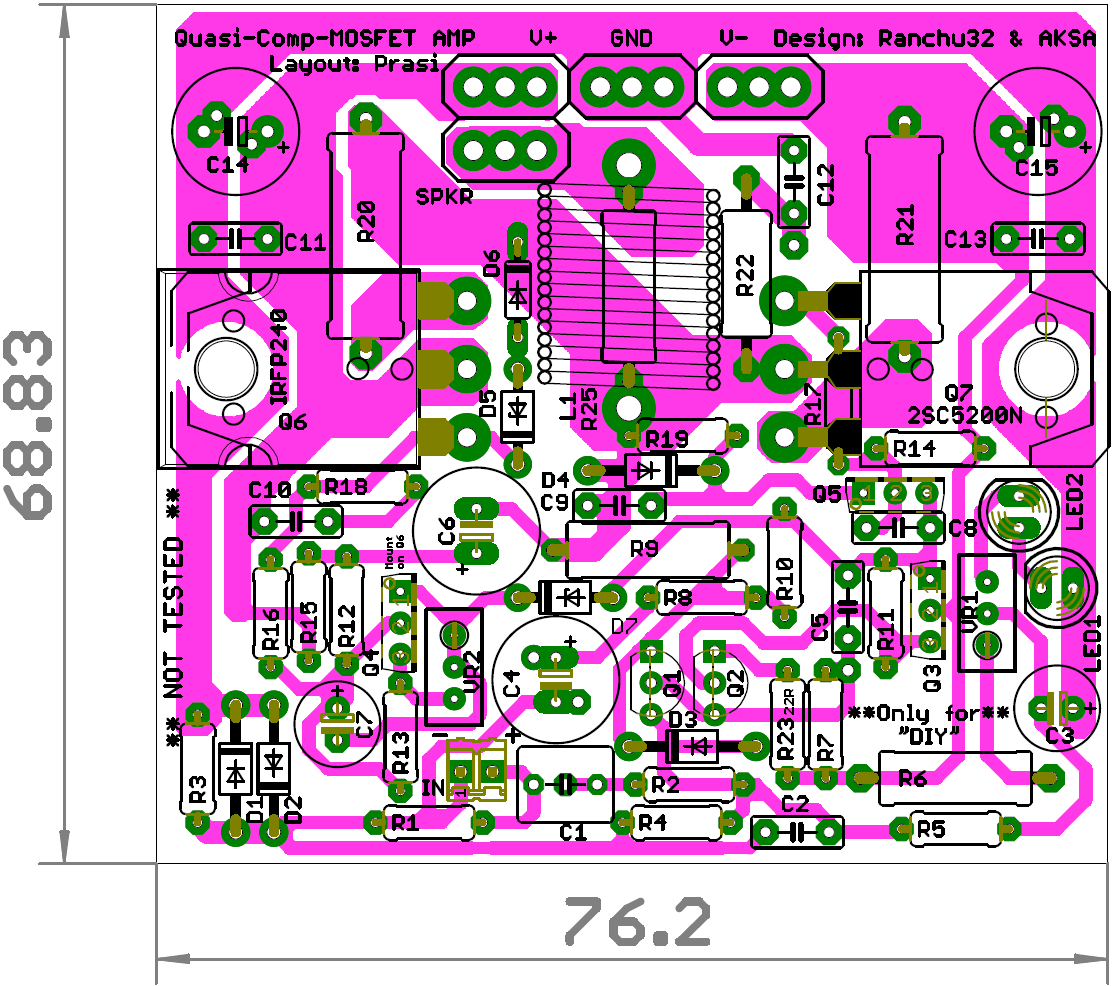

Dacz- same thought like X, nice board and all values are printed to part- nice.
There was any debate about R20/21- it is more safe way to use 0,33R- best compromise-

2N5401/2N5551 from prasi rev2
Hi, Thats a very nice layout. 2n5401/5551 are not from my layout. they were added later as per suggestion by AKSA for XRK. xrk twisted the legs to use them on his PCB. I havent yet revised the layout to include them+other changes as per AKSA's recent sch.

X, if you get time, can you take the excel i posted, enter your values +schema link+layout link and re-post here for convenience of others? same request for Terry also for his second build if completed.

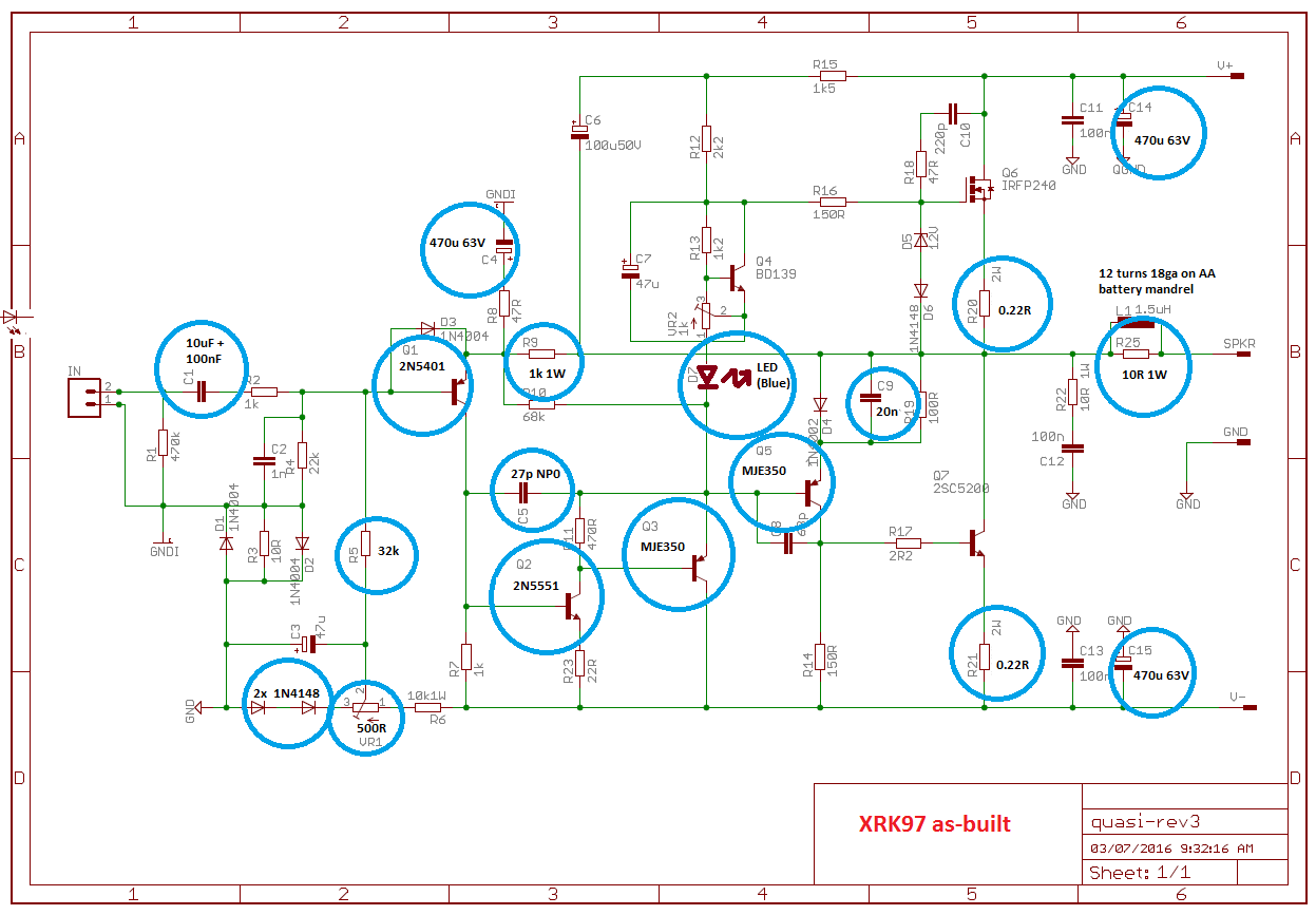

Here is my schematic as-built, many of the substitutions were simply result of using what I have on hand. The key functional substitutions are:
blue LED, 2x 2N4148's, R9=1k 1W, R5=33k (32k as built). The capacitors were simply use of what I had on hand.

can please verify electrolytics voltages?
If you are using +-42V rails you should be fine with 50V caps. You don't have the blue LED connected right. It should connect to the same place as Zener but reversed.

You have set R7 at 680R and this is in error. It has been usually set at 10R, but in fact someone here, maybe Terry?, who discussed it should be zero, that is, leave it out altogether. C4 has also been addressed by Thiago, who felt the bass was superior with 1000uF rather than 470uF. From the design POV, deleting R7 increases the loop gain of the amp by quite a margin, but the global feedback is set by the ratio of R10 and R9, 68k/1k8, which defines the global negative feedback as 37.7, which around 31dB.
You describe Q5 as the phase inverter; moving left to right, it's actually a VAS buffer transistor (impedance device) and might be redesignated as Q3; and your Q5 is a phase inverter and might be designated Q5.
Otherwise, your drafting is very clear and well done!

Error: alternative (to the Zener) blue LED on your diagram is connected to the output, instead of Q4 emitter.
