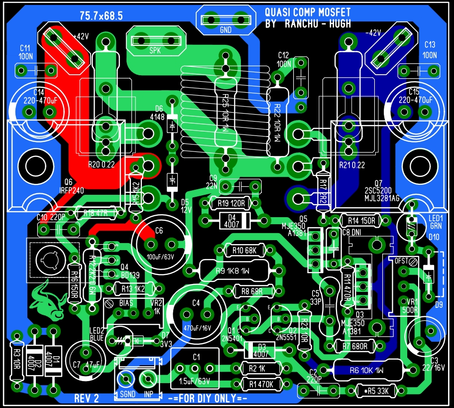

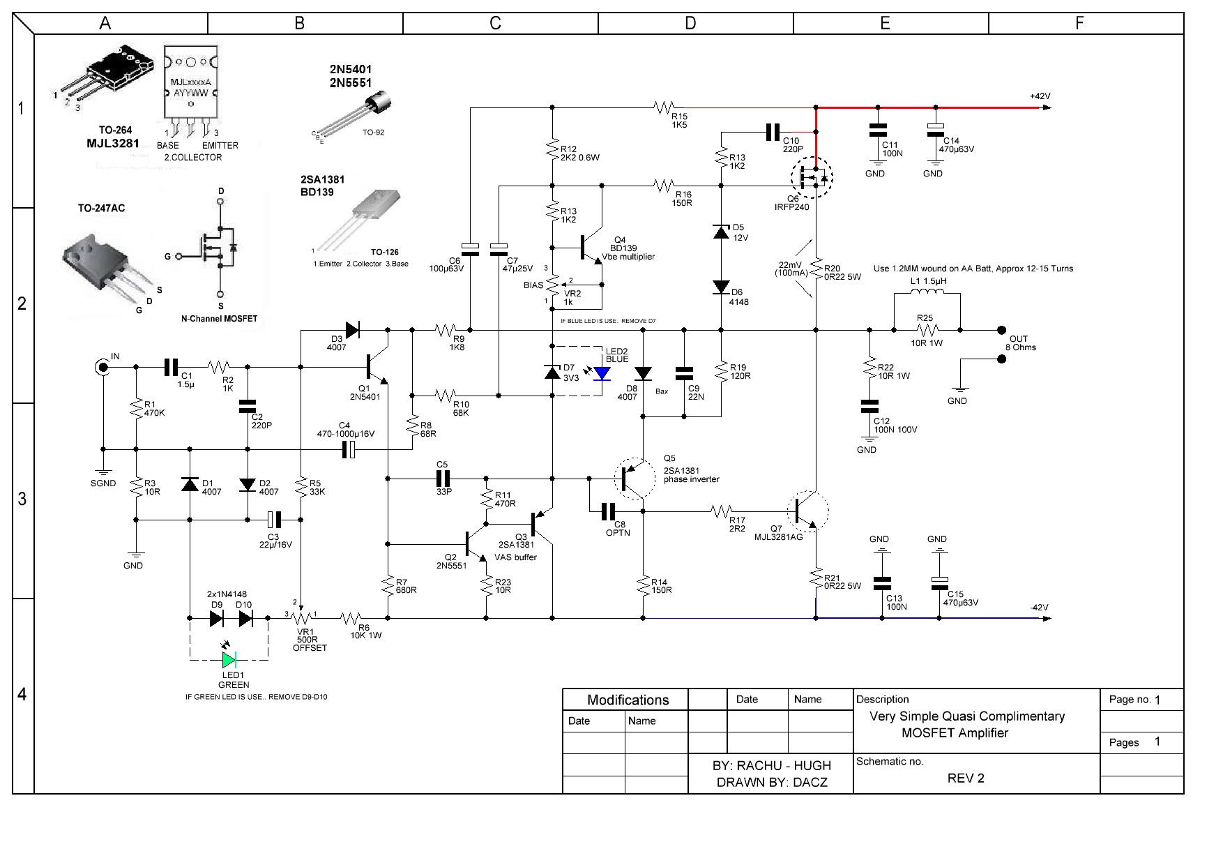

Very simple quasi complimentary MOSFET amplifier
thanks hugh, terry & minek123 for the correction, much appreciated.

No, Ashok, the drive will be sufficient even though the 250 has 230W rating compared to the 240 which is around 150W. The 240 has Rdson of 0.18R, current of 12A cont and 39nC gate charge, while the 250 has 0.085R, 19A cont and 74nC gate charge. This charge is with respect drain, which sits at AC ground since it is a rail supply. This hikes up and down under drive of the gate circuitry, and 74nC is pretty small as long as the voltage amp drive is around 8mA or more. These gate charges are significant at 1MHz, but not important up to 20KHz. We are not fruit bats, so we hear it very well......
The Rdson is important, however. 85 milliohms is a lot less than 180milliohms, and it will improve the damping factor. Effectively it would make the amp sound rather larger, the scale would be bigger, since is can move the speaker a little more easily. These are subjective comments; you may not like them! But if you increase the nmos, will you also increase the npn, maybe to a LAPT transistor like the Sanken? Then you can increase the rail voltages, maybe to 50-60V, no?

hi Hugh .
R20 and R21 is the value that influences the damping factor ?
0R47 will give less damping factor ?
I would like to test with less damping factor ...
Regards
Thiago
Hi Thiago,
Yes, actually correct, but the Rdson adds to the source resistor on the mosfet, then is divided by the feedback factor. So, for the IRFP240, (0.18 + 0.33)/38 = 0.013R. This is theoretically, using simple math, but in reality the AC conditions are a little different and you would expect to have a Zout around 80 milliohms or so, which is a DF of 100. And of course this figure varies with frequency and output level. Be careful; too much DF gives huge control over bass and some people do not like the sound because the decay of notes is badly affected. I try to shoot for 50 or LESS 🙁

Thank you Hugh .
I played with ACA Nelson Pass and I like low DF and bass more " loose "
I'll try 0R47 and see the result .

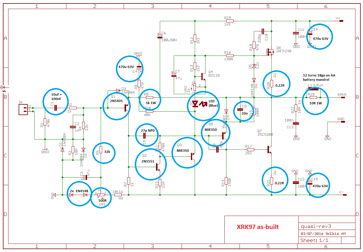

Hi guys,
As this post is progressing, can you (the designers) conclude that the design is a go or is it still being tuned with some expected value changes..?
XRK send us his as-built schematic and earlier Bangla H provided us a quick BOM. I used Bangla's BOM and created a simple Word file with an added colomn for the XRK as built values. There is also a third colomn which could be the final value and also some recommandation, ex ; Bootstrap cap to be Nichicon KZ, Feedback cap to be Elna Silmic II...you get the point.
Also, what is the recommended rails supply for this amp ? Is there a range ex +/-35 to +/- 42Vdc, also, what is the expected output power so we can properly size the PSU.

Hi Eric,
I have examined this and my thoughts are the a few values could be changed to optimise the harmonic profile based on what people have experimented with and auditioned:
C4 feedback shunt cap 470uF SHOULD BE 1000uF (more bass)
Q2 VAS master 2N5551 SHOULD BE KSA1845 (more bandwidth, higher beta)
Q3 VAS buffer MJE350 SHOULD BE KSA3503 (more bandwidth)
D7 Voltage Reference Blue LED SHOULD BE 3.3 ZENER (better tempco and not bright!)
C9 Bax cap 20nF filmcap SHOULD BE 22nF (20nF is not a npv)
R20/R21 OPS source/emitter resistors 3W wirewound SHOULD BOTH BE 0.33R (extends the conduction angle of Q6 nmos and improves stability of OPS quiescent current)
These are my beliefs for this amp, I will be building this too, and my voltage rails will be 42V, the absolute maximum for IRFP240 and 2SC5200.
If you want more power, up to 62V rails which will give you 200W, I would suggest a FQA40N15 nmos and a 2SC3264 Sanken, 280W and 200W respectively.
Hugh

Eric,
Yes, 125mA to 150mA. It will get hot, so allow plenty of cooling.
