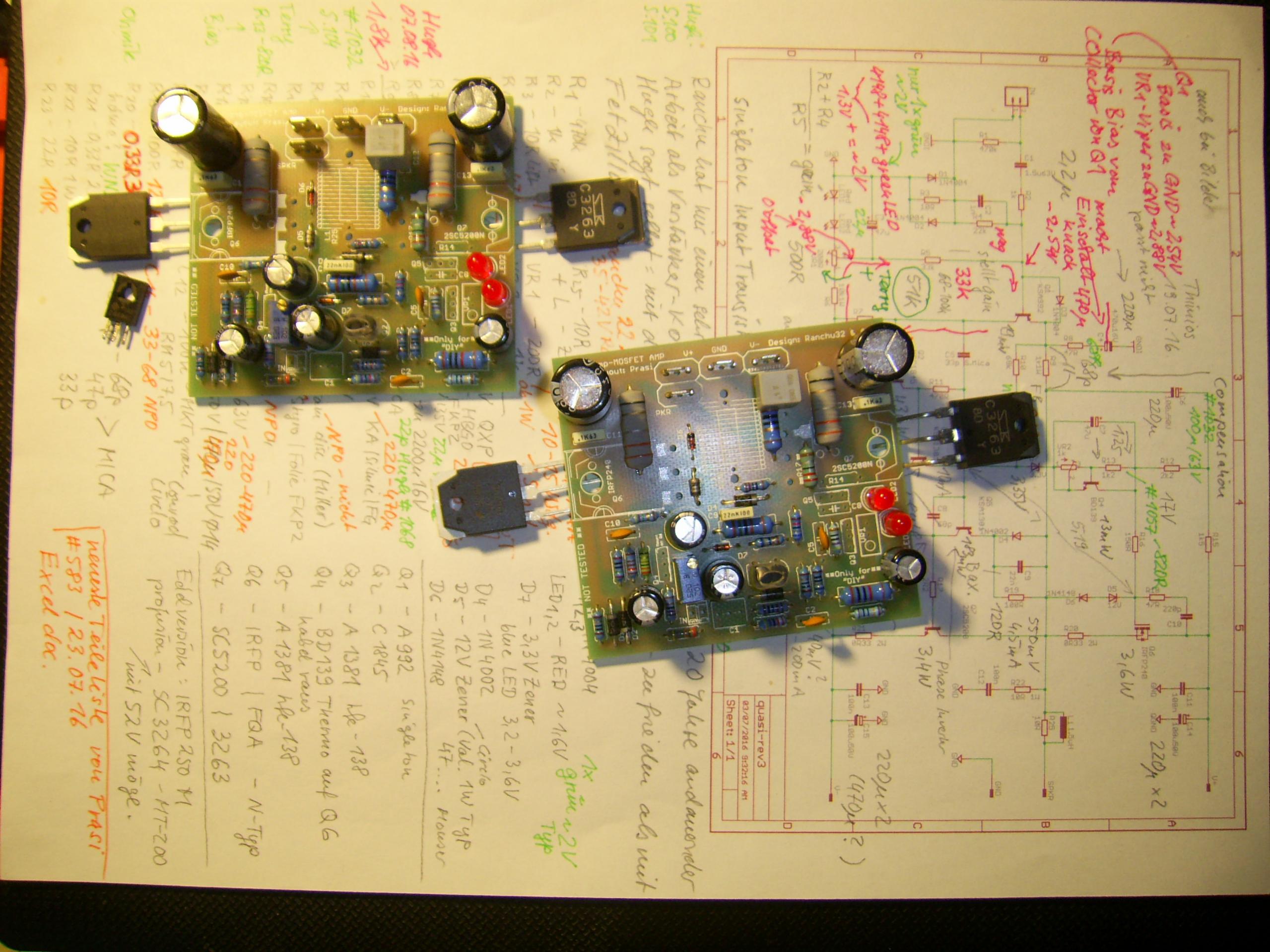

Step Two is done.
Hallo Friends.
Most parts are soldered in now- today.
I have read Hughs lesson about Z-out of Amps.
With experience in listening with a KT88 SE Amp i would say a lower Z-out- is
lower damping to speaker it hath less control to speaker coil- it can longer swing out after impulse- less damped (controlled). I know i like that.
It hath it's own characteristic, difficult to describe- fuller with more background,
fuller natural- if you know how a big drum or organ (komplex) or brass in
real acoustic, without amplifying Technik sounds you can understand the different.
:drink: cheers Bangla.

Hi Hugh,
I played a lot with my Quasi .
Now Q3 and Q5 is 2sa1538 - FT 400mhz - 2.1pF COB
Q2 must be high FT and low COB ?
R20 and R21 is 0R47
I want to go a little more the value of R20 and R21 ... what is the maximum ?
The sound is very good.
A little noise when not connected to the DAC .
Regards
Thiago
Hi Thiago,
I'm lucky enough to own a AKSA 55N, even though this amp normally use 0.47ohm as emittor resistors I have used 1 ohm to great success, it is actually the best sounding amp I own. My powerfull VSSA is now collecting dust in the closet. Looking forward to soon build the Quasi.
BR,
Eric
