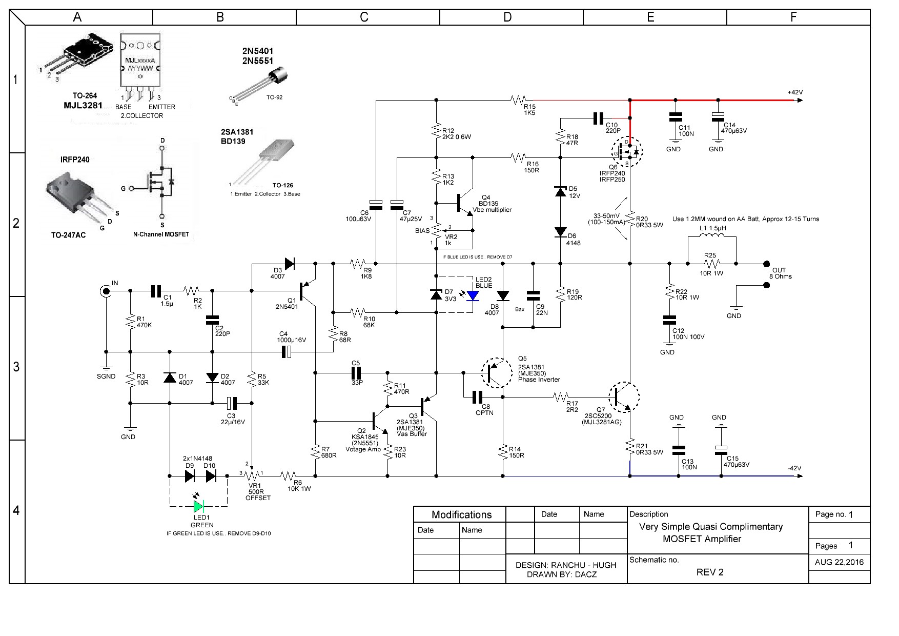

I just installed another brand of IRFP240's in my quasi. Actually did it to test if they were genuine and they are as they work well. Sounds very good and only $0.80 ea. Anyhow, the side benefit is that my previously bottomed out zero DC offset adjustment has improved. I now have range and can get down to zero offset perfectly with room on each side. Somehow the balance between the IRFP and the BJT is different now. ...............
the new range of output offset adjustment will be due to a different Vgs of the mosFET.
mosFETs come off the production line with an enormous range of Vgs (the datasheet shows this). This is very different from the Vbe of BJTs.

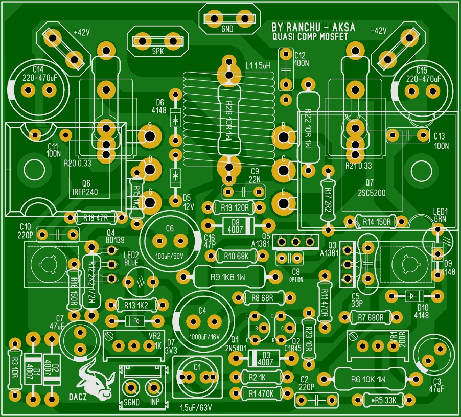

thanks everyone.. here's the corrected REV2 schematic and layout
  • SPRINT.zip
    SPRINT.zip
Hi ASKA. You recommend for +42V the FQA40N15 nmos. It seems very difficult to get. I think you recommended an other NMOS in some of the post?
You mentioned also possibly the IRFP250 instead of the IRFP240. Any suggestion?
Alos in some other post you mentioned the MJL3281AG instead of the Saiken. Again can we used either?
SB
What about IRFP250/MJL4302A or IRFP260/MJL4302A pairs?
Rgds.
Farjon,
This is the original amp with no higher than 42V rails, where the single IRFP and C5200 is just sufficient.
If you want a more powerful amp, say 50V or even more, you need to change the dimensions of the driver stages, both for the nmos AND for the npn. Of course, this is a different beast again, so we need a new thread for that........ and of course, to be sure, we need to build it out and test it thoroughly. To be honest, the best option would be to use a 280W nmos, like FQA40N15, and a matched pair of C5200 OR even a single 200W Sanken 2SC3264.

I can't find a supplier for this FQA40N15
Hi Thimios,
My mistake; FQA40N25 is the designation.
Here are two choices at Digikey:
FDA38N30 - Fairchild Semiconductor MOSFET N-CH 300V TO-3
802 - Immediate 31,950 - Factory Stock
$3.45 85 mOhm @ 19A, 10V 5V @ 250µA 60nC @ 10V 2600pF @ 25V
312W Through Hole TO-3P-3, SC-65-3 TO-3PN
FQA40N25 Fairchild Semi MOSFET N-CH 250V 40A TO-3P
234 - Immediate 8,100 - Factory Stock
$3.28 70 mOhm @ 20A, 10V 5V @ 250µA 110nC @ 10V 4000pF @ 25V
280W Through Hole TO-3P-3, SC-65-3 TO-3PN
The problem with these devices is normally the buy qty; you might buy 25, a tube, to get them so I'd suggest looking around. Essentially you want:
280W rating Min 150V Min 35A cont Rdson Min 120milliohms
Max 5000 pF gate Ciss TO3P through hole Single device buy
Hugh
You bet Dacz! This is a 73A 300V device I believe; this is huge current and voltage rating just check the gate to drain capacitance is no higher than 5nF. If this is too high the mosfet slows at high frequency.
However NP has used a 120A single end IXYS device with local feedback. That's good enough for me.....
