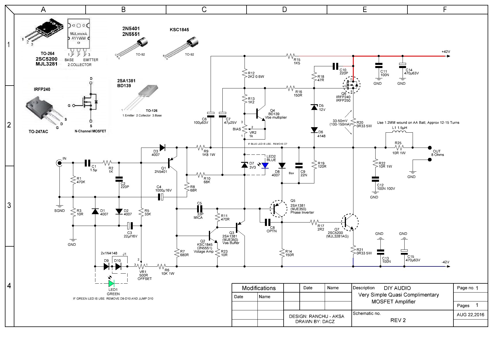

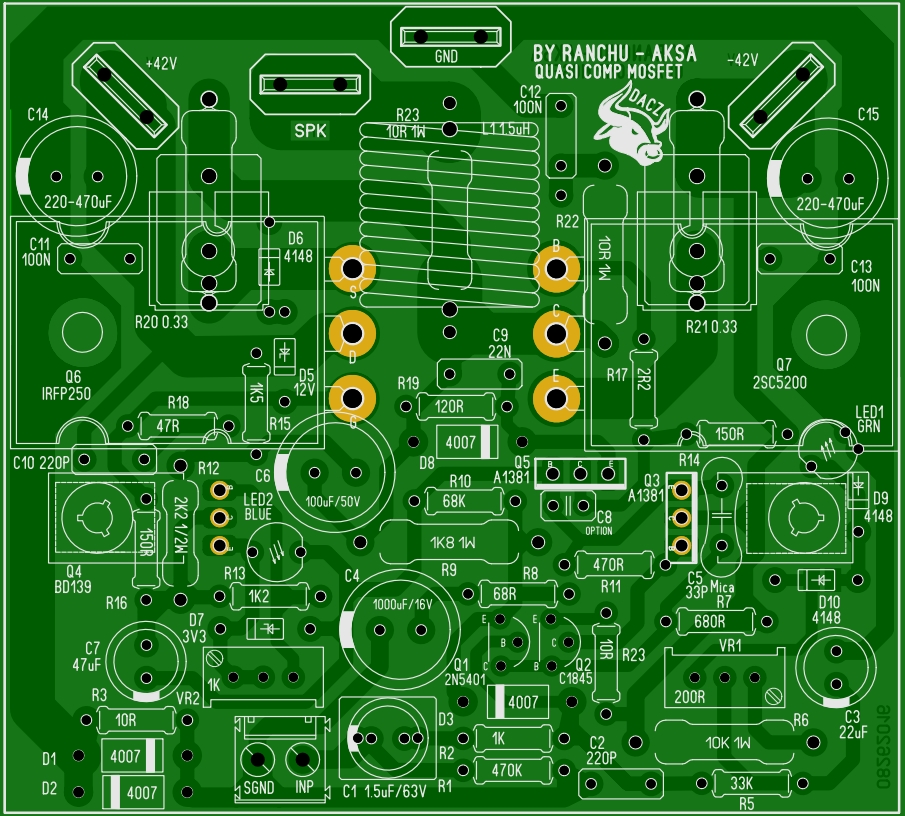

I know I'm quite late to the party but I've just read most of the thread and I'm impressed by the great development work that has been done and by the really informative posts of Hugh, that helped me to better understand many technical issues in this hobby.
Thanks to all, you've helped me to improve my knowledge in audio circuits!
And now my request of further help: I was preparing myself to build the Inverted Circlophone but this VerySimple Quasi could be assembled with not much more effort since I've already got most of components and I could make use of the same power supply, thus letting me taste this little pearl.
Clearly I lack the boards and I'm asking if anyone of you, who has made some sample boards, has got some spare boards and could sell a stereo pair of them to me.
As a second option, I could etch them in boards with a single layer of copper; is available any file of definitive circuit suitable for the etching process? Could anyone of the designers supply it to me?
Many thanks in advance
Nicola
Hi Nicola,
Dacz layout is latest and incorporates all changes that happened over time. So would be good to go, but i am not sure if it has been tested by Dacz/anyone. My layout is from earlier version. Also his schematic is very informative, so easier to understand optional components, pin-outs and set-up voltages... all the best for your build.

Hi Prasi,
thanks for your advice and support.
I've just downloaded the Sprint viewer and I can see I can print the copper layer for etching process.
I'll analyse it deeply before doing it but it would be helpful if Dacz (or anyone who has tested it) can confirm that layout is correct and works.

there is errata in C11, it was shown as copper trace insted of silk. i'll post the latest when i come home
Dacz
Dacz
here is the latest layout and schematic
hi ranchu,hugh,
i have some leftover 2N5416 from previous leach amp build. can i use it in place of Q3 and Q5 vas buffer - phase inverter.

No DAZC,
This is slow; 15MHz and Cob of 15pF.
Even a BD140 would be more suitable.
It is a pity because it is 300V, 1W and 1A. But a large die....
HD
