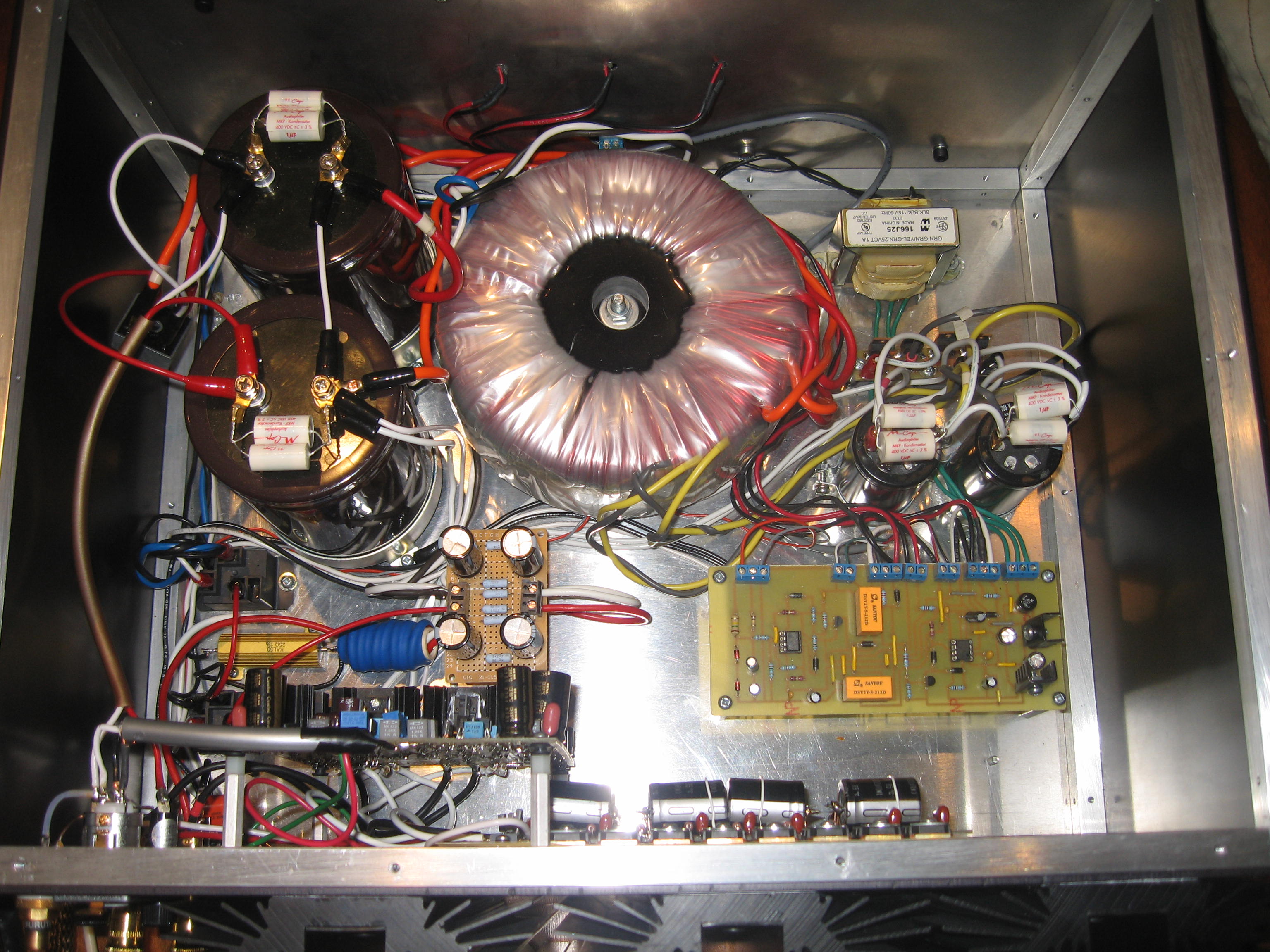

Thanks ASKA for your input, appreciated. I'm not designing the circuit myself, but I'm using a proven circuit. I'm doing the mechanical assembly, and some support PCB. As for the complexity of the design, I built my VSE RTP3C tube preamp all point to point, can't beat that for complexity. It took me two years part time!

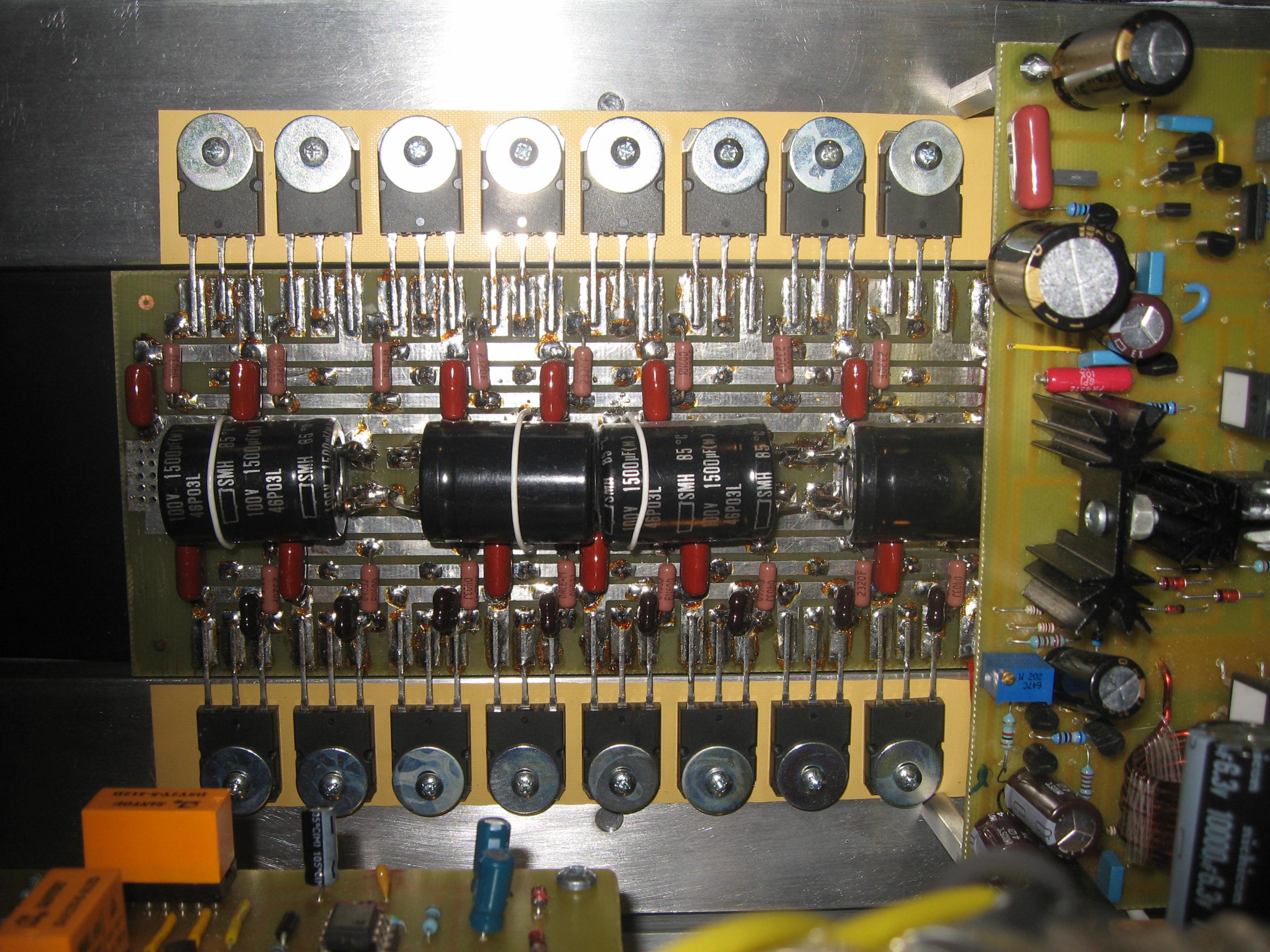

For the record the output stage is using MOSFET, and no source resistor...
I know, I know some think it is foolish to do so but Borbely did it, Goldmund do it to. The amp needs to be well protected, DC offset, current overload, fast over temp ctuoff, fast MOSFET switch disconnect power supplies, etc...
I built a pair of Borbely Millenium monoblock power amps, with 70V rail, 6 pairs of MOSFET output stage, 200W in 8 ohms, 1KVA power transformer, Plitron LoNo. Real beasts, two people lift boat anchor... Included some pictures.
One of my friend has a pair, driving Wilson Audio speakers. They are the best amp we ever heard, power, control, speed, but still delicacy. They are only best by my PassLabs XA30.8 clone, that has more midrange lush, but less control, and way more heat. It is my winter amp 😎
I like complex projects, things to do during the long canadian winter 😉
