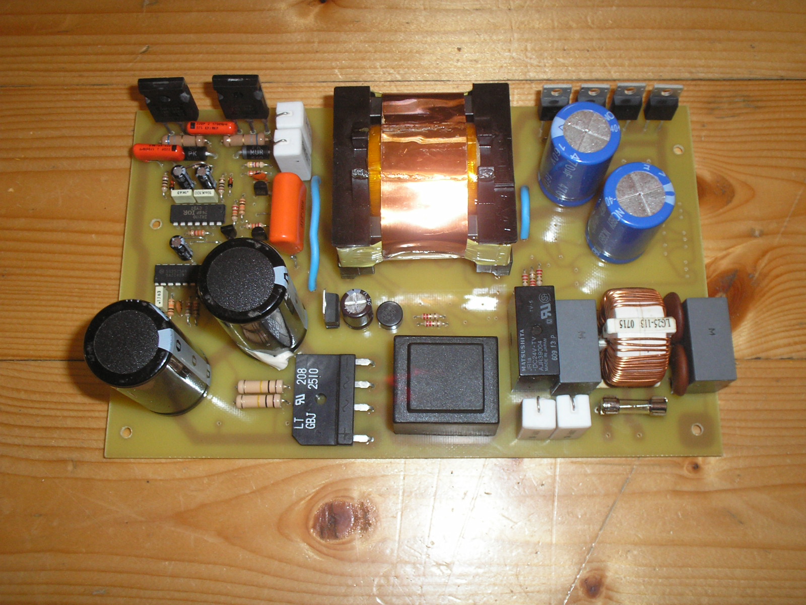

1R or 2R2 can be use, transformer is 2-3W/15vac and I use IRG4PC50U igbt instead IFFP460 mosfet.
Apex SPS-1000 PCB
APEX SPS-1000 Ver.1.1 PCB
Nice work... I made some changes on circuit...
APEX SPS1K v1.2
