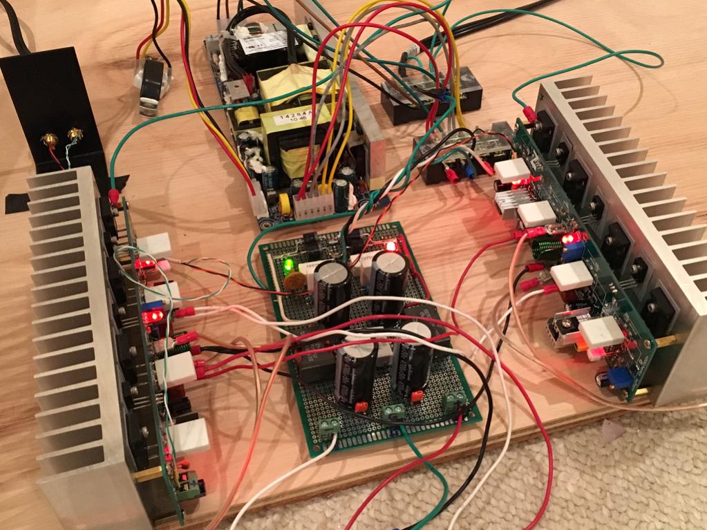

I finally finished the second one and now playing in stereo. I had some problems with the second one due to some cold solder joints. My thanks go out to Valery and Jeff for helping me diagnose and debug the amp.
Sounds fantastic - super bass, smooth and clear mids and sparkling highs.
I need to build a second PSU, right now running both off the same one until some more 4700uF 50v caps come in.
I am running 80mA bias and offset is now 0mV and stable. The matched input LTP's really helps.

In debugging I had to pull off all the power transistors so when reinstalling, I figured I might as well add heatsinks which requires them to sit taller. I will do the same on the first amp now that it's all working.
I just realized that I have an Abletec 450w 53v dual rail SMPS that would be a good match requirements wise. I wonder if this can work? Would "bus pumping" be a problem? And crosstalk from one channel to the other through the SMPS?

I just confirmed that the $25 Abletec 450w 53v SMPS works well with the VHEX+ amp. About 20mV ripple after going through the Dx PSU cap bank and filter (60mV with 250VA trafo).

Using the Abletec SMPS, I swapped out the Dx PSU with my custom CRCLC and I now get only 1mV of ripple! That's 20x better than the last one. There is absolutely no sound from the speakers with ear pressed to the tweeter or woofer. Dead silent, no hiss, no hum, no nothing (well maybe barely audible in the lower than room background noise category)... 😎
That's interesting. Most SMPS that I have tried balk at charging a bank of capacitors. They see them as a short at start up and usually go into fault.
It may be that the R between the first 2 banks provides enough impedance to prevent it from looking like a short.

More 4700uF caps finally came in so I made up a second CRCLC PSU. Now running dual PSU's true dual monoblock operation but single 300VA transformer with 45v rails. Bass on each channel now has even more headroom and ease of play.
