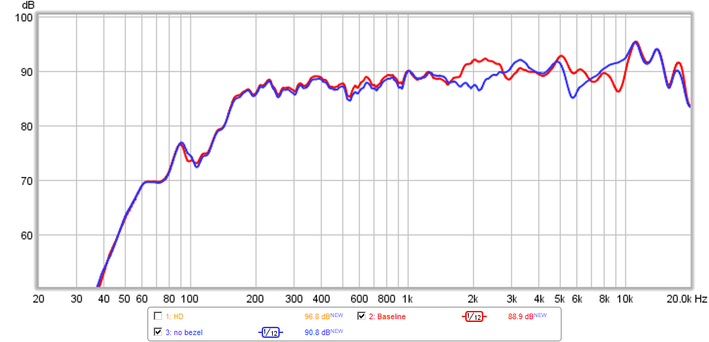

I seem to remember them saying that the Jeep driver was intended to be listened to some degrees off axis 45 or so as it is laid flat relative to the listener and installed in a panel or ceiling space. This would obviously change its performance.
It could well be that it's faulty. A decoupled centre cap would require some precision to align and glue properly. QC can't exactly be amazing in a driver so inexpensive but then again the driver might not be as good they were trying to sell it as being.
Alpines measurements for the driver are quite similar except they don't show that peak/dip combo at 5-6kHz.

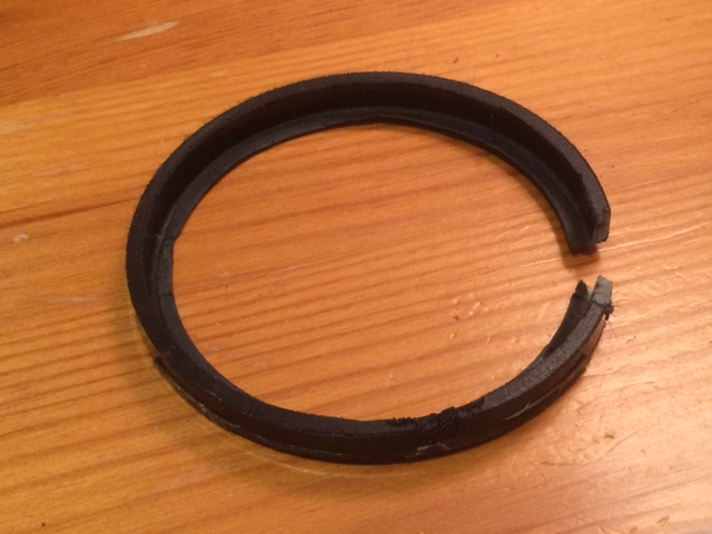

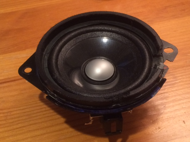

OK, I confess, I removed the bezel on the Alpine driver because I thought it would sound better. You would think that a 0.30in tall x 0.13in thick x 3.10in inside diameter plastic ring placed around a driver would cause all sorts of diffraction anomalies, etc. right? Removing the bezel, reduced a 2.1kHz peak that was very noticeable to my ears and made it sound better, subjectively - less "shouty". However, it shifted a dip that was at 9kHz to 5.5kHz. Subjectively, narrow dips are not as noticeable as peaks. So I made a call and thought the driver sounds better without the stock bezel (which also has a fine fabric mesh grille glued to it). There was no difference with and without the grille cloth.
Here is a comparison of the Alpine with and without the bezel:
Here is a photo of the driver with the bezel placed on top:
Here is a photo of the bezel all by itself. It was glued on and has a paper backing that forms a lip on the bottom where the glue affixes it to the frame:
My question is, would this driver not have done as well if I had left the bezel on? I guess we won't know now that the poll has closed.
So, I guess Wesayso was right - it was broken. But in my mind, broken was better. 😀
Anyhow, I will take the mea culpa for anyone who may have mis-voted based on my tampering with the stock design for the Alpine. Btw, if you left the bezel, mounting it would look kind of funny with a ring there. I guess you could rebate it but that may make it worse.

.....But in my mind, broken was better. 😀....
On plot looks good enough a mod, think would have made signature its own no matter.
