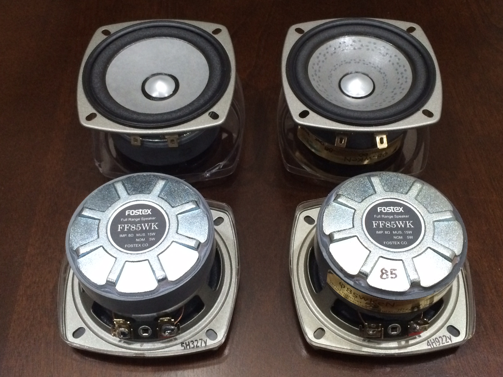

I just received a matched pair of FF85WKeN's that I ordered from Planet10 hifi and coincidentally, a pair of factory fresh non-enabled ones also arrived on the same day. Here they are:
Fostex's are solid heavy well built drivers. The magnets are substantial but the frames are thin. There is some damping putty or aerodynamic shaping putty on the Planet10's.
I look forward to testing these in the next round but at present an still looking for other drivers to include in the lineup. Maybe revisit some of the old ones again. I had considered doing a Vifa/ScanSpeak/Tymphany TC9FD/TG9FD/10F8424/Typ3 and FF85WK/FF85WKeN. That would be 6 drivers there.
Dave usually puts "duct seal" on the frame where it meets the magnet assembly.
