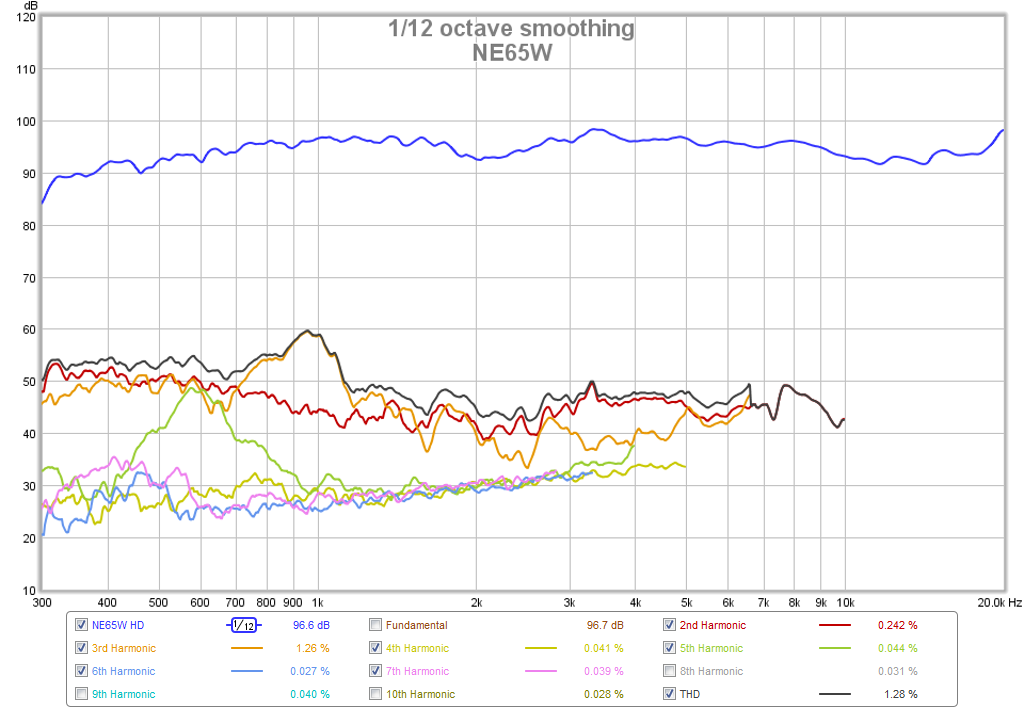

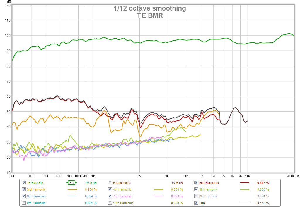

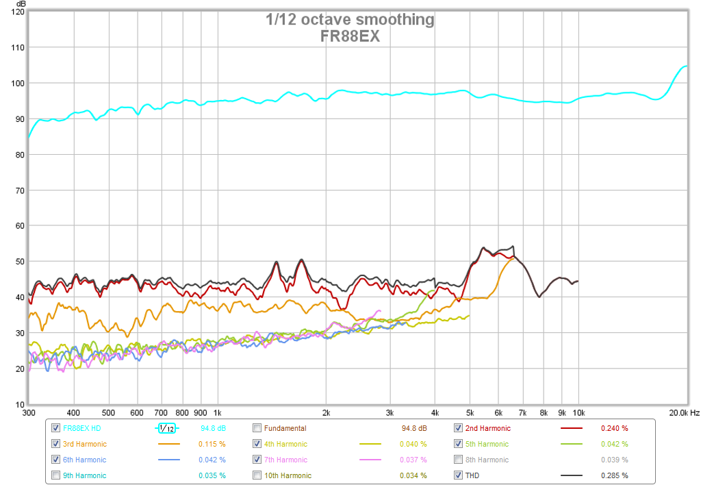

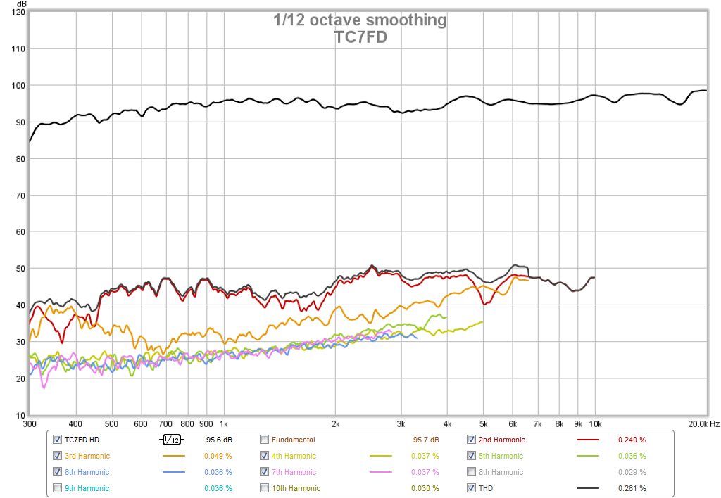

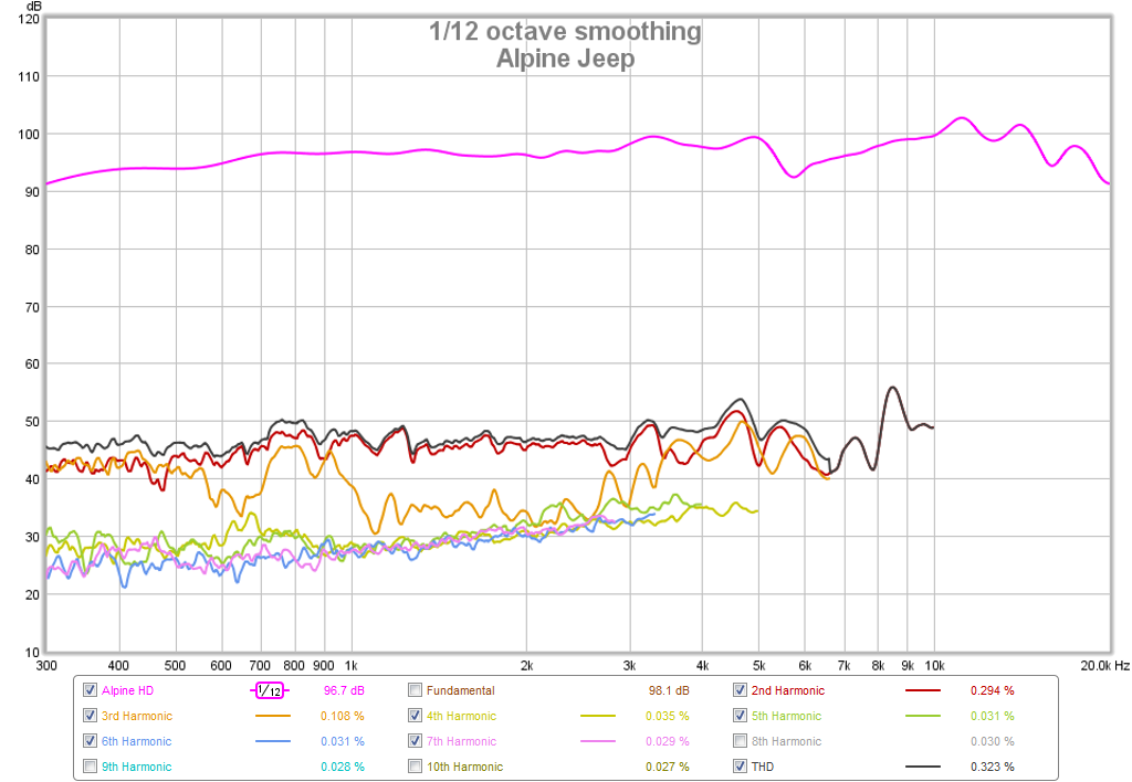

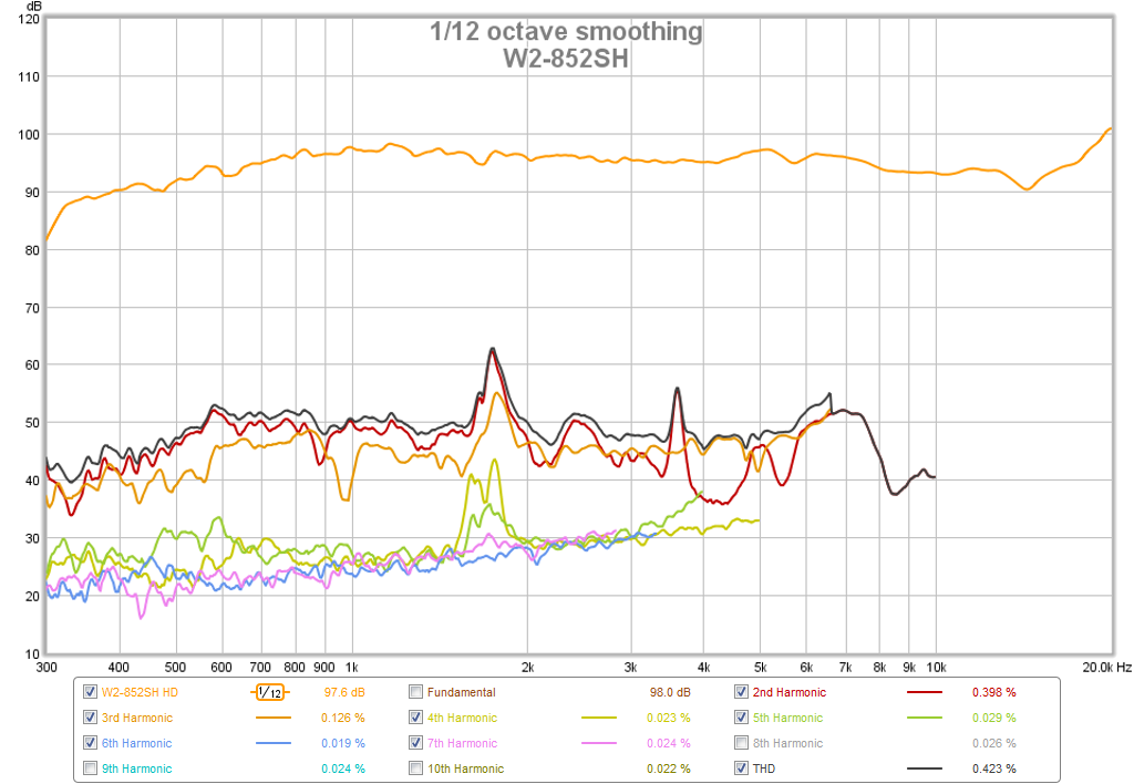

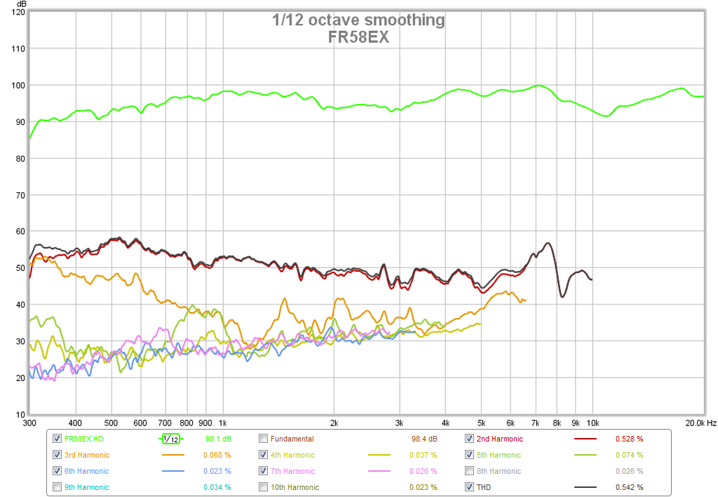

Harmonic Distortion of All Drivers
HD data taken at 0.5m with ~96dB SPL for equivalent to 90dB at 1m. For reference, cursor was placed at 1kHz for HD values shown in the legend. The BMR was quite poor from this regard and the NE65W had an unfortuante bump near 1kHz. FR88EX has a wide bump near 6kHz. W2-852 has a spike at 1.7kHz and another smaller at 3.6kHz. The two leaders appear to be the TC7FD and Alpine in the low distortion department - could this partly be why they fared so well in votes?
Alpine:
TE BMR:
Fountek FR58EX:
Peerless NE65W:
Fountek FR88EX:
Tang Band W2-852SH:
Vifa TC7FD:
Do we have distortion measurements for this round?

Me think if you dsp'd the treble peak, result could have been different. This peak add "detail"....
X thanks plots, did know from comments back in time around FR88EX it have a good HD profile, in round 5 plots low cost TC7FD00-04 also not bad at HD.
Made me have a look at Zaph Audio website and Timothy Feleppa (TMM here diyA) website too, both have nice data FR88EX and TC7FD00-04 listed and if any interested they linked below.
Personally interested in speaker measurement above 20kHz, own a UMM-6 and UMIK-1 provided with calibration files and a ECM8000 without calibration file. Their spec say up to 20kHz and ask can these be calibrated by pro company above 20kHz. UMM-6 and UMIK-1 have USB sound device interface which suppose have stop-band filter at digital fs/2 that exclude them but then analog ECM8000 wired up a 192kHz sound card system. Zaph Audio and Timothy Feleppa show more bandwidth than plots by X, Zaph writes he use ECM8000 calibrated and the cal file includes the mic cable and the speaker cable and Feleppa a EMM-6 provided with an individualised frequency response calibration. Aware of Earthworks M30 and M50 but rather wont like to talk about them because of high cost at hobby level. When looking at www.isemcon.net where from Eldam got a nice new EMX-7150 all example calibration files show what ever they for EMX-7150 or ECM8000 only up to 20kHz, and confuse me when Zaph and Feleppa seems measure HF up quite high.
Links TC7FD00-04:
Zaph Audio frequency response - http://www.zaphaudio.com/temp/Vifa-TC7FD00-04-FR.gif.
Zaph Audio harmonic distortion - http://www.zaphaudio.com/temp/Vifa-TC7FD00-04-HD.gif.
Zaph Audio cumulative spectrum decay - http://www.zaphaudio.com/temp/Vifa-TC7FD00-04-CSD.gif.
Timothy Feleppa frequency response - http://feleppa.com.au/pics/speaker_imgs/plots/TC7_FreqResp.png.
Timothy Feleppa harmonic distortion (RAW) - http://feleppa.com.au/pics/speaker_imgs/plots/TC7_RawHarm.png.
Links FR88EX:
Zaph Audio frequency response - http://www.zaphaudio.com/temp/Fountek-FR88-EX-FR.gif.
Zaph Audio harmonic distortion - http://www.zaphaudio.com/temp/Fountek-FR88-EX-HD.gif.
Zaph Audio cumulative spectrum decay - http://www.zaphaudio.com/temp/Fountek-FR88-EX-CSD.gif.
Timothy Feleppa frequency response - http://feleppa.com.au/pics/speaker_imgs/plots/FR88_FreqResp.png.
Timothy Feleppa harmonic distortion (RAW) - http://feleppa.com.au/pics/speaker_imgs/plots/FR88_RawHarm.png.
Main page Zaph Audio - Zaph|Audio.
Main page Timothy Feleppa - Timothy Feleppa's Pages.

I've been following this thread for awhile and also about BMR
System Overview | Tectonic Audio Labs
(Please read the Feedback Control section)
I'm really curious that perhaps BMR and recording microphone doesn't work well together
What do you guys think?
The BMR is a flat cone. The Tectonic is a DML, exciters on a large panel. Not the same technology.
The Tectonic Audio Labs in the link: System Overview | Tectonic Audio Labs
is a different company than Tectonic Elements Ltd, the manufacturer of the TE BMR driver tested here: http://www.parts-express.com/pedocs...9111X1517312Xf9228fa38c2a5ae8f67f86a4d3ec7a31
The BMR driver here is a flat diaphragm as Perceval said, whereas the other is a distributed mode loudspeaker (DML). There is a DML thread in this forum, btw.
http://www.diyaudio.com/forums/full-range/272576-study-dmls-full-range-speaker.html

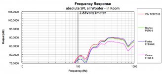

Not the GRS but I will purchase these on my next PE order. I may make a Madisound order too as the holidays are coming... Fostex FF85WK (unless I decide $45 is nuts).
Visaton FRS8-8 3.3" Full-Range Speaker 8 Ohm
I'm using these on OB and the Visaton looks interesting.
Fountek FE85 3" Full Range Speaker Driver
Unless someone convinces me the Fountek 88 is worth the extra cost.
Attached are sims with XBaffle for a few 3" drivers. The Vifa eeks out a db or two before rolling off like the rest.
Eldam, in honor of France I updated my signature but it's not showing. Can anyone tell me why?
