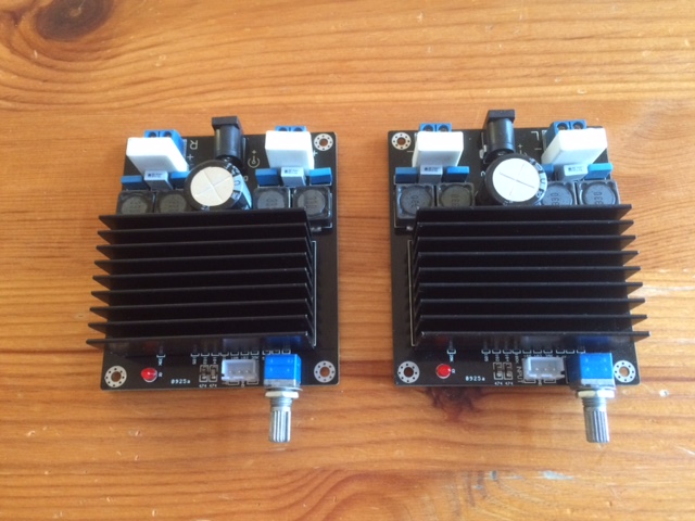

Thought I'd tag this on here rather than start another 7492 thread (hope that's ok).
Just received this board from here:
TDA7492 D Class High Power Digital Amplifier Board 2X50W Amp Board with Radia | eBay
I have it mocked up on this board purely for testing before I go ahead and make a case for it (a good decision as it turns out)....
I am getting audio out both channels (and lots of it) but there is some weird sort of distortion in the upper frequencies, hard to describe but sort of like a ringing?....
I know it's hard to faultfind a sound that you can't hear but just wondering on the off chance somebody might have a suggestion on where to look or if there is anything wrong with the setup here?
The pwr supply is putting out 18.9V (I'll see if I can find another one tomorrow to try and isolate that side of things).
There is ample volume available and I can tell that the amp has got some potential as a good listener but at the moment it's definitely not.

Check the polarity on your speakers. Try flipping one side and see if that HF ringing goes away. I suspect you may be hearing weird phase effects of flipped polarity. Your bass output will also be low. Also try disconnecting one speaker and see if it goes away.
Bypass your volume pot to eliminate that as the source.
Next is swap out those caps in the main LC filter with quality film caps.
Next is to check if 330pF cap in pre LC Zobel snubber is still good. It's a tiny SMT one under heat sink in between the two LC legs between IC chip and LC.

Ok, firstly thanks for the info. I tried the easy one first, swapping speaker polarities, no change, at least no change to the fault. Plenty of Bass and SPL too, and the fault (almost sounds like a lisp on singers voices etc) is evident from the very start of the volume pot i.e. minimum. I can't go past about 1/4 turn as it's too loud (polk RT12's).
However, I did notice something else - there was a delay in the music starting and I thought it was some kind of speaker protection but then I realized it was taking too long. I started tapping around the board, on the heatsink etc and the music jumps straight back in (with the fuzzy fault) so I'm thinking a cold solder joint somewhere?
Am about to remove the board and look closely at all the joints and maybe run a solder iron around them all anyway.
Couple of other questions, if I have to remove the heatsink - how do I go about it? Is it just stuck on with heatsink compound? Apply a bit of heat with gun and pry off?
Also, the LC network, having a bit of trouble identifying the components as the board labeling seems a bit random. I took the black squares to be the caps as they have 220 stamped on them but i think they are the inductors - so 220uH? So where are the 220nF caps - are they the tiny surface mounts?
And, if I have 220uH inductors that indicates it's set up for 6ohm load (from the data sheet on page 1). All my speakers are 8ohm - would that cause my problem or if a cold joint be a further problem?

It's ok, I found the screws for the heatsink when I took the board of the standoffs. Couldn't see anything obvious but i'll go around them all anyway, don't think I'll be able to do anything with the actual chip though (with my 45 year old eyes).
Problem solved! Turned out be the cheap junk POS power supply, I dug up a 10 year old laptop brick 19V 4.7A and it was like night and day. This thing is incredible - easily the loudest amp in the house at the moment and sounds good doing it. I'm more of a quality over quantity guy but I'm amazed out how such a small device can produce so much room/house filling sound.
Not sure if the other pwr supply is faulty or just cant supply enough current (rated at 3.95A) or is just junk but it's going in the bin. I'll save the IEC cord and open it up just out of curiosity though.

Glad that worked out. The amp is some serious bang for your $6 bucks isn't it 😀
It's not the current rating - even with 1 amp you should be able to play most music at modest levels.
