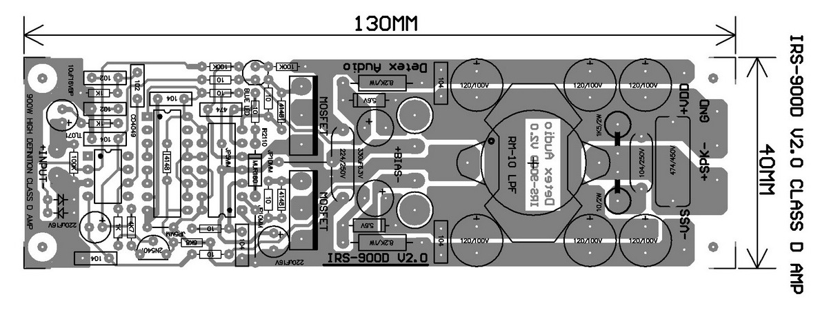

I have a problem with my irs900d beacuse I have an output of 1V DC (MOSFETs have different opening times)..how to deal with it?
How can I adjust the dead time?
IRS900d don't need dead time adjestment manuely,its optimised
check pin 10,12 of IR2110

blue pin 12, yellow pin 10
first you have to change CD4049 logicinveter ic
sorry, blue is pin 10 on cd 4049, yellow is pin 12An externally hosted image should be here but it was not working when we last tested it.
I started a new cd4049 and this is the same as it was.
The output dc has decreased to the normal level
this solve the problem
but it add some dead time and unbalence @high volume
extra heat on cd4049
Dinithm the problem is still...🙁
yellow pin 10 Ir2110, blue pin 12
Negation gate propagation delay is too long? 100ns difference
Output without the input signal, DC 0,8V.
you can add some extra dead time using this,
befor check output snubber(soble network)
and IR2110 IC
and IR2110 IC

IR9OO
LAYOUT-PDF😎
what r differences between these?!
hello, personal diy audio I wonder if I can pass the pdf files for tailoring irs900d for thermal transfer ... grateful !!!!
ir900
hello, friend !!! can pass me the pdf files to transfer the ir900 ?? grateful !!^ OK! thanks,
