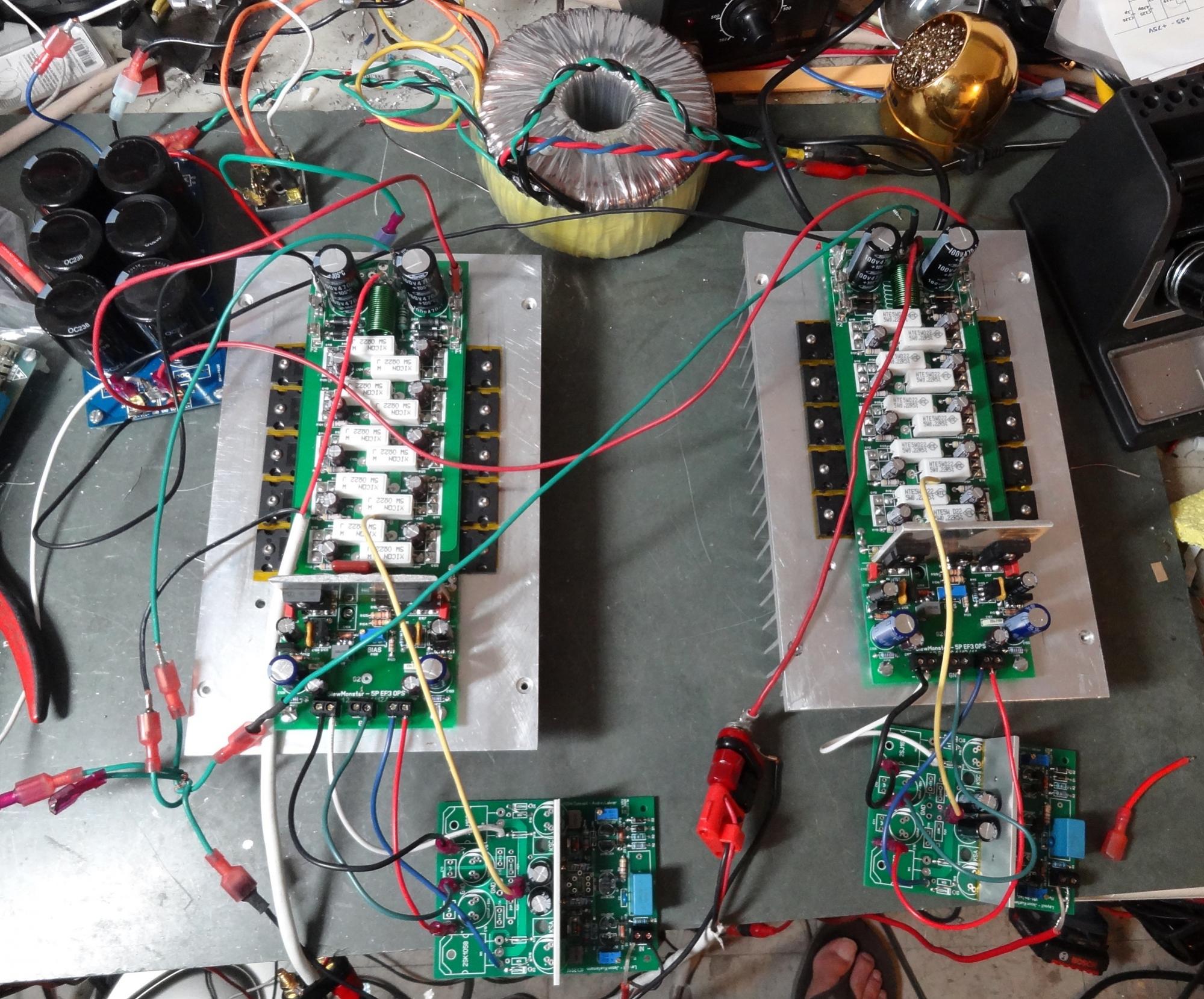

G2 on OPS not connected yet
this pict from post #2072
I see your G2 on OPS(near the terminal block) board is not connected anywhere yet...
There are two or three G2 on the OPS board, maybe you only connected the one near the rails tabs,
there is one G2 pad "free" that must be connected to the one near the terminal block
That should be connected to star ground if not then tour IPS is floating...

Hmm, did you ensure the G2 at both ends of the OPS were connected? I used a wire under the board but I don't see any evidence of the pads having been used.
Hi Guys,
Thanks for the suggestions and kind help. You are correct that in the picture, I didn't have the grounds connected on both ends of the board. I didn't see that instruction. I did connect it to star after thimios mentioned it in post 2105. I haven't installed a jumper on the board yet but I did attach both grounds to the star. Hopefully Jason will have time to hit his boards with some higher rails and see if he has a similar issue. I don't want to keep swapping parts willy nilly. It's too hard on the boards. I will take this time to install those long jumpers.
Thanks, Terry
Thanks, Terry

You can run R113 as high as 220R - I simulated 150R ... all is spec.
This will run the drivers at just 7ma.
When you said the oscillation stopped as you "fiddled" with the input ,
I should of realized you had no ground.
Actually , I'm surprised everything survived. I "floated a ground" and
let "magic smoke" out .
