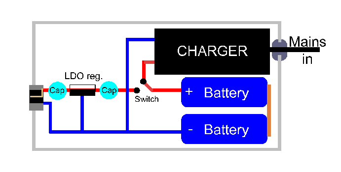

I'm looking to make up a 5 volt battery supply for a Hiface Two using LiFeP04 batteries.
Will the following work OK?
(using a LM2937ET-5.0 LM2937 Low Dropout Voltage Regulator)

Thanks Jesper,
I had (perhaps naively) assumed that the charger recommended for these batteries would charge them in the appropriate manner.
If it is not clear in my diagram, the batteries would either be powering the HiFace, or being charged when the HiFace wasn't being used.

Hi Nuuk,
No I'm not - actually, I can see that I didn't read your post in detail and so missed the link to the charger you were linking to. My apology for this - & for causing your confusion 😱
As it is your schematic may be ok. However, there might be some timing issues with the hiface electronics - i.e. that the voltage to the HiFace electronics must be present a certain time after the USB connection is established. I don't know since I am not familiar with the specifics for the HiFace Two.
Another issue could be that if you use a high value capacitor on the input of the regulator the switch you use would need to accept (very) high currents.
Thinking a bit more about it I've drawn up a circuit that might inspire you, (however, no guarantee it'll work as I don't know what's inside the Hiface, see above). I know there are also other ways of doing this but this is my suggestion as I reckon that you have a somewhat basic knowledge of electronics ... right?
First off - you might consider making the charger switch disconnect both the positive & ground wires - or disconnect the charger from the mains outlet when listening to your music.
Second - to make any charger circuit work you will need to disconnect the + 5VDC that the HiFace receives from the USB connection.
Then to the circuit: In this way the battery is only connected to the HiFace when the USB connection is also there. The first relay, S2, ensures this since it draws its current from the USB connection.
The simplest version is made of S2, a low value C1 (1uF), and a high value C2 (e.g. 1000 uF).
I took out the W1 switch but forgot to change the text - so please don't take notice.
The full version allows for a higher value of C1, which may/might improve sound (my guess would be that it does). C2 needs to be close to both the regulator and the HiFace.
If this is interesting to you I personally - before starting - would ask someone who knows about this if the HiFace electronics will accept a USB datasignal before the supply voltages are at their full value (& survive!). Both relays and capacitors have delays so I would make sure this is the case.
Good luck with your endeavors 😉
