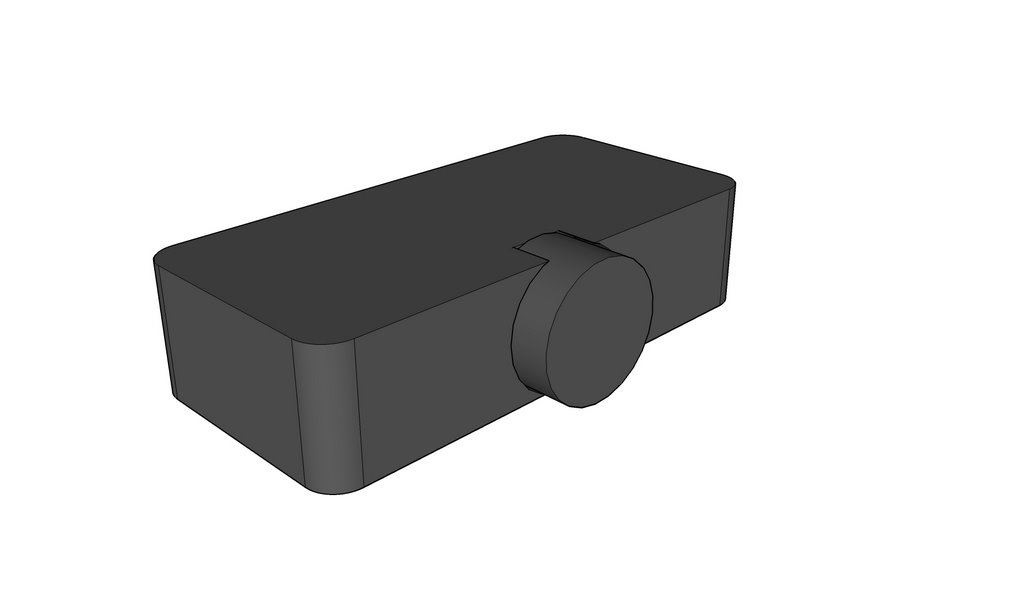

Hi, here are some photos of my audiosector LM4780 amps. I built monoblocks (1 lm470 in parallel) with separate power supplies so i could experiment with different configurations (biamp, bridge, use power supplies for other chip amps, power L, R, and surrounds, etc.)
i am presently designing a matching preamp that will look something like this:
