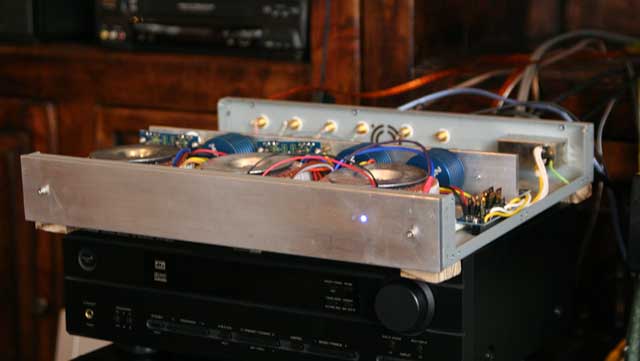

Here are a few pictures of my first (nearly) completed chipamp. It's tested and working, but I haven't totally worked out the power umbilical. These boards I purchased from chipamp.com and it's a dual mono power supply in one chassis and integrated stereo in another. I know my wiring job isn't quite up to snuff yet, but I think my soldering is pretty decent. The umbilical that I'm trying is cat-5 cable, solid core. The jacks are Neutrik panel mount, punch-down type. I'm still not sure if the jacks will be able to handle this much current.
-Michael Woods
Very Sweet!! ...Just curious: Is that teflon coated wiring on the inputs? Any silver wiring? ... :cool:
Also currious: where is the pre-amp board? Integrated w/ amp? ... or just switches to select inputs??
(IMOP: double up on the CAT5 (CAT6? CAT??) power interconnects = improved reliability at the connections, solder points, etc.)
Eddy,
Yep that is all silver wiring that I used. I forget what gauge. The "preamp" is simply an Elma switch and an Alps blue potentiometer.
Thanks for your suggestion on the cat-5 cable. I'll keep that in mind.. though it'd be a PITA to rewire and double-up. Since I'm running 8 separate power rails and grounds, that'd mean I'd have 16 wires to run total and two panel jacks. That's probably not feisable and I'd need to move to something more heavy-duty than cat-5.
-Michael Woods

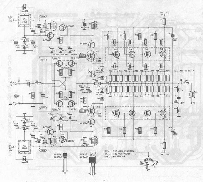

mofset amplifier 1000 watt power output
you can add transistors this circuit
