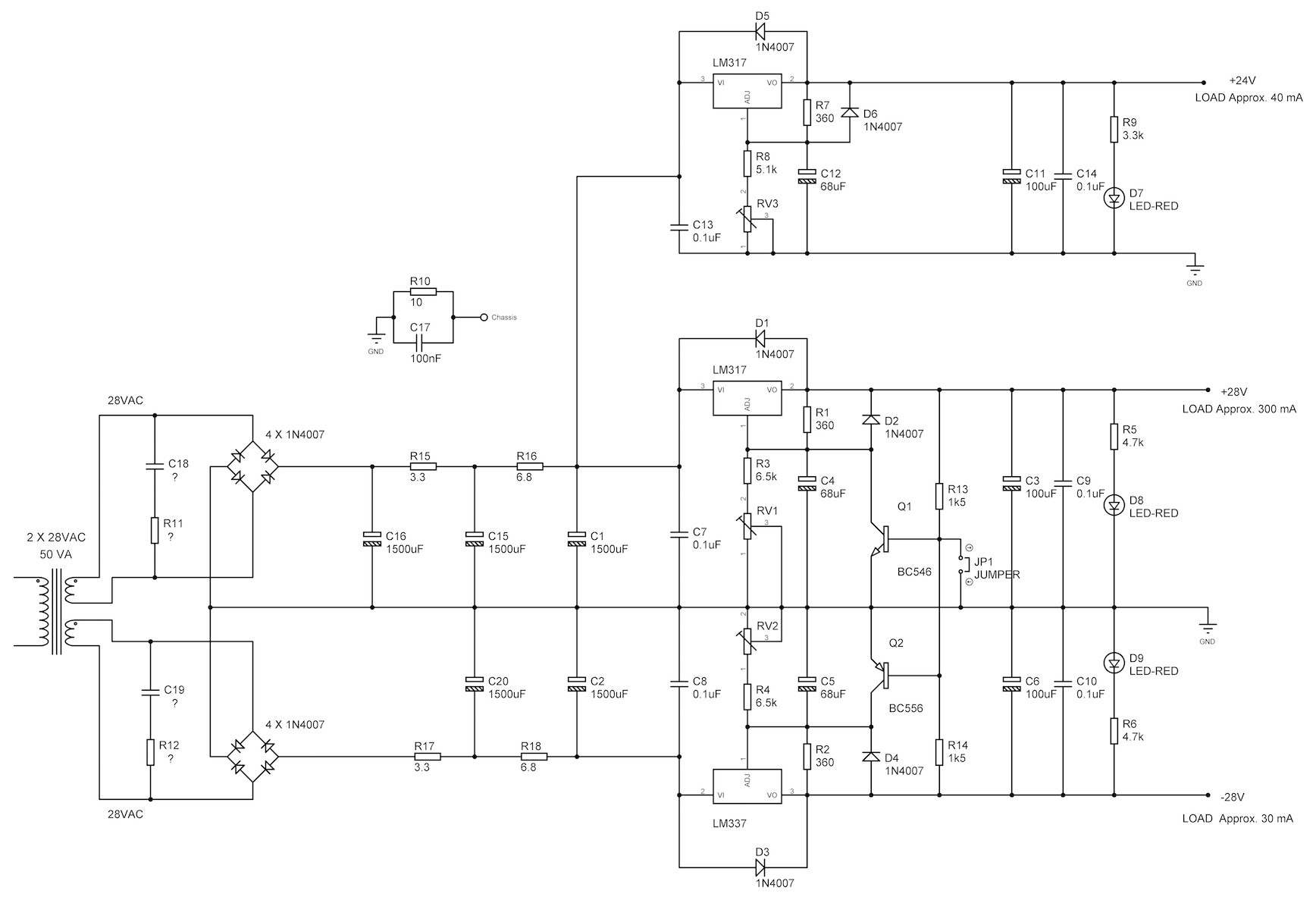

Basic schematic of through hole prototype version:
644601d1510165924-aksas-lender-preamp-40vpp-output-lender-preamp-aksa-schematic-v5-png

Mainboard schematic looks like this (note R141 is 10k not 220R):
649511d1512424995-aksas-lender-preamp-40vpp-ouput-gb-jps64-aksa-lender-preamp-main-schematic-png

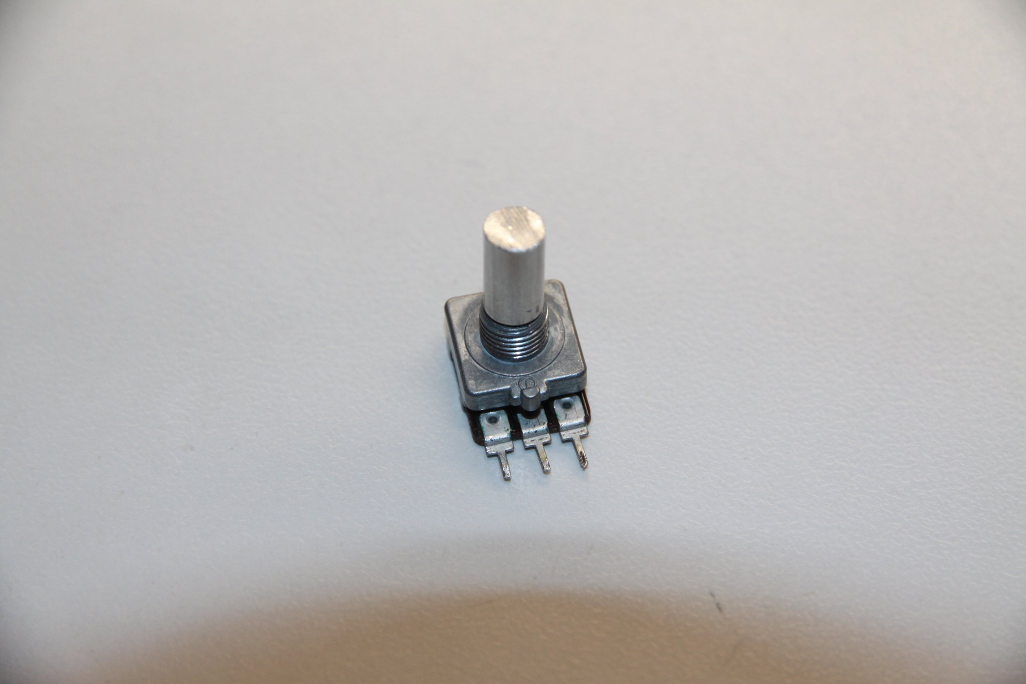

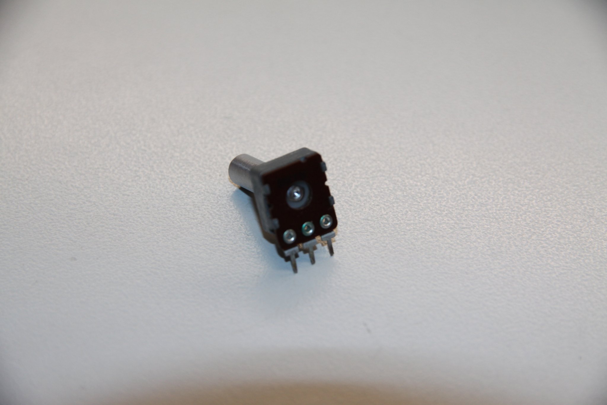

ALPS model 87281 100KAX2 or NOBLE AP25 203Y GPHAN 25S 100K
I am looking for an ALPS model 87281 pot to use in my Audio Research SP9 pre-amp.
I purchased an ALPS pot model 1450 but the pins don't line up correctly to the control pcb. See image - the pot I want to replace is shown at top
Funny, because Audio Research says the original pot was a NOBLE AP25 203Y GPHAN 25S 100K, while the one that's currently there is the ALPS 87281.
Anyone Have a ALPS 87281, or a NOBLE AP25 available?

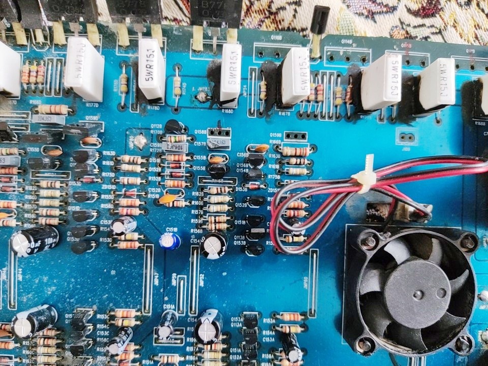

Marantz PM-68 Keeps Frying Output Transistors on Right Channel
Hello everyone! I have a serious issue with my Marantz PM-68.
A friend gave it to me with severe distortion on both channels. Turned out it only had bad solder joints on the driver transistors.
I repaired the bad joints and it was working perfectly for about a week...
After that it fried the output transistors on the right channel including :
  • One of the transistors : bf422 (7272 on the schematic)
  • 2 x 47ohm resistors (3322, 3324 on the schematic)
  • The 150ohm Resistor (3326 on schematic)
  • All the Resistors on the bases of the output transistors (4 x 10ohms) // 3328, 3330, 3332, 3334 on the schematic
  • One of the output brick resistor with 3 legs : 3w (2x 18ohms)
After i replaced all of that for the first time it fried the same components again after 2 minutes. Even though the voltages at the bases of each transistor where measuring fine:
  • i had my +- 56v from my power supply and and all the transistors where receiving the appropriate voltages.
  • I had my +- 1.6volts at the biasing circuit (transistor 2sc3419 // 7268 on the schematic) and at the 2x 100ohm resistors (3314, 3316 on the schematic).
  • I had my +- 1v at the emitters of bf422, bf423
and so on..
Long story short all the voltages at the bases and emitters of the transistors up to the final transistors where measuring fine and suddenly the magic smoke appeared...
So i replaced all the transistors (look at the attached photo // schematic), electrolytics, diodes (including the zeners) and it worked fine for about 2 minutes again and then poof!! It fried the same components.
The third time i replaced the output transistors i left their bases "in the air" / not connected and was measuring again and again the voltages in the entire circuit even after it was working for 30+ minutes, once i connected the bases it blew after 2 minutes again.
For some reason the output transistors short on all 3 legs taking with them all the components driving them..
A few final notes:
- The left channel is stable and working fine so i don't think it's a power supply issue.
- I was measuring 0mv bias on the channel that's fried even though the voltages where present where they should be, the trimmer was replaced and checked but no matter how i was setting it no change occured.
  • The output transistors where all pretty cool when it happened every time, the driver transistors where hot to the touch but so where the other driver transistors on the left (working side)
  • The Dc Offset at the output for the 2 minutes that it was on without load // speakers connected was about 10mv, i could not get it to go lower than that after i replaced all the transistors. Also in order to get the Dc offset to get to the appropriate point i had to turn the dc offset trimmer about 90% of the way to the max, while before the first failure occured it was at about 50% of the way
  • The third time it fried the outputs it blew the main 15A power supply fuse while before it did not get to that point.
  • The transistor differential pair on the left side measures fine and provides the +-53volts i pulled them and checked them
So this has become a very expensive repair for me since i'm at it for about two weeks now and the same fault keeps occuring.. (3 times so far!!)
Based on the schematic can you think of something i did not?
How could the voltages be correct at every stage but still it blows up?
Is it oscillating for some unknown reason?
Could the transistors i'm buying be fake and causing the fault?
I'm really dissapointed and i ran out of ideas..

UKC av326BT - burned
Hello guys. I am prety new into this. I bought this cheap thing UKC AV326, but seems like I've short circuit the left channel, and the smoke machine was triggered inside.
I've opened it, and noticed one resistor 39 Ohms was burnt. Replaced it, but it burned again. No sound during burn tho.
Any idea where to start with this thing to repair it ?

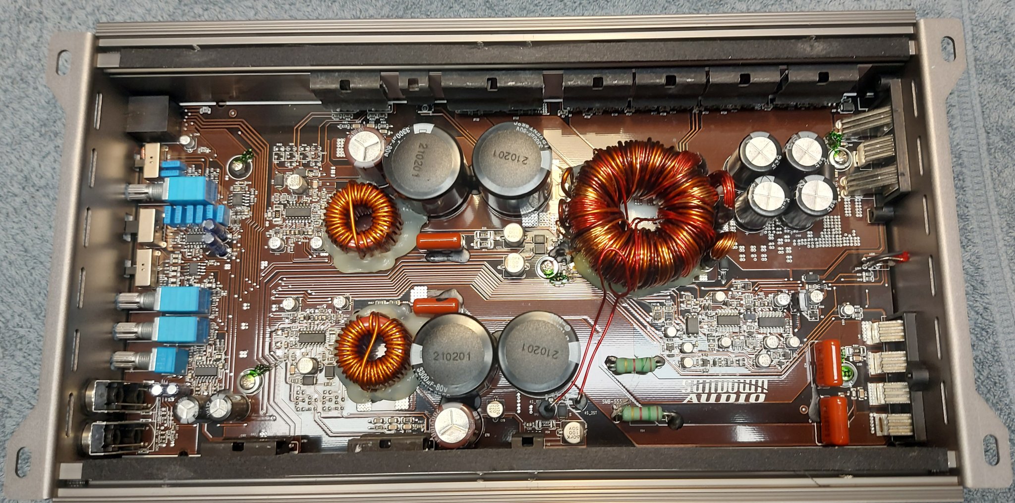

DBA 1600.1D has red and green light
Every 5 to 6 amplifiers I get on my bench has something I can't figure out.
I have a dba 1600.1D on my bench.
1. Powers up no shorts, all Power SW50N06, Output 2SC520 and Rectifiers F12020A & F12020C tested good.
2. At idle it consumes .56 amps with no voltage drop.
3. T494 tested good, has +12v on pin 12 and -0v on 7. no pwm on e1 or e2, has .347v on pin 4
4. Op-Amps have nothing. I replaced the PC817 Optocoupler.
5. 12v on both rails.
6. Changed both diodes in5408. changed all transistors down the middle.
7. I get 12v on primary side of the transformer and only 7.4v on secondary side.
8. I tested all resistors and diodes.

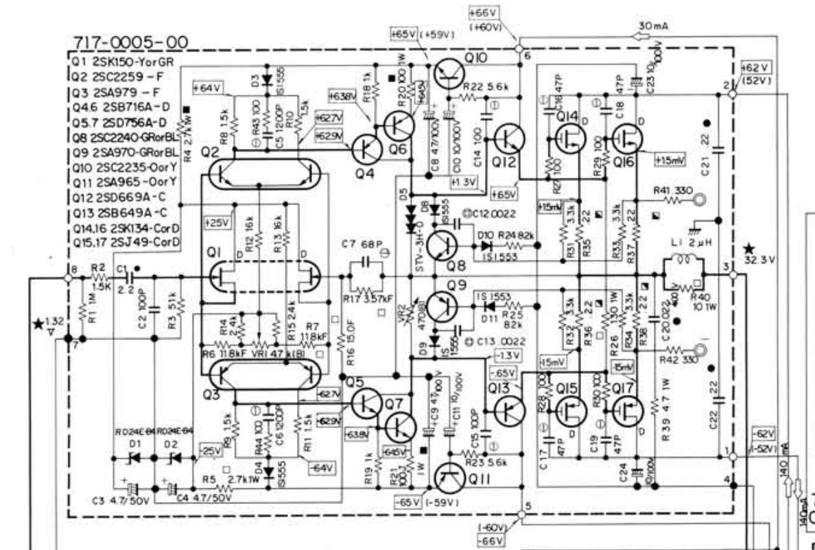

NAD 720BEE pre-amp analysis
Greetings,
Attached is a schematic that includes the pre-amp modules of the 720BEE (at the bottom).
Does anybody recognize the circuitry used in these in/out modules? Is it a clone of a good pre-amp design or something proprietary by NAD?
Thank you!

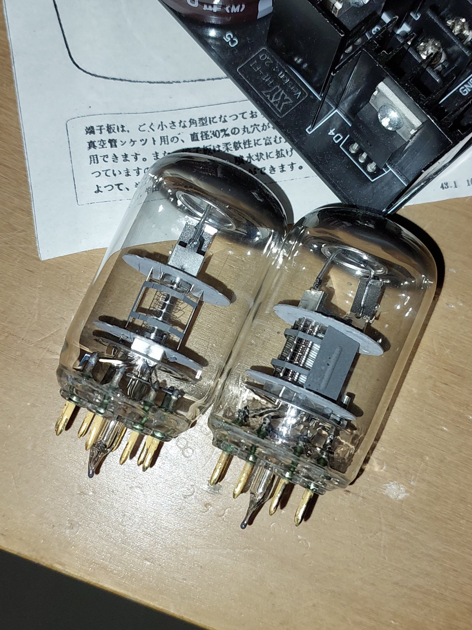

Re-purposing two half-used 12AX7 to add in a pre-amp on my KT88 Tube amp
Hi there, very green here. But Ill dive right in.
I have a KT88 Tube amp, as seen in the photo below, I bought it second hand. The two smaller tubes in the front (12AX7) from what I understand only have one side of them used (ie one line per tube), though are capable of having two lines running through them. The reason for having a tube per line here is presumably for aesthetics? is this the only reason?
Well, its a little quite. I am wanting to build a pre-amp to bump up the gain before it goes through the current KT88 amp. My main question is, can I simple divert both channels through one of the two 12AX7, and re-purpose the other in this system as preamp tube. Im looking at building something like this which requires one 12AX7 Tube. This would save me having to buy a new power supply, and another tube, and socket and....
Im looking to redo the chassis for the KT88 Tube amp so I could make it a little larger, thought the preamp in the build above doesn't look to have a large footprint.
Are there any issues when integrating a preamp into an existing tube amp?
if this is fine, would it be best to use one for the purpose of pre-amp and the other as the pre-boost (which it currently does), or keep the lines separate so one side of of each 12AX7 is pre-amp, and the other continues to do the boosting that it already currently does before feeding into the KT88 tube?
Hope this make sense!
Thanks in advance.
