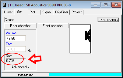

Hi all. First let me say i have never built a speaker, and this is the first time I have used winisd. I would like to build a sealed box speaker using the new SBA 8" fr driver. Downloaded winisd and came up with a 46.55 liter box. Then I went to an online modeling site and they came up with 45 liters. So far, pretty close. However, the Madisound site that sells the drivers recommends .6 to 1.0 cubic foot box. or roughly 16 to 28 liters. I have also read where stuffing the box with polyfill or whatever makes the box effectively 20 to 25% larger. So now the driver thinks its in 54 liter box???? I don't quite know what to believe here.
Never used winisd before so it is entirely possible i did something wrong, but on the other hand, the online calculator agreed pretty much on the size of the box. I understand the compromises of a sealed box vs vented but am willing to sacrifice some bass for better accuracy. I also want one the correct volume so it doesn't lose the effect of the sealed box properties.
So, did I do something wrong or is the seller wrong??? This will be a first time build, and have wanted to try an FR driver for some time now. Just want to get it as correct as possible to get the best results I can. Any input is greatly appreciated. Thanks, J.D.

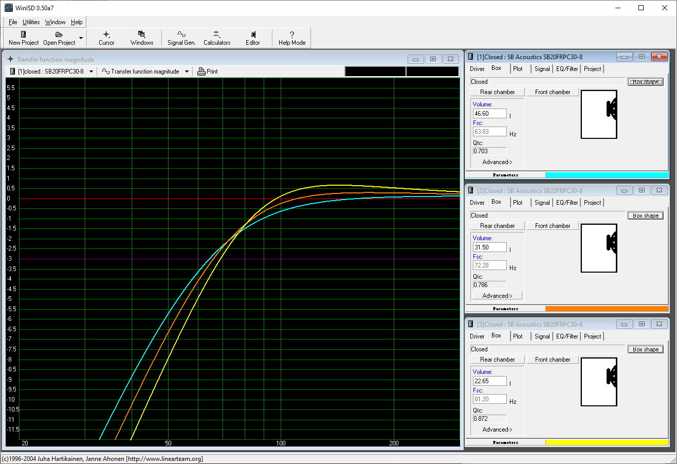

Im running windows 10 and just installed the older WinIsd pro alpha. It is what im use too.
I cannot stand the newer version.
It is useful as a calculator and I like the sum check for driver parameters.
Also easy to cross calculate imperial/metric.
Far as the original question.
When you calculate sealed with Winisd it will shoot automatically for lowest feasible Q
based on driver parameters. So likely you 45 liter box was around .707 to .8 Qtc
For whatever reason Madison sound choose a higher Q enclosure which is smaller.
So WinIsd will do the same thing. you can pick whatever Qtc you want when you start the project.
Sounds like they likely recommend something in the 1 to 1.1 Qtc range.
where as Winisd and the online calculator with " Auto" align will shoot for low Q so
yes the boxes will be bigger.
as long as the driver can mechanical do lower Q or total Qts is not too high.
WinIsd can calculate down to .5 Qtc up to usually 1.5 Qtc
.5 Qtc being larger box 1.5 Qtc being very small.
you can open multiple projects in WinIsd with same driver.
Another feature I like since you can compare different alignment results all at once.
