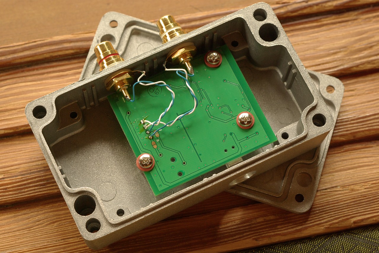

I cased up my odac board (NwAvGuy via jtktam) in a small aluminum project box.
The DAC is a simple two-chip affair, with a Tenor TE7022L controller fronting the ESS ES9023 DAC and integrated line driver. A couple of voltage regulators, the clock oscillator, and an eeprom chip round out the principle component list.
I compared it with my Onkyo SE-200PCI sound card. This 24/192 (115dB S/N A-weighted, 0.003% THD 0dB 1kHz) PCI card sells for about $15,000 yen and is based on the VIA Envy24HT and Wolfson WM8740.
I'm listening to 16bit 44.1kHz .wav (CD rips), though VLC [sample rate converter set to sinc, best quality, resampling quality 8]. Windows 8 release preview [default format 24/192 (onkyo), 24/96 (odac)]. Line out though Oyaide PA-02TR interconnects to the Sapphire headphone amp, and Sennheiser HD-600s.

I am therefore tempted to conclude that its the odac that has issues. Could be a layout or configuration miss, could be, I suppose, that that's the way the ES9023 sounds. Either way it's not really my cup of tea.
Perhaps I should give the odac time to break in? I didn't think of that, since there were no electrolytics on the board (caps are all tantalum or ceramic SMT). Worth a shot anyway - I'll give it 24h of decoding white noise and see if there is any difference.
No. That didn't help. It seems to have opened out a little, but the fundamentals remain unchanged: Admirably clean sound, but flat and synthetic.

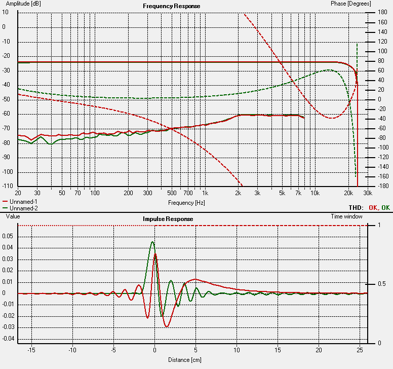

According to my crude measurements the ODAC exhibits a phase wrap at 2kHz. That may be what is setting it apart in your listening tests.
