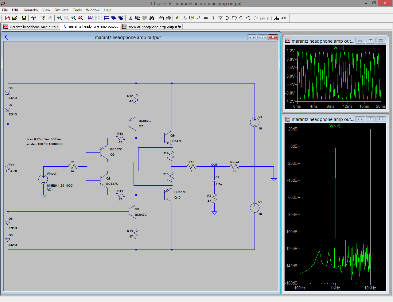

Browsing through an old issue of MJ (No. 1076), I found some sketches of the Marantz SA 11S3 SACD player analog circuitry which seemed interesting.
The are two discrete op amp "modules", one is used for the I/V converter and low pass filter, the other design is applied to both the line output and headphone outputs.
The parts and values are not given, so the circuit below is just a working mock up in LTSpice based on the published diagrams.
The output stage from the headphone / line driver op amp is attached below. There's a JFET input and BJT gain stage as well, and the whole thing is wrapped up in a feedback loop. The buffer itself, being unity gain, works just fine as a standalone circuit element.
