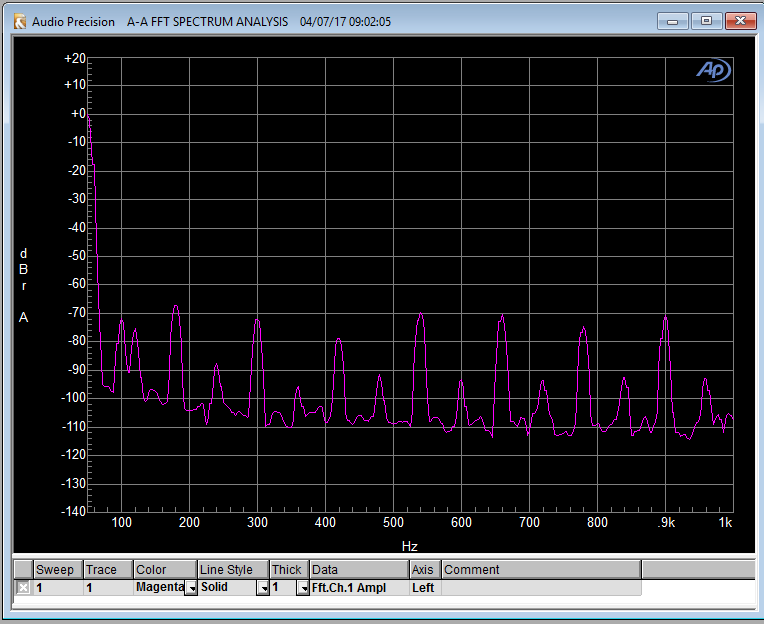

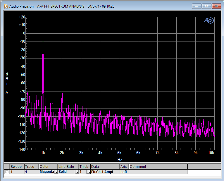

Some snapshots -- there are some power supply issues which need attention, otherwise, with EH 6922 the THD% is spot on:

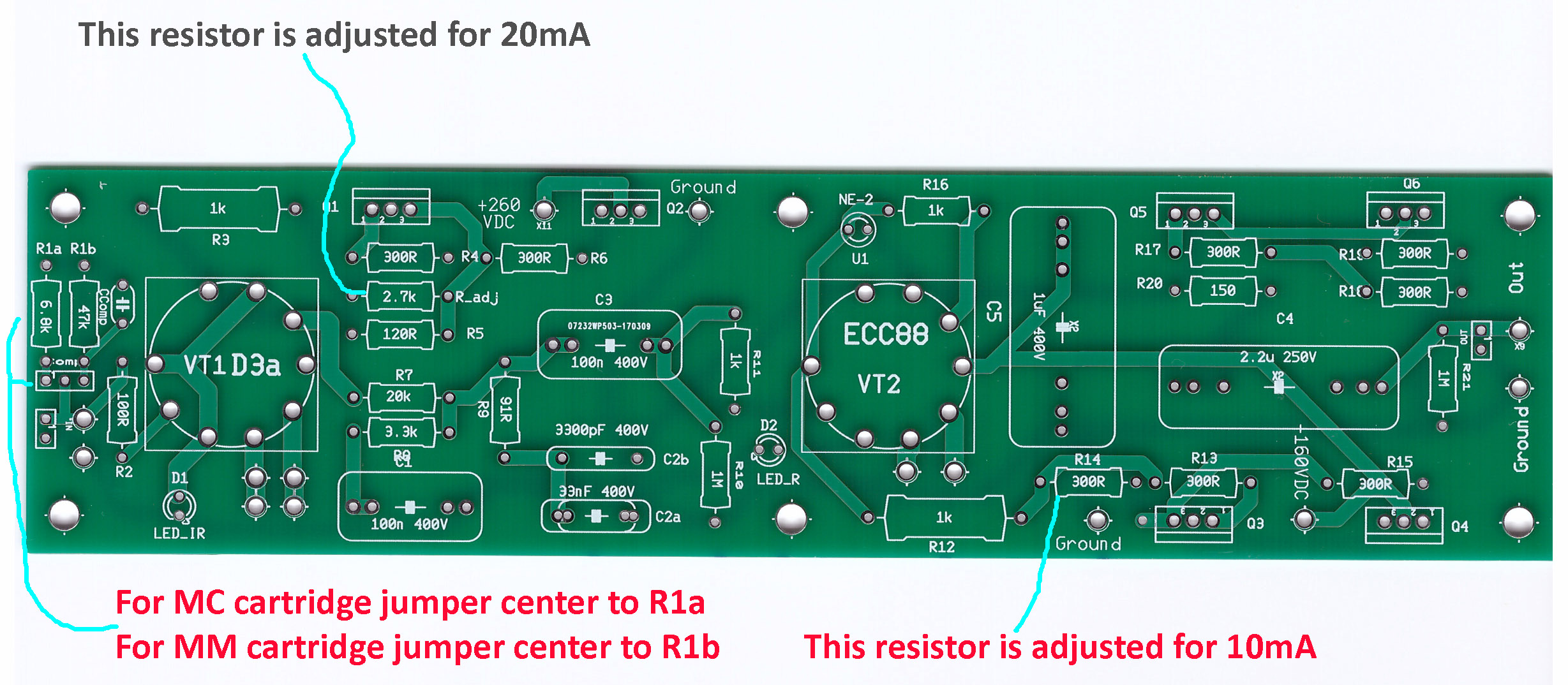

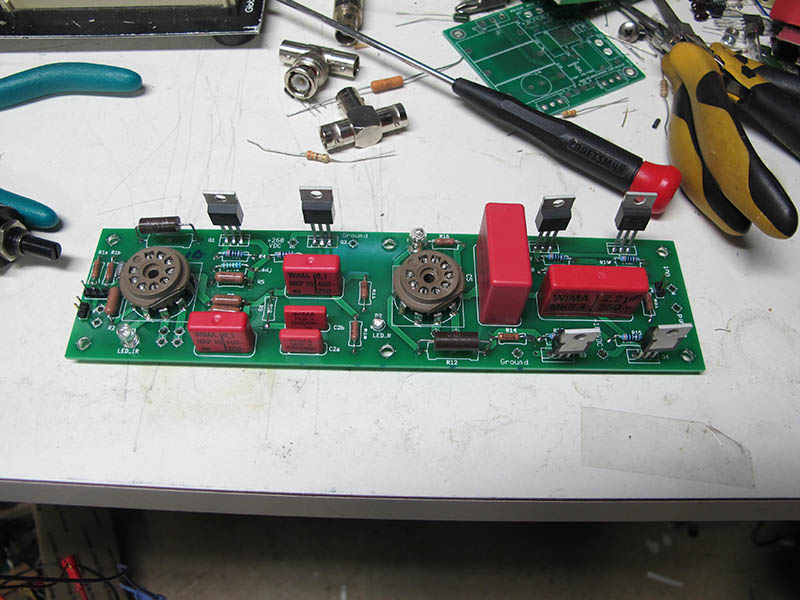

The PCB helicopter view:

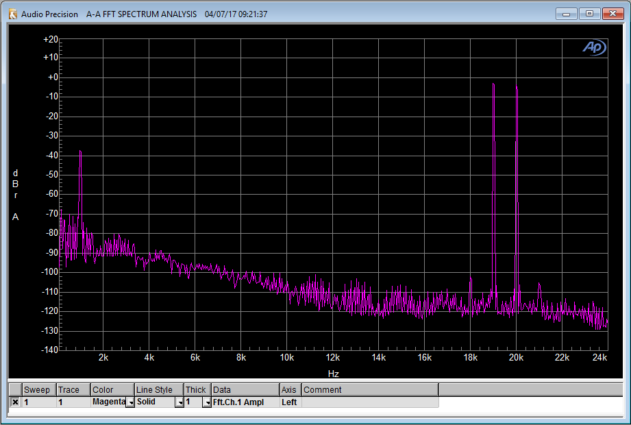

Nice work! What's the 19k and 20k peak on the graph?
7th April 2017
jackinnj's Avatar
jackinnj
diyAudio Member
Intermodulation Distortion. The spurs are almost 100dB below the mixed fundamental which is darn'd good.

100db anything seems pretty good to me! I wish my scope was that quiet. Think i need to get a better one.
So is your input signal a simulation before transformer at about ~0.2mV or post transformer straight in to the input on the board at ~2mV? 100db down from that seems insanely low noise, amazed thats even possible.
