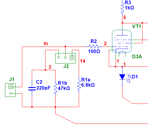

For an MM cartridge you can abandon balanced mode and load the grid of the D3a with ~47k.

With a 1x3 Molex Header, you can select either 47k||220p or 6.8k

I'd run the first stage at 10mA, the second two at 4mA. The original values work fine, but dropping the current will extend tube life and reduce heat at no performance penalty.
How can i adjust this operating points? Need to change the CSS?
best regards Frank

Frank -- I understand that SY is taking a vacation from DIYAUDIO -- to answer your question, you can change the operating point by changing the LED, or putting a resistor in series with the LED. You'll then have to change Rset on the CCS for the current.
