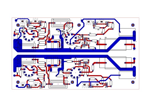

frankwilker
diyAudio Member
could somebody take a look to my design? Are there correction needed? Or have someone an idea for improvements?
The board is 240x140mm cause it has to fit an empty cabinet in my Hovland HP100. I bought the Hovland used, without Phono Amp.
The design is not symmetrical. So its possible to put the GND of both Channel together if needed. Is this okay?
i would use Glimmer-capacitors for the 32nf-capacitor. The board can be fitted with Wima, Mundorf or Hovland capacitors.
The connection for the tube filament will be soldered directly at the sockets.
Thanks for your help.
