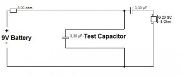

Well as far as I am aware microphonic effects happen in a cap because the layers of the foil get compressed and this generates a voltage, much the same as how an electret micophone works. One could argue that if the entire cap is shaken and all the layers move in unison then nothing will happen.
You sound like you're sceptical, 5th element. :)
If I was to devise a test circuit for microphonics, it would probably look like the below with a tweeter.
No idea if it would actually pick up anything. Haven't tried it. But you need to polarise a capacitor for it to behave like a microphone.
Edit. Thinking about it, I'm not quite sure if an 8 ohm series resistor on the test capacitor might not be a good thing too.

Well I was thinking of just sending a 1KHz tone thru the cap to the recoding device. Then vibrate the cap with at frequency, I dunno, 100Hz. Or a sweep. Will that modulate the 1Khz tone? If it's there, you should be able to see it on an FFT plot.
