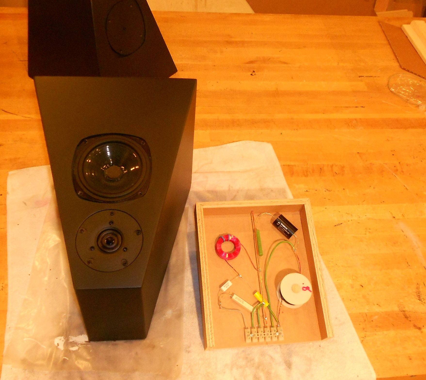

I just built 2 pairs xo's the second pair didn't sound as good as the first set. I used Bennic Polypro. (yellow), that's when I re-ordered the clarity caps.

This is turning out pretty good....considering these have been to He** and Back (they were outside for a long time).
Re-fit the speaker holes with wood adapter rings and re-painted. The xo will be part of the speaker stand.
The yellow cap looks pretty wimpy (also ordered some better resistors). As just mentioned, the other board(s) sounded better.
The triangle boxes are 1" mdf and lead/foam lined.
