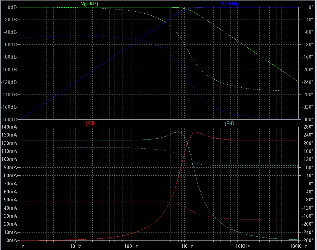

I am not advocating that bi-wiring works. What I said however is true. It's simple filter behaviour.
There may be HF and LF voltages on both cables however the crossover for the tweeter presents an increasingly higher input impedance at low frequencies. This is part of the mechanism of attenuation. The reverse condition exists for the crossover for the woofer.
This is simple fact.
It's the notion that the fields somehow interfere with each other (since both currents are flowing on the same cable) due to some mystical phenomenon or the non-linearity (passive intermodulation distortion anyone?) of a conductor that constitutes what could be the snake oil.
In the attached files R3 is the tweeter cable and R4 the woofer cable. Both see the same voltage from the source however the currents are very different. At the crossover frequency of 1kHz the current in each cable is about 120mA however a decade away at 100Hz the LF current in R3 is 10mA. That's what I am talking about.
If those are about 100-inch-long cables, you should also be adding about 2450 nH of self-inductance, in series with the 0.1-Ohm resistors. Then maybe you will see the second effect. Besides the fields, and the voltage induced across the parasitic resistance, the time-varying current will induce a voltage across the parasitic inductance, proportional to the time-rate-of-change of the current.
You can just change the resistor to an inductor and then right click on it and set the inductance to 2450n and the series resistance to 0.1. And set the two parasitic capacitances to zero. Or, leave the resistor and inductor as separate components. But in that case I think that you have to explicitly set all of the parasitics to zero, in the inductor, so that they won't default to some other value.
The next step closer to the real world is to replace the purely resistive loads you have for the drive units with non-linear elements.
True but the simulation showed the effect I was mentioning. With the addition of reactive elements to simulate real cable and drivers the same effect would manifest albeit with some additional variations with frequency.
