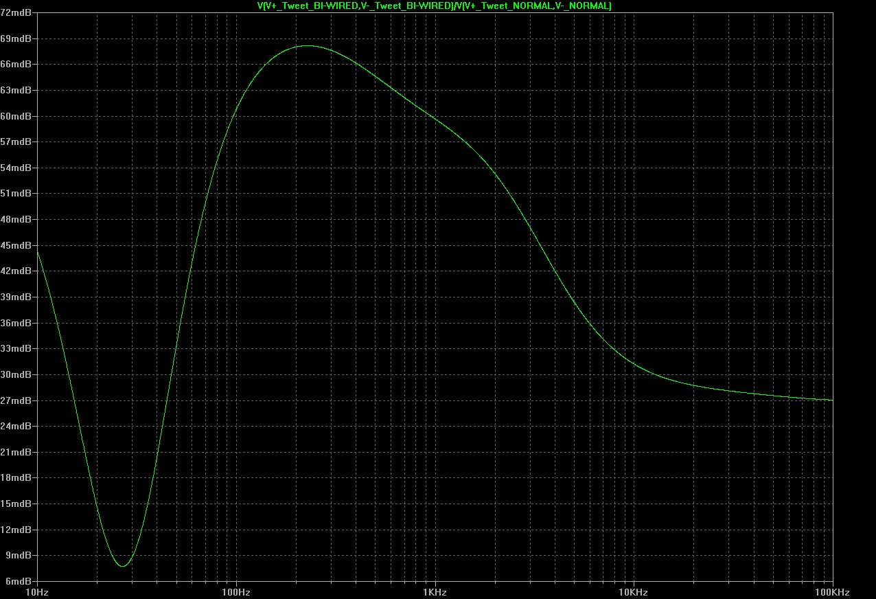

Based on only one configuration's simulation results, some of which are attached, it looks like the differences between single-cable and bi-wiring would usually be small but not necessarily inaudible.
Interesting results from a good bit of simulation effort.
Is the *.asc circuit file available for sharing?
If I understand your plots correctly the maximum difference in tweeter voltage is < 0.1dB?
You should probably double up the runs of wire on the normal configuration to have a proper comparison(ie equal total wire impedance) with bi-wire, right? Or, were you intentionally NOT doing this to show what possible differences might be there for people to hear if they simply added another cable to bi-wire and compared with a single cable of the same type/gauge.
Sure. I will attach the .asc et al.
The third plot, and the top and bottom plots of the fourth one, are not in dB. But yeah, I think that the maximum difference was about 0.068 dB, at about 230 Hz. Attached is the same plot, but in dB instead of linear.
The cables were configured the way they were in order to compare a "normal" single-cable scheme to a bi-wiring scheme. And anyway, I think that the impedances are already the same. Note that the bi-wired cables are not in parallel, except at the amplifier end.
