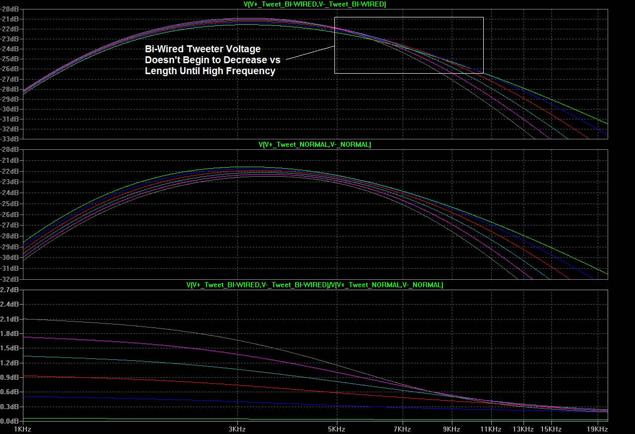

I swept the cable lengths to an extreme and noticed some possibly-interesting tendencies.
Firstly, this shows that there definitely is an effect, from bi-wiring. The parasitic L, R, and C are what is being increased. I happened to have those parameterized in terms of the length so I swept the length parameter because it was easy. But there are other reasons that the L, R, or C could increase, which might cause similar effects. Using thinner wires, for example, could mimic increasing the length, in terms of R.
Another effect that was noted: Up until at least 6 kHz, the bi-wired tweeter voltage response changes much more slowly, as the cable length increases, than the single-cabled one; about one third as much per unit of length increase.
Also, up to about 6 kHz, the bi-wired tweeter's voltage response INCREASES as the cable length increases, while the single-cabled tweeter's response decreases (at 3X the rate than the bi-wired one's increases, as already noted).
The bi-wired tweeter's voltage response doesn't start to decrease vs the increasing cable length until between 5 kHz and 11 kHz.
Plots are attached. The length increases that are noted in the plots (13 feet to 513 feet in 100-foot increments) would have increased the L, R, and C according to the values per foot that were used to model the 12-gauge "lamp wire" speaker cable: 1.7 milliohms of resistance per foot, for each wire of the two-wire cable, 0.19 microhenry of inductance per foot of cable (divided between the two wires, for simulation), and 21 picofarads of capacitance per foot of cable (from one wire to the other). A 100X increase of any of those is not very much.

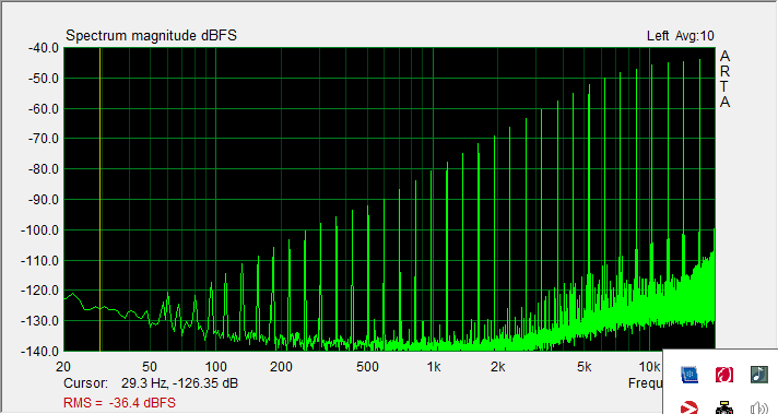

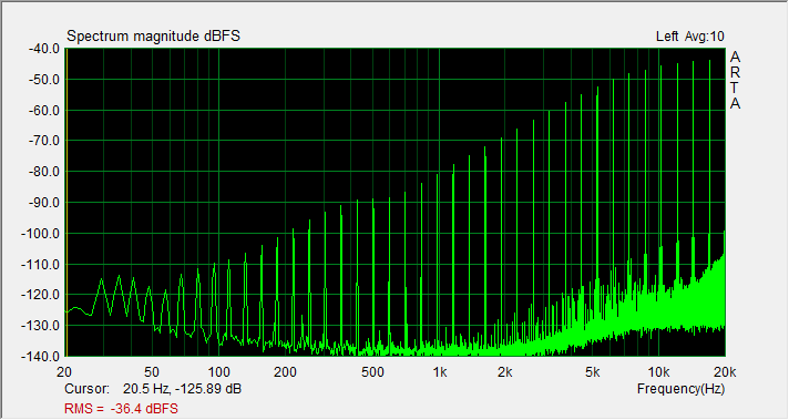

OK, got a chance to revisit my measurements, this time in differential mode.
Results:
The only difference I can find is maybe 1dB more low in the tweeter with single wire than with biwire. Frequency pairs used were 250Hz+8kHz and 186Hz+9.5Khz 4:1 amplitude ratio. Results were consistent thru multiple tests and rewires.
I don't know if this would hold with other amps, other speakers, other crossovers. Nothing else I measured was different. Not THD, not harmonics, not noise, not amplitude. A least for my system, it's hard to find any difference at all. FWIW & FYI
Results:
Looks more like 12 dB difference, at 35 Hz, and at least 4 dB up to 500 Hz.
I saw some small THD differences, with LT-Spice, during two-tone tests. But they were probably all what I would call negligible.
Maybe try a loud 35 Hz tone and a soft 2 kHz tone and check the THD of the 2 kHz tone, for normal and bi-wired.

I noticed you are comparing voltages across the motional impedance portion of the woofer and tweeter, see Figure (A). Is there a particular reason you were doing this? Wouldn't it make more sense to be looking at the voltage applied to the drivers as in Figure (B)? Alternatively since cone velocity is proportional to current thru the voice coil, you could consider the current thru R12(tweeter) and R15(woofer) instead. Since far field response(SPL) of a piston driver is proportional to piston acceleration not velocity, you could multiply the currents by frequency to get acceleration if desired.

I forgot to post one obvious set of measurements from the LT-Spice simulation model that was used to compare bi-wiring to a single-cable speaker connection: Cable Loss sweeps. Attachments include:
- Voltage Response vs Frequency at each end of bi-wired tweeter cable and at each end of single cable, for 13-foot cables
- Loss in each cable, vs frequency, for 13-foot cables
- Loss in each cable, vs frequency, for lengths from 13 feet to 513 feet, with 100-foot increments
I also forgot to emphasize that all of the measurements and plots that I have posted could and probably would be different, and possibly very-significantly different, for every different crossover, cable, and amplifier.

Thanks!!
I guess I had some vague notion that I would be plotting something proportional to the SPL, i.e. "the output" of the speaker.
Apparently I didn't understand the speaker models quite well-enough.
I will have to re-do some of the plots and see what kinds of differences it makes.
