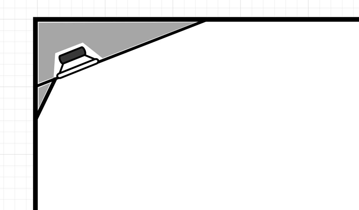

Here's a sketch (I really need to learn SketchUp at some point):

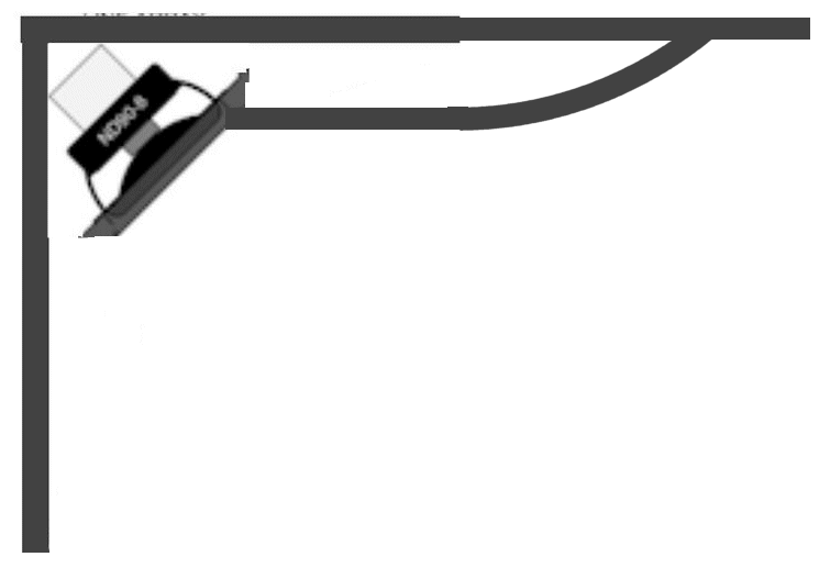

How's this for shape?
I like to keep things simple.
It's asymmetrical, which is a good thing, and probably will get you your 2 litres needed per driver. Stuff the inside well.
Easy to build, one baffle panel, and one extra "dowel" or side stick, with stuffing inside, shaped to follow the cone extension and ease the way to the side wall.
That would be my approach to wall corner based line arrays.
Having the drivers at 45 degrees like in your drawings, it would probably accentuate the "headphone" effect provided by the arrays. By going a bit more relaxed angle, it might widen things a bit better.

So something like one of these?
Assuming that if you mount the driver at/in/behind the corner there will be no discontinuity, it follows that the further from this point you start the greater the compromise (unless you build a completely freestanding one).
Firstly, the front (baffle/guide) and rear (enclosure) have independent needs and how you manage the rear with the driver so close to the corner is another story.
You could at least protect the highs by holding them straight then releasing them slowly by controlled diffraction after the wavefront has 'matured'. The throat size, angle, mouth size before roundover and roundover radius all need to be decided upon.
Also, the lows should be able to go through and past the waveguide, the distance of its walls from the room walls will become acoustically small at some frequency so this can also be considered. It becomes somewhat complex but you should be able to arrive at values that give you some overlap in needs.

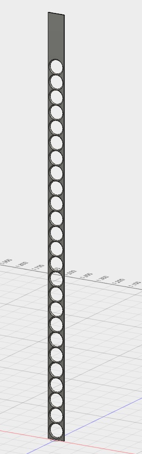

I priced out some custom cut 1/4" aluminum 4" wide by 93" long. Two pieces delivered would be $135 which isn't too bad. I could potentially get them locally for less. I might go through a few hole saws but something to consider as the baffle size to strength ratio obviously improves and it gives me some other options for isolating the baffle from the wall.
To your point, I think now is a good time to start modeling with some to scale mockups to get a better sense of what this really might look like. I also downloaded Fusion 360 and will play with that. Thanks for the tip!

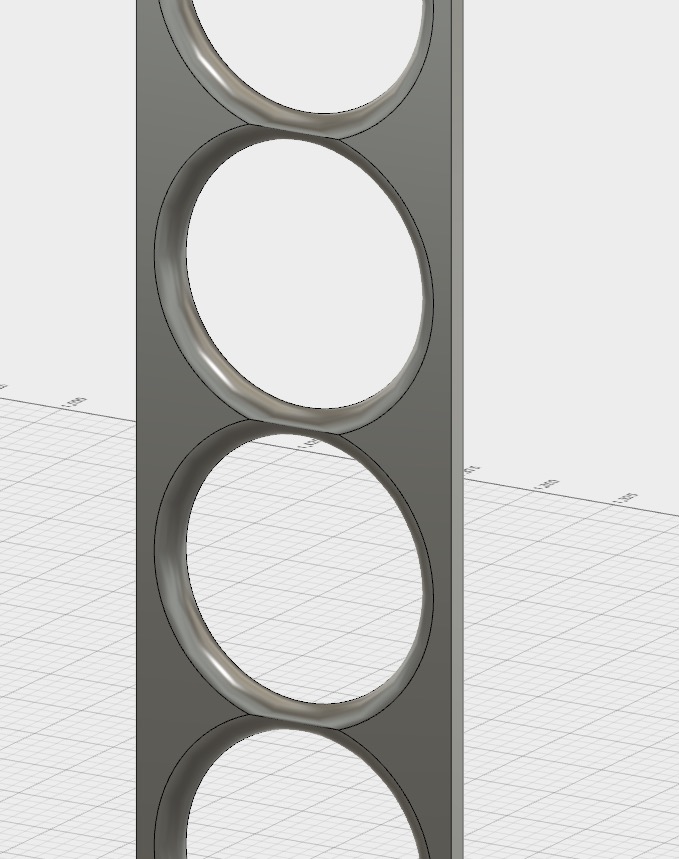

Wow, Fusion 360 was much easier for me to pick up on compared to SketchUp. Here's the drawing for a 1/4" aluminum baffle just wide enough to mount drivers to. I'm considering how this would interface with either the wall itself or some wings in a way that isolates it but maintains a tight seal. If I go this direction, then mounting from behind is an option again. I'm not super happy about the gap of drivers on top even though I realize the floor reflection is the one to prioritize. 26, 27, and 28 drivers is just really tough to deal with for a reasonable impedance. Maybe someone here has a combo that I haven't tried that ends up in the 4-10 ohm range?
Also, I sourced two pieces, 8' long, for $75 total. A little work with a 3" hole saw and a 1/4" round over bit and we're good to go! ;)

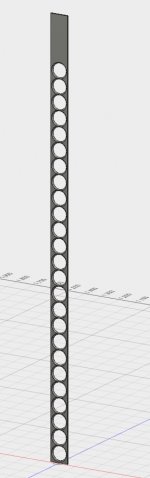

Also, I think I might be able to squeeze 28 drivers in there which grouped 4 x 7 gives me 4.57 ohms which my nCores can handle. Or 7x4 which gives 14 ohms but I think 4.57 is preferable, no?
You will need a little more space at the bottom as you will probably need a bottom plate of some kind. That baffle is great as a cover plate but I would advise to build it in a sandwich like wesayso did. fix the drivers to the back panel fill the gap around the drivers with damping fix the cover plate to the top.
Even 1/4" aluminium with all the holes cut in it is going to have a bit of bend over 2m.

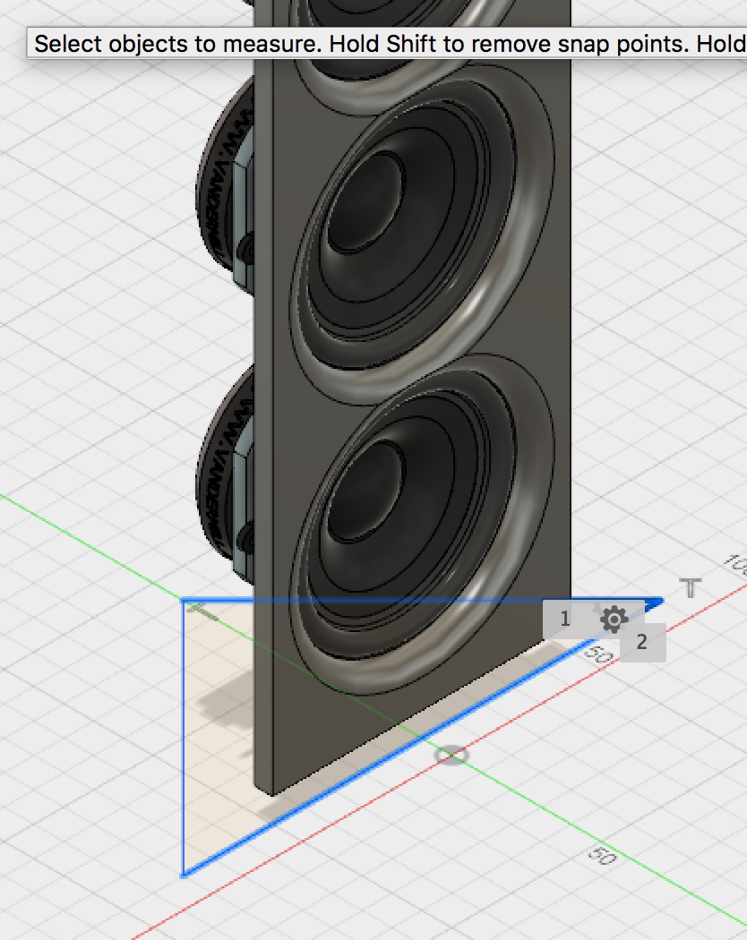

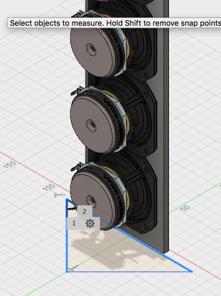

I can't figure out how to get wesayso's model into my baffle model? Fusion Help was not helpful.

You need to import the file this link will show you how.
https://knowledge.autodesk.com/support/fusion-360/troubleshooting/caas/sfdcarticles/sfdcarticles/How-to-import-or-open-a-file-in-Autodesk-Fusion-360.html
I got it into my data panel. And can open it by itself. I can't figure out how to get it next to my baffle though.
Right click on it in the data panel and choose insert into current design :) (Assuming that your baffle is the current design)
You can then move it around.
You can try and select the centre of the driver and move that to be at the same point as the centre of your opening, you may then need to change views to move it in or out.
I found the best way was to create the mounting holes in my driver cutout based on the datasheet and then select the centre of the mounting hole in wesyaso's model and move those points together.
Once you have one right you can then make it a component and pattern it down/up your line.
Thanks for the tips... I don't know why I didn't try right clicking. The pattern feature is pretty nice too. I can't believe I waited this long to learn a CAD program again! I was pretty decent at AutoCAD (2D) way back in the early 90's. And you would think that SketchUp would have stuck a little better. But Fusion is so much easier for me for some reason.

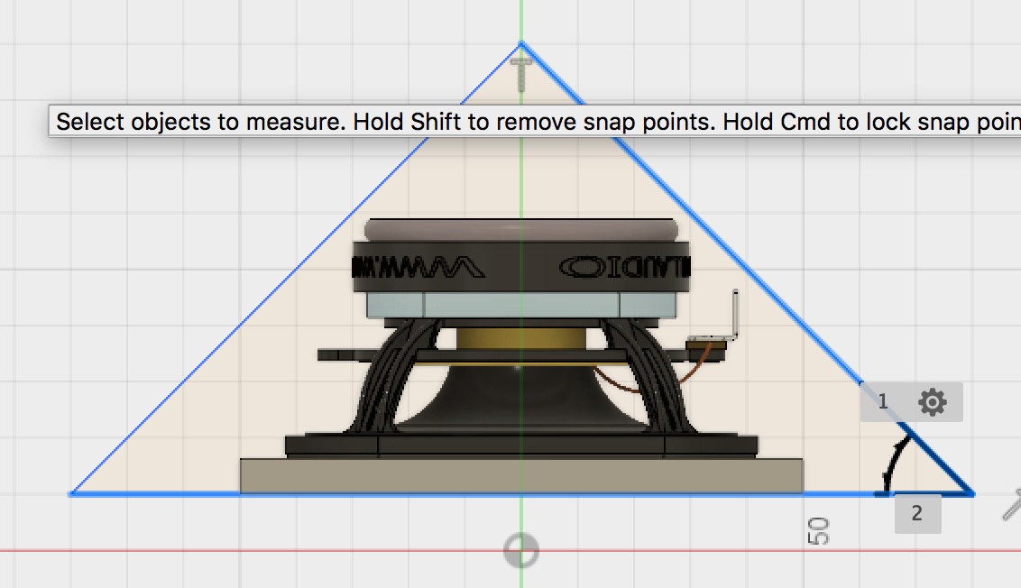

Looks like I need a front baffle of 160mm if the drivers are going to fit in the corner at all which is pretty close to what I had originally thought. But you can see how little room there is for the back wave. And actually, the magnet is more in the way than I had in my head mostly because I was using the Dayton ND driver with the tiny neodymium magnet for my previous mockups. But also, nothing was to scale previously.
I have the drivers mounted behind the baffle at the moment thinking that the 1/4" aluminum allows me to do the round overs without sacrificing too much strength between drivers. I really like the look. Downside is it steals more volume from enclosure and puts the back wave that much closer. I'm not sure it smooths out the response much? And there's a good chance I hide these behind grill cloth anyway so maybe the look doesn't matter much. Maybe I can pretty up the CAD sketch and convince my wife to show the baffle off. :D
Still pondering the whole building into the wall thing. Now that I'm trying out Fusion, maybe I'll lay those ideas out more precisely and that might help with the decision making.
