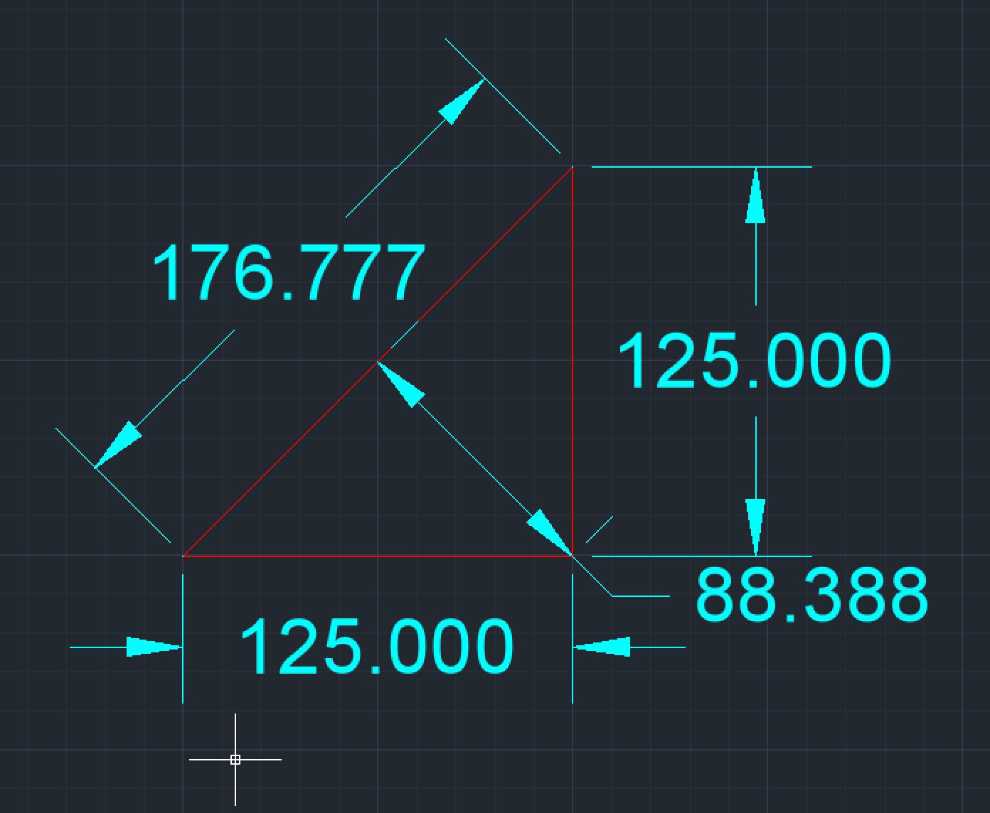

I think your maths is wrong or your remembering the dimensions.

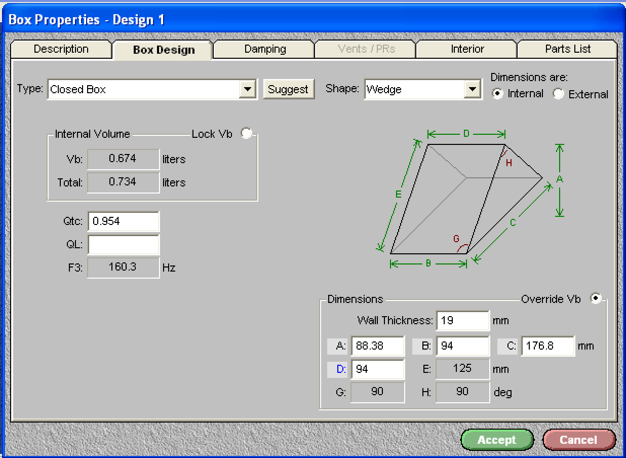

I have put this into Bassboxx Pro for you and also drawn it out in CAD to confirm the dimensions.
125mm sides leads to a 176mm baffle but only 88mm from the baffle to the point of the triangle which I think is very close.
It also leads to a much smaller volume, actual volume of 0.674L effective volume of 0.734 L when damping is taken into consideration. Q of 0.954 is a bit high. It is still doable with correction but not ideal. Also not bracing or structure in there so the end result will be worse.
I have used 94mm as the height of the enclosure as this is the height of your 93" divided by 25. Also remember that if you are going to separate the enclosures you want them to be the same volume and you can't do that if you have a bit more in the top and bottom sections.
attachment.php
attachment.php
Check my working but I think this is correct as CAD and Bassbox Pro agree, so does Pythagoras.
If you want to change any of the dimensions let me know as the programs will sit open for a while.

Well, this is embarrassing. I looked back at my hand sketch and realized that I scaled everything 1:2. I would have eventually modeled it upon finalizing the concepts but good to catch it now! Thanks for modeling. I was wondering why RA7s baffle looked so wide!

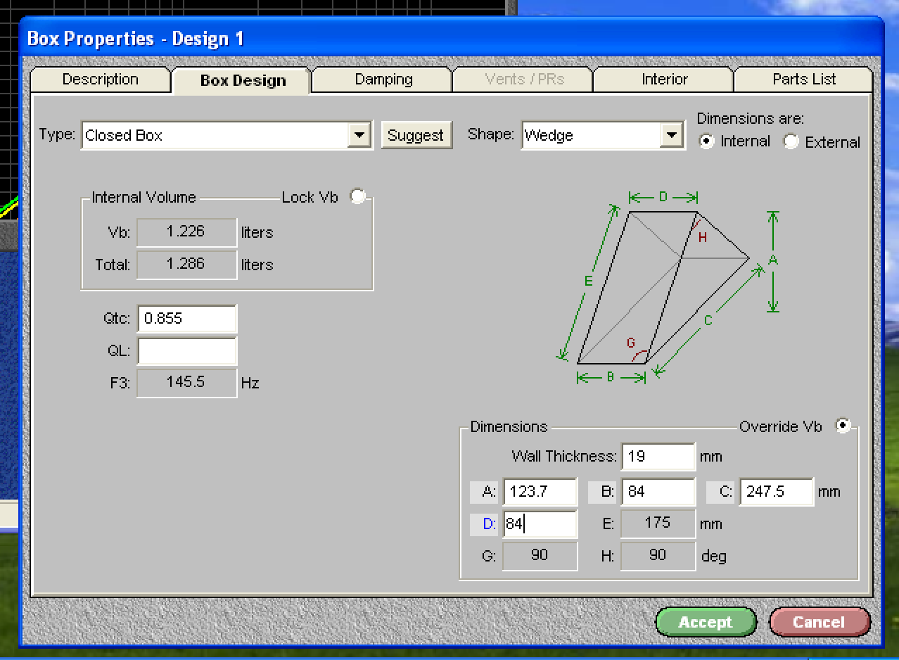

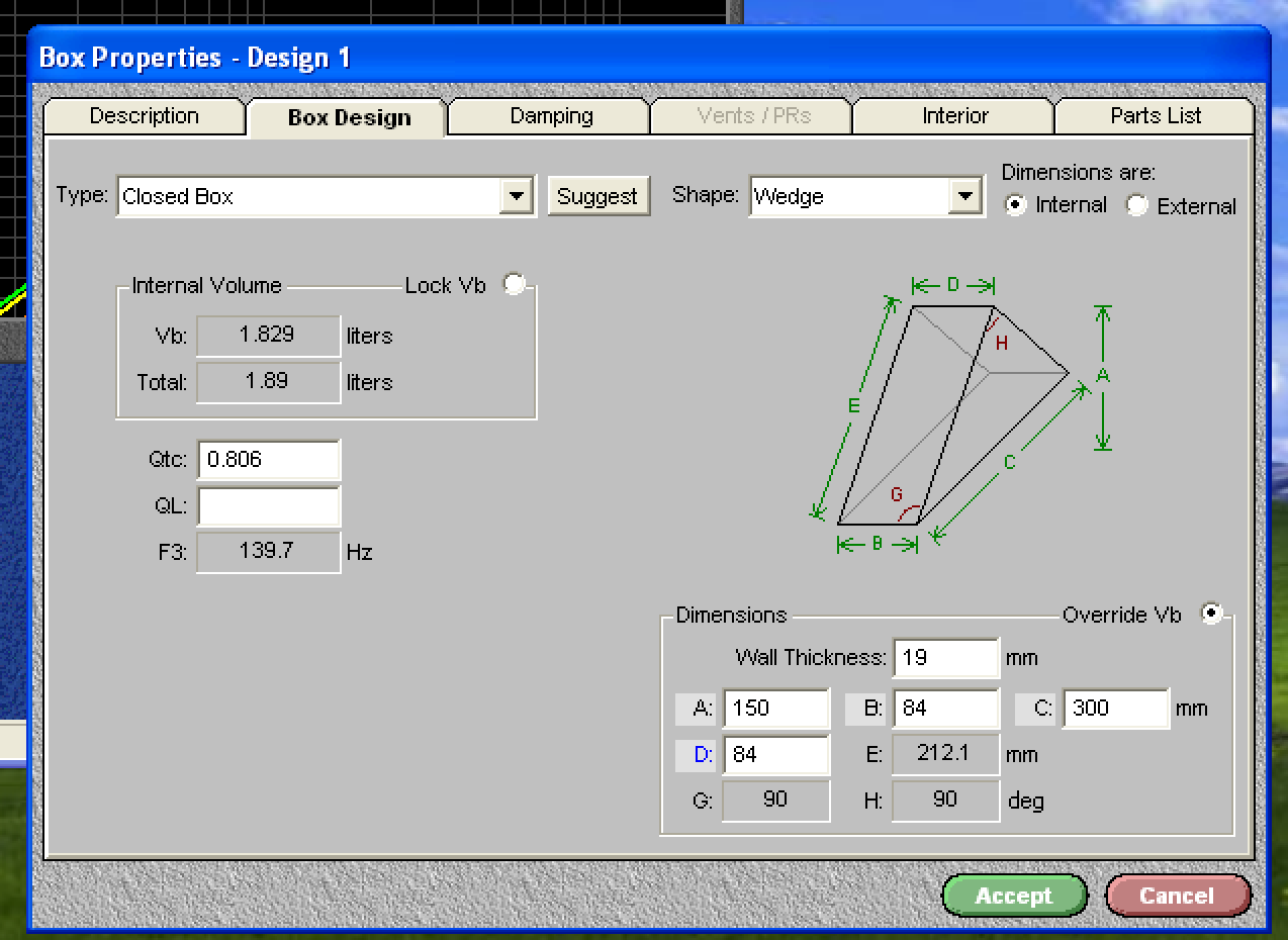

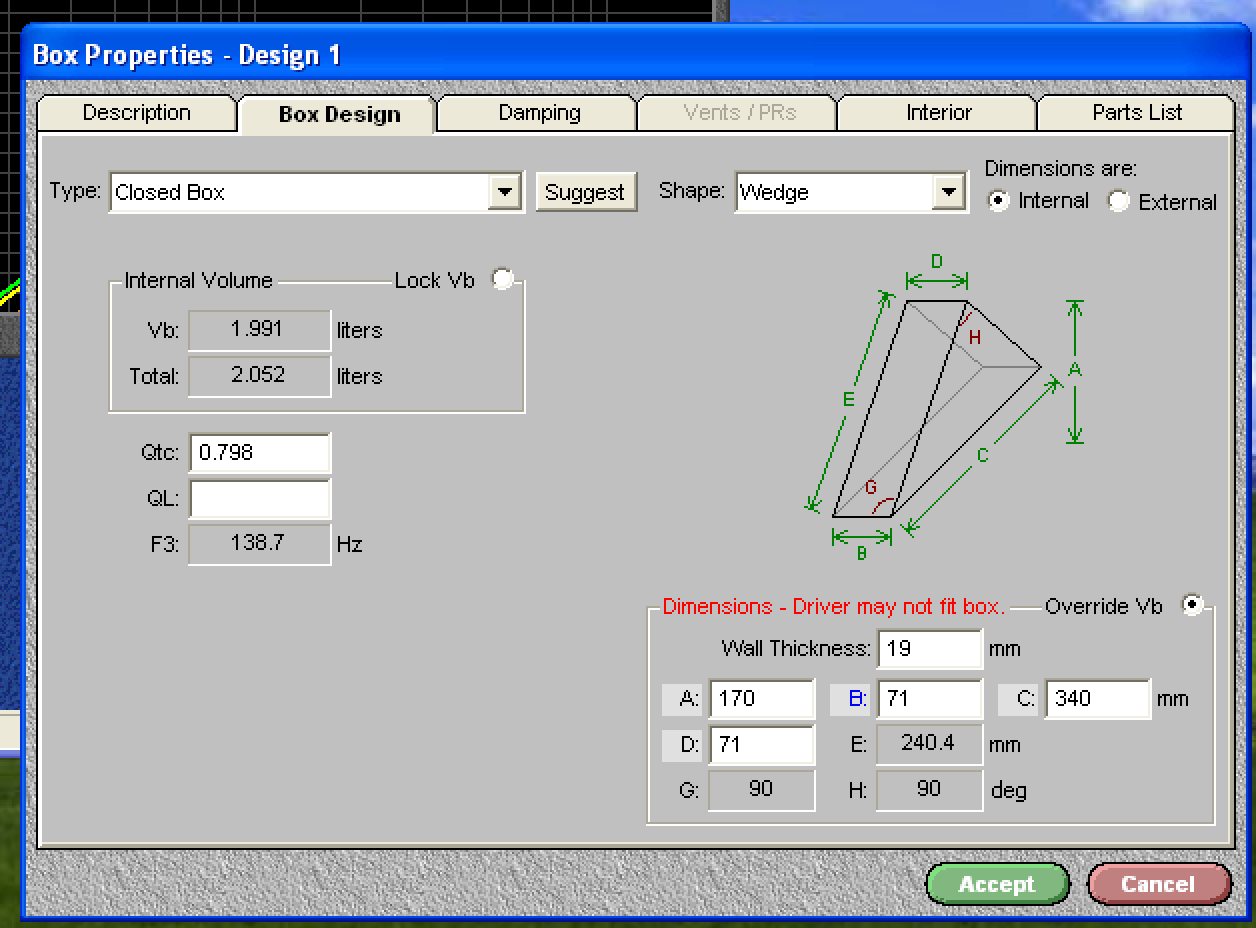

It is harder to work to an exact volume as I have to add the dimensions in by hand to make it work.
Here are a few options.
175mm sides 247mm baffle, 1.286L Q 0.85

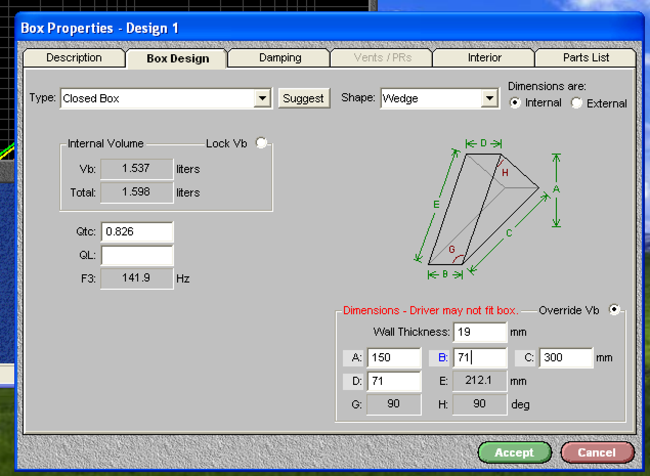

212mm sides 300mm baffle 1.89L Q 0.806
if you remove the volume for a 1/2"solid brace for each driver on a 300mm baffle you go back to 1.6L per driver.
To get to 2L with 1/2" dividers the baffle is 340mm wide wide 240mm sides. Pretty wide.

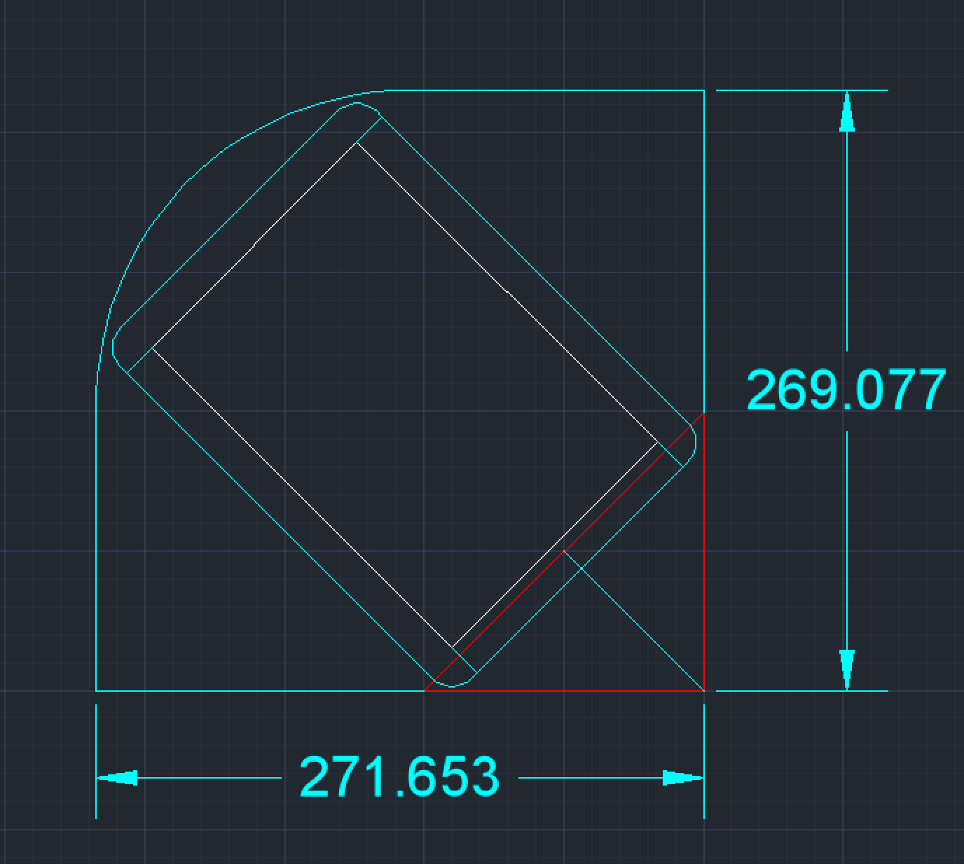

Here is an overlay of my cabinet dimensions with the 125mm red lines as before. the blue circle is an indication of where you could good wrap the fabric around, make it the same colour as your walls and it would pretty much disappear.

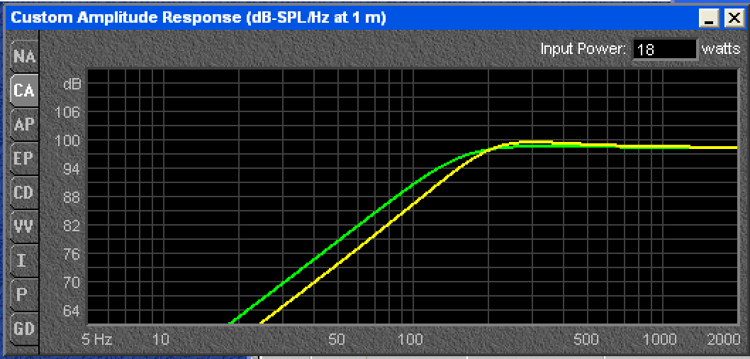

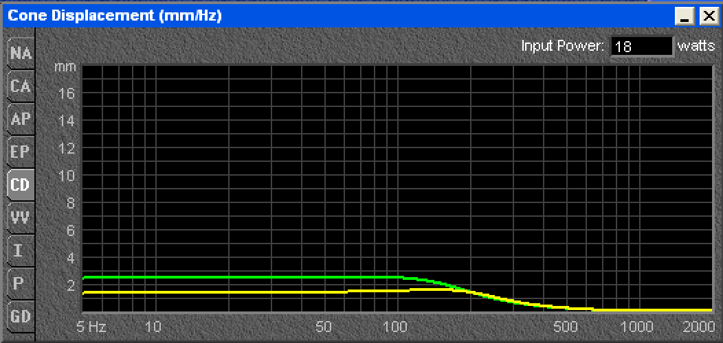

Here are some comparisons for cabinets at both ends of the volume and Q spectrum being considered.
Screen Shot 2017-02-08 at 9.42.51 pm.png Screen Shot 2017-02-08 at 9.43.08 pm.png
The green has a Q of 0.8 and has a very slight rise to the low end which is hard to see given the scale of the graph. A single driver is pushed to x-max with 18 watts. This is my cabinet modelled.
The yellow is the dimensions you gave to start with of 125mm triangular sides, 176mm baffle. Q of 0.98. You get a slight boost in output from the cabinet from mid frequencies down until you get to 250Hz then it starts to drop. From 100Hz on down you are almost 6dB less in output. The excursion is less so you can put in more power but to get back to the same point you need to put in 72 watts instead of 18 (x2 then x2). Two problems, first you are now way over the thermal limit of the driver and will cook it, this is only one driver so instead of say 250W to drive the 25 you now need over a kilowatt to get back to the same output. Second that is a lot more power and the amp may not perform so well increasing thd but you can't use it anyway because of point one!
This is how easy it is to think you can eq your way out of trouble unless you work out just what other compromises you make to get there.
The Fs of the TC9 is 125Hz sow however you use it you will be using it well below it's free air resonance. Wesayso's distortion seems OK to me. It certainly rises lower down, but most subwoofers are not actually that low in distortion anyway so to better the array by themselves will need a high quality low distortion woofer. For home theatre almost any sub would blow them out of the water as power is king for LFE.
