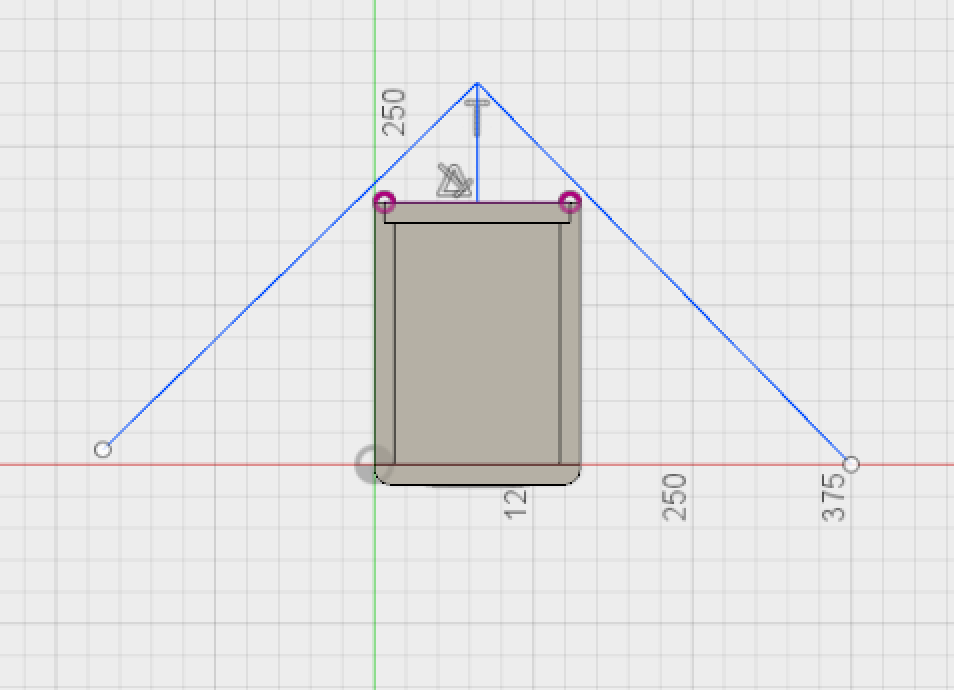

There are a few parts to this to consider for construction and then other considerations due to acoustics.
I doubt that 1.5" of 1/4" felt is enough to completely suppress the discontinuity between the driver and the wall. It is enough to significantly reduce edge diffraction but that is not the same phenomenon. I think wesayso is right that the only way to know will be to test it.
The image you show there doesn't seem to be a bad idea, but think of it like a horn where the driver doesn't quite match the horn, and you get reflection dips. Really early reflections (less than 6ms) are bad as your ear does not perceive them as separate and integrates them as the direct sound you hear making it coloured.
You could use an 1/8" layer to come right up to the edge of the driver and into the gaps to create a smooth surface and then put another layer of thicker material further away as you go outwards towards the wall. But do check on the price as that sort of pressed wool felt isn't cheap and you will quite need a lot of it due to the length of the lines.
I think that you either want the waveguide to start right at the edge of the driver basket or build in a bigger gap and fill that with damping material.
My suggestion before was more like this
attachment.php
Push the cabinet into the corner and then fill the space between the cabinet edge and the wall with a larger amount of damping like fibreglass or rockwool. You could use double sided tape or velcro to stick it to the edge of the cabinet and the wall to hold it in place. Putting fabric across the front could be done in many ways. You can then angle the cabinets to suit your listening position and adjust the damping.
That is my cabinet so I didn't have to draw a new one, but you could make it any shape you want.
One think to remember about constructing the cabinets is that they will be awkward, long thin pieces of material are a pain to work with. If the baffle is made out of any kind of wood when you cut the holes in it it will have no strength face on until you fix it. The panels need to be lifted on edge or they will bend and split. I have a whole set of them and they bend even more than I thought they would.
The aluminium baffle wesayso used has a benefit in that the material itself is much stiffer even with the holes cut in it.
As this is a sealed design it needs to be almost airtight. With edges over 2m long it is difficult to do. If you have great tools that can cut perfectly then it is easier but any deviation from flat will make it harder to seal. The cabinet internals are not that large either so getting in to put some sealer around the edges is harder than normal. A triangular cabinet is hard to join well as the 45 degree edge is awkward to screw into and end grain to glue against won't hold well by itself. A biscuit joiner with a 45 degree fence and band clamps would work well though.
I like this idea. I would need about $50 worth of wool based on the 2 minute search I did for one 3/8" layer. Another $25 if I doubled up further away from the driver. And perhaps overlapping with the joint at the wall.
attachment.php
I understand what you're saying. Thanks for the idea. I don't think I can convince the wife to allow that much of a presence... she's already not super happy about floor to ceiling speakers. ;)
As you have some time you might as well think over and do it right once :D
Like this?
Yes just like that, check that it is actually wool and not some man made fibre as polyester is a really good reflector of sound and not what you want.
If you make the cabinet small enough and put fabric over the front of the whole thing how will it look any different?
Thanks for the input. Since I'm front mounting now, I'm thinking I'll make the baffle 3/4" birch ply. If it seems too wobbly, I can have two 3/4" square "stiffeners" along the length centered on each side of the baffle. And perhaps also some side to side window bracing too.
3/4" birch ply is good, but it will still be extremely wobbly, the strength of the ply is the cross laminations, when you cut holes in it it has no strength in that direction. Once it is glued and fixed it is no problem it is just being able to manoeuvre it into place. Roger russell in his article recommends cutting the driver holes after the cabinet has been fixed for that very reason. Also the thicker the material the more you need to relieve the area around the cutout to let the driver breathe. This makes it even more wobbly...
