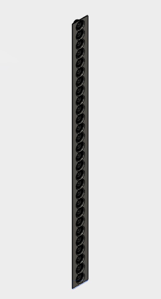

"Wall-integrated" corner loaded line array with Vifa TC9 drivers

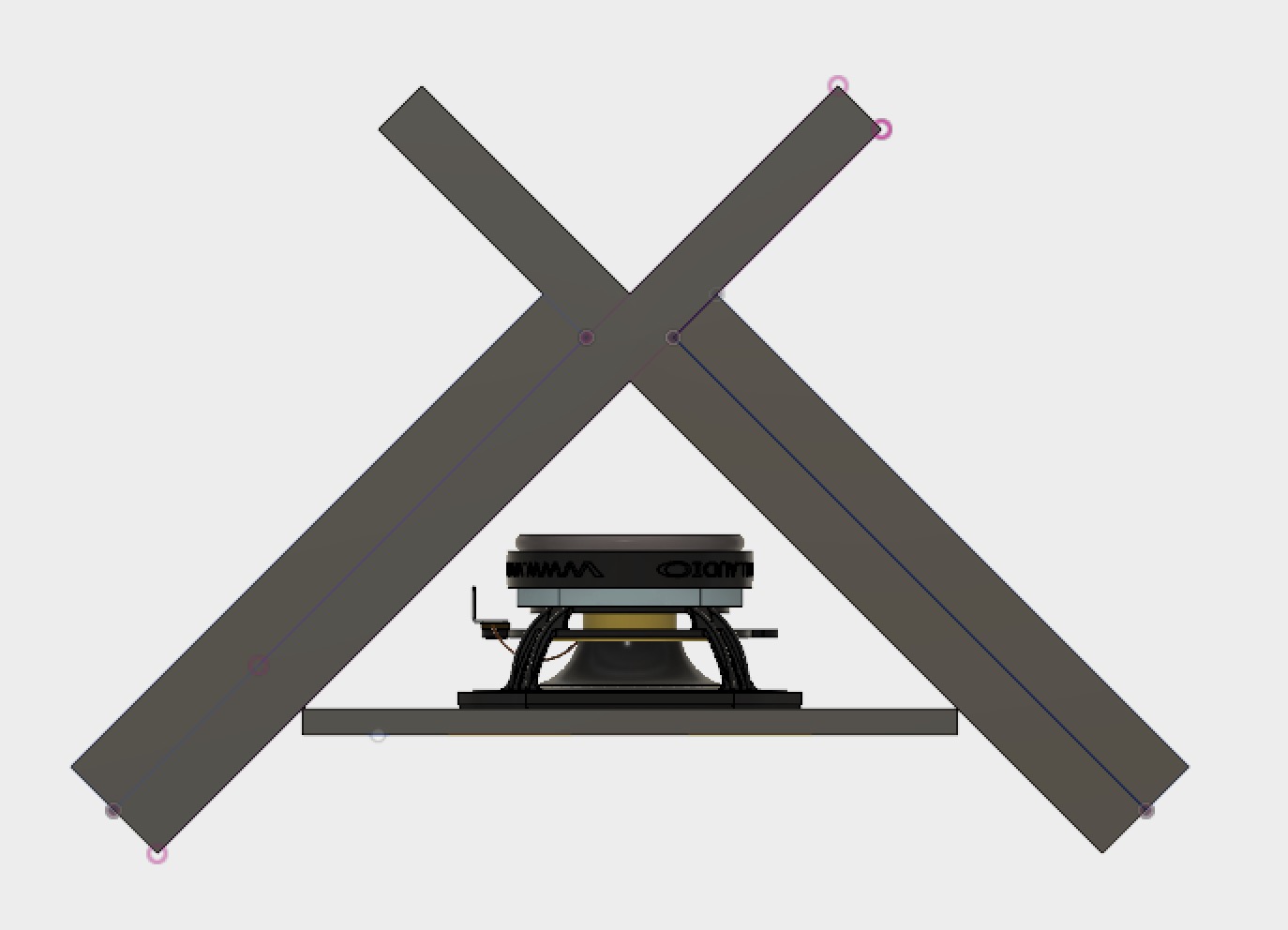

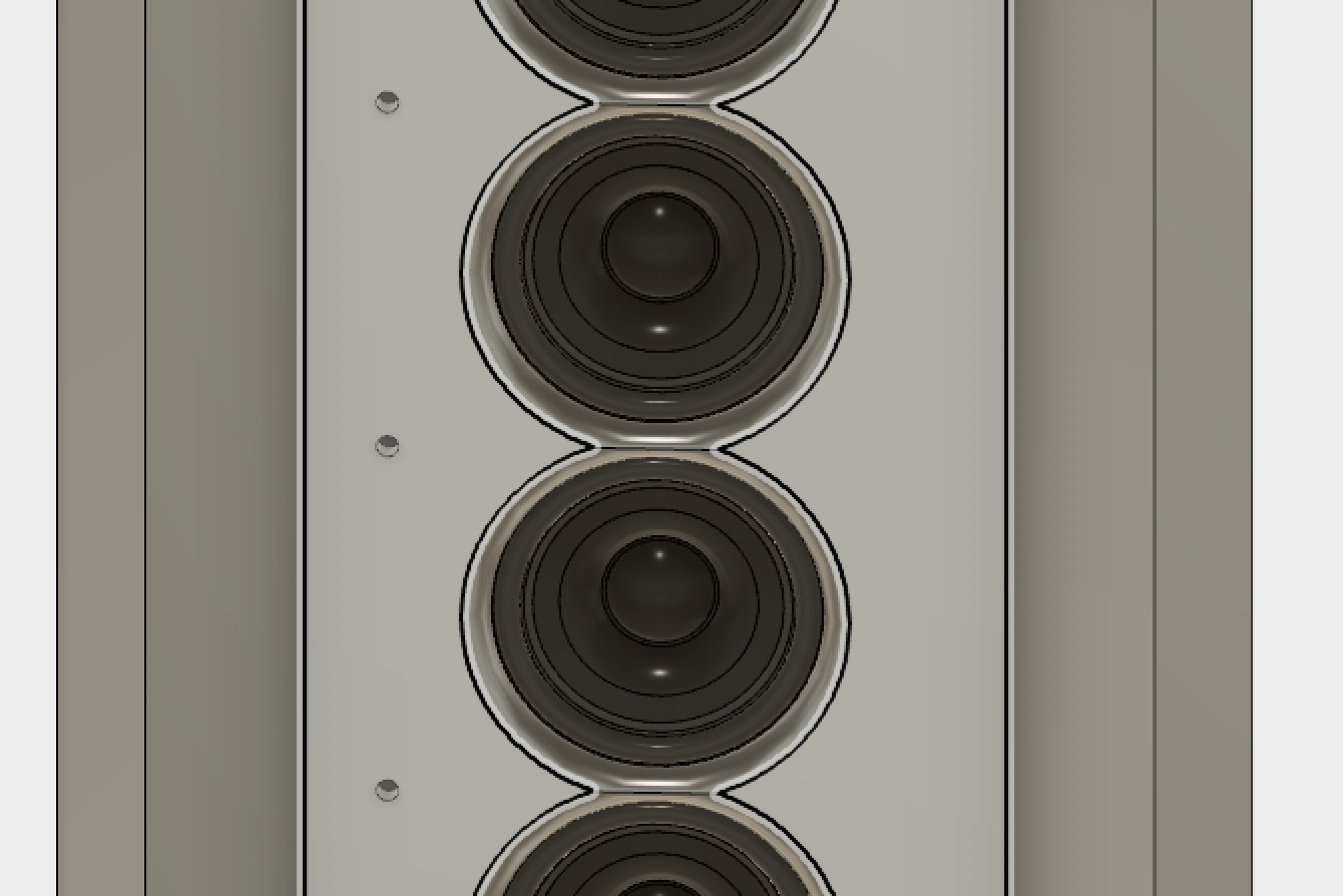

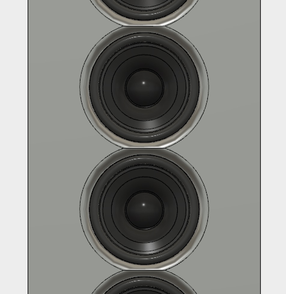

Here's a shot of the entire thing with 28 drivers and at 160mm across.

I put the walls in just to illustrate scale. I also tried to position holes for the screws that would attach to the walls. I think they're too far from the edge though. They look ok from the front though.
Next step is to try putting holes in the walls that would help with the back wave and also lead to the additional volume.

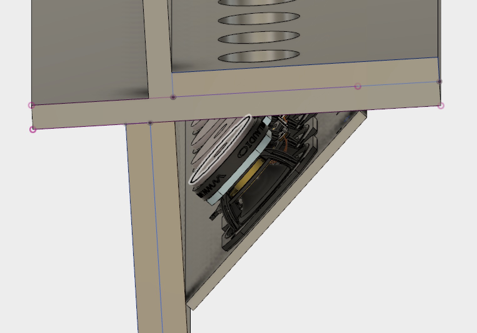

Good work with Fusion 360, it certainly helps to show just what any baffle arrangement and distances will look like.
To mount the aluminium you will probably need to use a triangular piece of wood. Screw the wood to the wall and the baffle to the wood with a layer of neoprene between both. Not easy to drill through aluminium on an angle like you had shown before. Possible but not easy, the number of holes and the size of the plate would make it that much harder too.
The primary issue with the backwave will come from the triangluar corner directly behind the driver this will end up being the shortest distance for the backwave to hit the cone. Cutting holes in the wall will not make this any better, only more distance or better absorption in damping will do that. That is the last time I will mention that too.

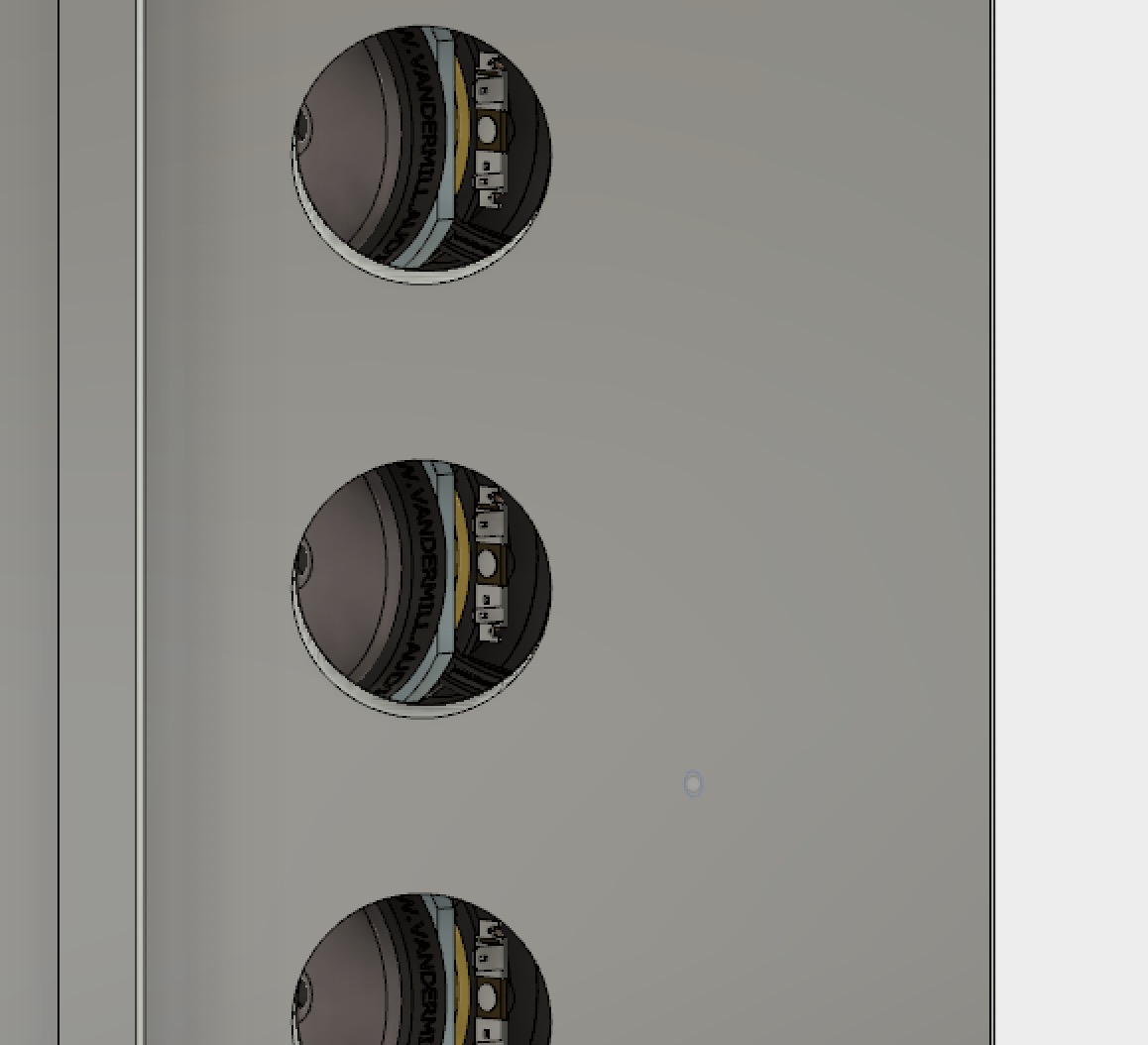

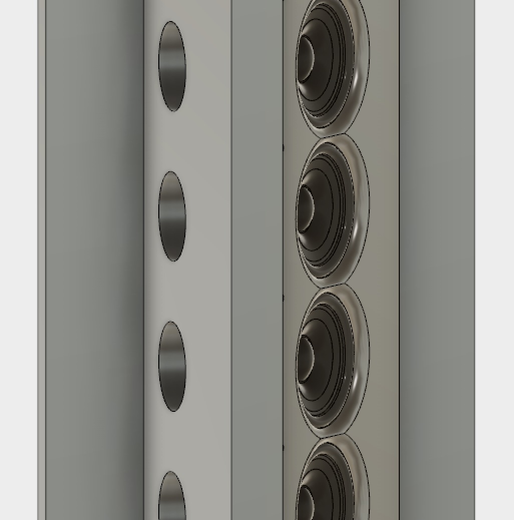

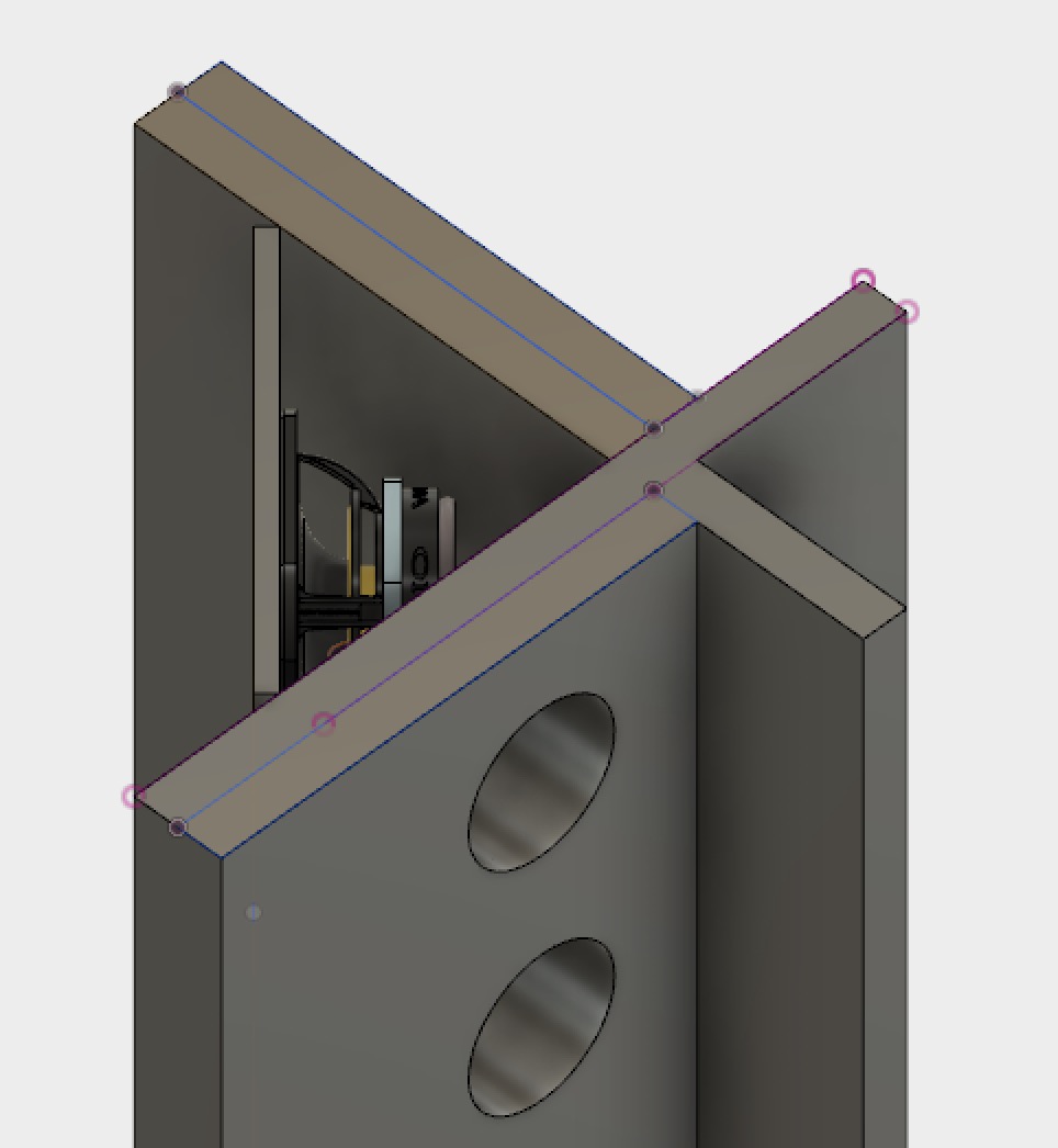

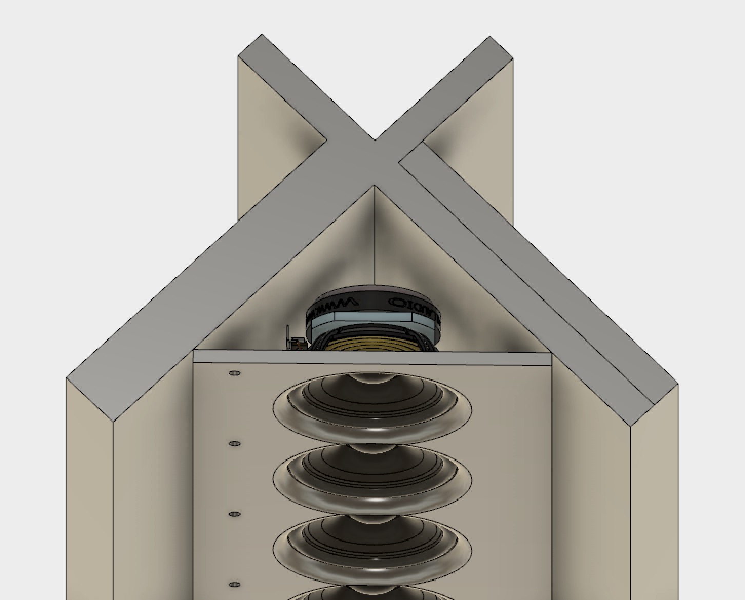

Sorry for the slew of images... I'm on a roll! These show 2" holes to one side of the drivers.
For the holes through Aluminum, I agree those should be square to the face. I will likely use those holes to drill pilot holes through the walls. And I was thinking the same on the neoprene or some other damping material. If I do pilot holes, I don't think I'll need the extra piece of wood.
On the back wave, I was thinking that behind the driver actually wouldn't be as bad given the size of the magnet. I agree that it's not ideal regardless since it's so close. I also only have those 2" holes on one side of the rear but I could do both sides I suppose. Just more work is all. And I disagree that they won't help. Would not some of the back wave energy get dissipated through those holes and the damping that will be on the other side of the holes? It's not ideal and I'm not sure how much it would help, but it's something.
The magnet will shield the back of the cone to some extent. It's not really the overall energy but discrete reflections arriving off reflective surfaces and not being fully absorbed in the damping that causes the problems. Remember also you have many drivers in a line producing the same program so the reflection may come from the back of one and pass through the cone of another. I've tried to give as much information and reasoning for my position as I can. If you disagree and are sure you understand the acoustics go for it, you are the one building it.
I have my own build to get on with so the proof of the pudding will be in the measuring and listening :)
If you are willing to cut holes in the wall behind the baffle, you should be willing to remove the drywall behind them too? The more open right behind the driver the better.

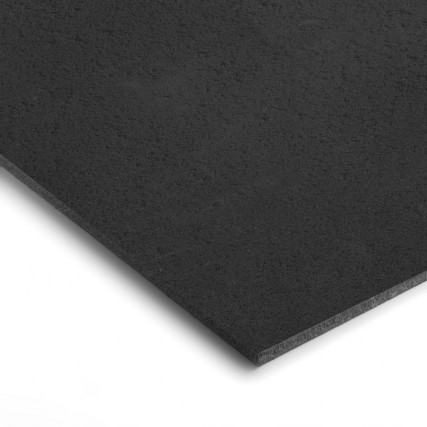

Are commercial vinyl tiles similar to mass loaded vinyl? Seems like they might be easier to cut than the vinyl. And perhaps cheaper too. But unclear if the damping properties are worse? I was also thinking bout whether there are other options that are silicone or urethane based that might be more dampening?
No they are much lighter, they don't have the mass. The mass is provided by impregnating minerals of different kinds to increase the weight and density.
Look at car dampening / sound isolating products, they usually come with a foil side and an adhesive side. There are others that have MLV attached to a layer of foam. They are heavy so the shipping can be expensive but the product can be bought fairly cheaply if you can pick it up locally.
Things similar to Dynamat, Silent Coat or many other trade names.
These give you dampening by providing mass without stiffness which is good for damping the baffle and will provide some isolation if you use it between layers.
To isolate the baffle from other objects neoprene or similar will do a better job.
Are you isolating the drivers themselves from the baffles too? I was thinking either the MVL or similar between the drivers and baffle. And then something to isolate the drivers from the screws like the post in the other thread via oring or similar. Then isolating the baffle from the wall in a similar fashion. i.e. with neoprene between baffle and walls and again, some oring between the screws and the baffle.

You could do it like that, remember that the MLV is better at damping and the neoprene is better at isolating. The neoprene is squishy and lossy. The MLV is solid and heavy.
MLV is often used as a sound barrier. In cars it's often used with neoprene underneath to block (outside) sound.
Neoprene (and maybe even better, sorbothane) is used as an isolator.
Butyl damping mats with alu foil as a (CLD) damping material.
I used MLV on my baffle to weigh them down, make them heavier. It's not a flexible material and it doesn't work as a CLD layer between two stiff materials. Butyl would be way better at that. I've tried MLV and neoprene between both baffles I use. I stripped it all out again and replaced it with butyl rope to gain damping. A measurable improvement.
Look at MLV as being effective as a sound barrier. Or a means to add weight. If you compress it, it won't return to its original shape. It works even better if isolated (for instance with neoprene) from the "wall" it's used on.

To give an example of the MLV I use:
Bestel Isomat TS geluidsisolatiematten direct online op Akoestiekwinkel.nl!
attachment.php
The 3.2 mm thick Mass Loaded Vinyl weighs 8 Kg per square meter (!)
The thicker 5.7 mm weighs 14 Kg per square meter (!)
Mostly used as a sound barrier, with excellent results. Look at this pfd file to see some graphs (sorry it's in Dutch)
