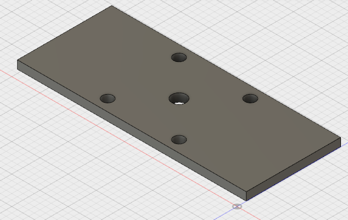

Drilling jig model. 1/2" aluminum to match drill bushings, 8" wide to match the baffle width. May also include holes for the mounting screws. But those do not require precision so I may just do those without the drill bushings. Width matches the width of the drivers so I can mark the spacing and position the jig appropriately before clamping.
Note: the holes are sized to accept the drill bushing outside diameter. The center one will hold a bushing for a 1/4" drill, the others for a 5mm drill.

I'd add way more into such a template. I opted to include the holes for the baffle bolts spanning 3 drivers, to be able to do a number of things with them. If you take care and use a drill press or similar the bushings won't even be needed. Just use plenty of WD40.
Include a ~3" hole to be able to do your roundover with a bearing bit following the template.
I had 3 different sized holes in mine, one for the driver opening, one for my roundover router bit to follow and one for the holes in the back baffle. Plus 8 mounting holes for the baffle and I later drilled the tiny holes for the drivers themselves (I figured they might be too small for water jet cutting).
(as you can see I replaced the bearings with a fixed pin, the bearings exploded too often :eek:)
This simple though effective template was also used to drill all mounting holes.
(in one baffle, which then was used to drill the holes in it's partnering baffle)

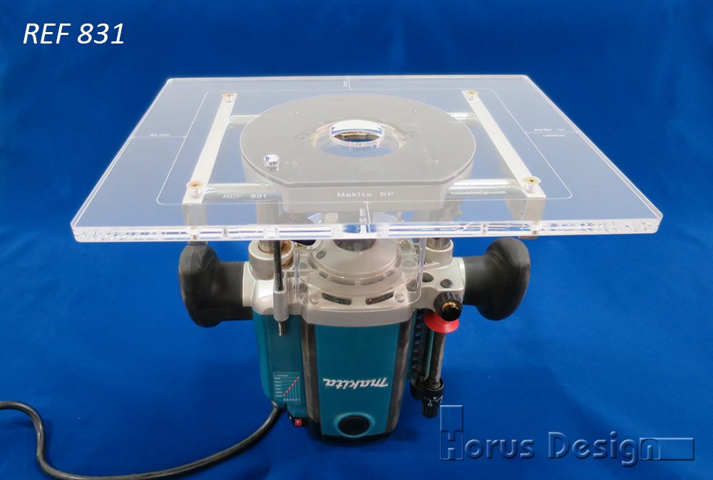

What is going on with the red/orange L-bracket? Is that a platform for your router? I didn't see the router behind it though so what is that bit attached to?
Also, did you route out all the holes vs doing a hole saw?
I was going to make the holes in one baffle as the router bit guide for the round overs in the other baffle. I've never seen bearings blow up like that and didn't know you could replace with a pin. Is that a standard part or did you have to engineer that yourself?
The bits I used were meant to cut wood, not aluminium. With WD40 cooling they did a wondrous job, except for the bearings.
They got heated too much, even when I got a transformer to reduce my (static) RPM's. My router does 18000 RPM standard.
The pin thing is the best I came up with, it worked very well.

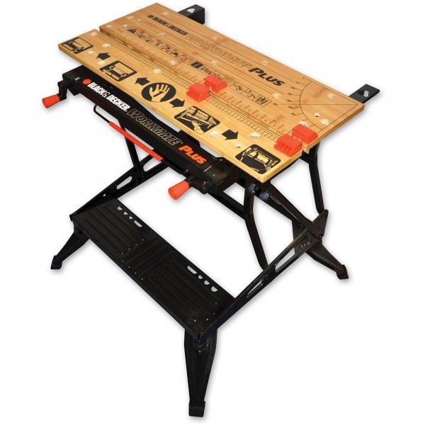

The L shaped bracket's task is to hold the pin where the router bearing used to sit. I'ts just a pin in the right diameter I needed (salvaged from an old chair). I've even used wrench sockets for a temporary right sized pin :D.
The router hangs upside down under the table, only the router bit sticks out here.
I didn't use a hole saw, just a jig saw and I used the router to get the holes to size with the templates. Very repeatable and exactly to size.
Here's a clear view of the table showing another router bit. The Router itself is bolted to the table at the back using it's side guide system. You can see the bolts that hold it. The table consists of a workmate and clamps the router, with a piece of multiplex as the table top.
attachment.php
The router is clamped in this table while being bolted down to the multiplex. Instant router table!
Mounting looks a lot like this (using the side guide system that came with the router and a few pieces of wood):
attachment.php
That orange piece as you call it is just some scrap L-iron I had laying around mounted on the remainders of the jig sawed holes scrap pieces (used as spacers) to be able to mount a pin exactly above the router bit. I welded on the "L" shape to keep it stable in all directions.
Use what you have is my motto.

Ah, I see now. That's a clever setup. Was the hole saw approach not precise enough for you? Or was it just a matter of being comfortable with this technique since you needed to use three different 76-ish sized holes?
It's that last answer. I needed 3 different sized holes to accomplish what I wanted. I used what I had on hand, having more time than money at that point in my life.

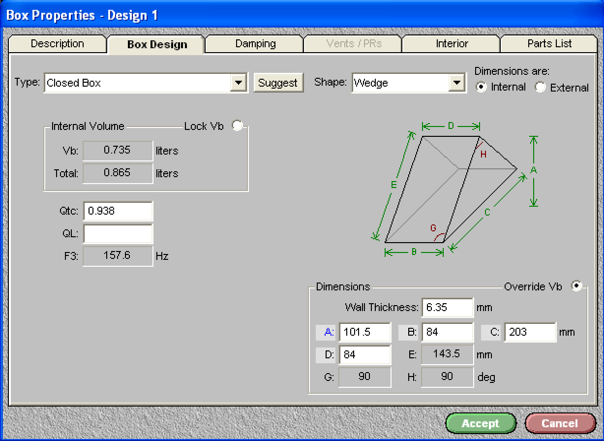

That dimension with a 1/4" baffle will give you this.
I think that is enough to allow you to get down to between 20 to 40Hz with EQ but you lose a bit of output volume potential. You have a couple of pretty big subs so you should be able to get that back by relaxing the eq when the subs are on. I'll run a sim in Jeff bagby's woofer designer as that has a linkwitz transform simulator. Room gain and corner loading won't be included though so it isn't a complete picture.
I said I would do this and didn't have time until now. Woofer designer did not work well with the TC9 the volume and Q came out all wrong but the Linkwitz transform prediction is still valid as a relative measure between the enclosures.
I entered the F3 and Q numbers from Bassboxx to show the difference.
attachment.php

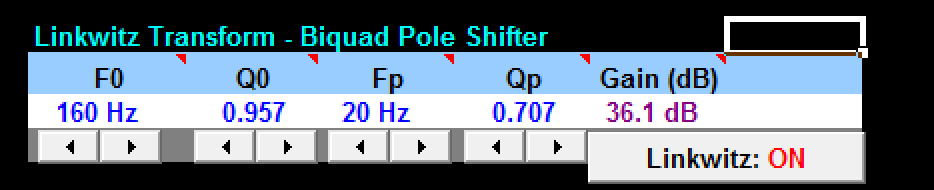

With a bigger enclosure ~2L F3 is 140 and to equalize that to 20Hz means you lose almost 34dB in maximum output from the EQ.
attachment.php

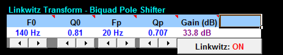

With your proposed size F3 is 160 and getting to 20Hz takes a 36dB loss so overall you lose a little more than 2dB of output potential by going with the smaller cabinet, so it will take almost twice as much power to get back to the same level. The driver won't take that power however before reaching it's thermal limit.
The maximum output will be different for the array due to the extra drivers and boundary loading so the dB figure is only useful in a relative sense.

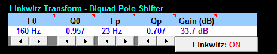

EQing to 23Hz gets a very similar figure
attachment.php
So you could EQ to almost the same target but you couldn't turn it up as loud without reaching the thermal limit due to the way the smaller box loads the drivers. You burn more amp power in the drivers as the cabinet is less efficient.

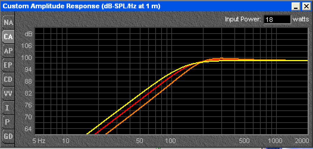

The TC9 has a very high Qt at 0.89 which means that it takes a very big box to get to a Q of 0.7, 10 litres per driver in fact. This is too much as puts very little loading on the cone. This is the wrong driver to get a low Q response from.
Generally 2 x Vas is about as big you would want to go. Vas is 1.24L so 2.5L per driver is about as much as you need maximum. This is the reason most settle somewhere around 2L as it is really the sweet spot with this driver.
This shows the difference between 10 litres Q 0.7 in Yellow, Red is ~2L at Q 0.8 and Orange is Q 0.957.
attachment.php
The cabinet Q sets the rolloff shape which can be changed to whatever you want with EQ, bearing in mind the more EQ, and the more it resembles a Q=0.5 type rolloff the more headroom you lose as before.

Ah, I see. I didn't realize that it would be so exponential. I'll target for somewhere around 2L. Exact volume will likely depend on construct-ability. I assume it's ok if the left and right are slightly different since I'll EQ separately? Plus, maybe I'll end up like wesayso with slightly different curves left and right. Unlikely to be very much since my room is pretty symmetrical. But separating them can't hurt, right?
