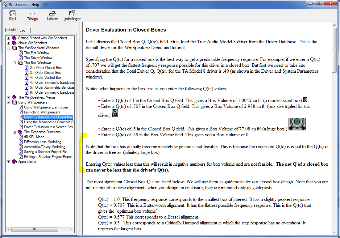

Huh? The 0.89 was measured in an IB, right? Can't a box only raise the Qts from that point?The TC9 has a very high Qt at 0.89 which means that it takes a very big box to get to a Q of 0.7, 10 litres per driver in fact.
The 0.89 is the Manufacturers spec and I would think was measured on an IEC baffle, (big, not infinite) but it isn't specified in the datasheet.Huh? The 0.89 was measured in an IB, right?
I don't think that the manufacturers spec can be considered the same as a true infinite baffle which is the only way what you say there would be true.Can't a box only raise the Qts from that point?
If that Q resulted from an infinitely large enclosure then obviously you can't then increase the box volume to lower the Q. I would think that the Vas would be huge too which it is not.
All the modelling of this and similar drivers together with actual measurements of enclosures show that fairly small enclosures (2L) can lower the Q from the manufacturers spec.
Help file for WinSpeakerz claim The net Q of a closed box can never be less than the driver's Q(ts) although its possible to ask for Q(tc) set as say 0.707 for TC9 driver result is box volume goes negative.
Seems make sense when not long ago had high Q(ts) TC9 on same ~160x120cm OB verse low Q(ts) 10F.

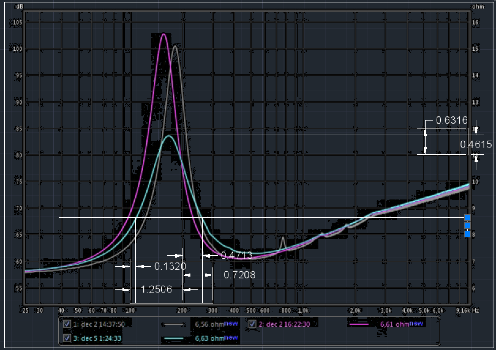

Byrtt,
I think I have a reason as to why all of this can be correct even though it might seem contradictory.
Qts of a driver is the total value of Q (mechanical and electrical) at the resonant frequency. When you put it in a box the effective resonant frequency of the driver changes and therefore the Qts of the driver at that resonant frequency will be different.
To illustrate that the actual Q of the combined cabinet and driver can be less than the manufacturers spec, and to prove it to myself see below.
I have done some calculations based on a chart wesayso posted of his impedance.
I put this into CAD so I could draw some lines to find a fairly accurate figure for the frequencies and impedances I need. If the original file was still available in REW then more accurate figures could be obtained.
This shows how to calculate the Q of the driver and enclosure together from the impedance measurement.
http://www.linkwitzlab.com/images/graphics/f0Q0.gif
From the drawing I have
Rmax =11.73
Rdc = 6.32
sqrt of rmax x rdc =8.61
gives
F1 = 110.56
F2 = 265.38
F0 = 171.29

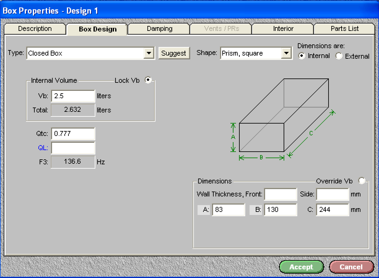

Put those numbers into the Q calculation and it comes out with a Q 0.77.
This agrees completely with the figure bassboxx gives for a heavily damped chamber with an effective volume of 2.6L.
Maybe I am wrong but to me this all makes sense and allows for all of the above comments to be correct when viewed from the correct point of view
Good points and nice piece of work
