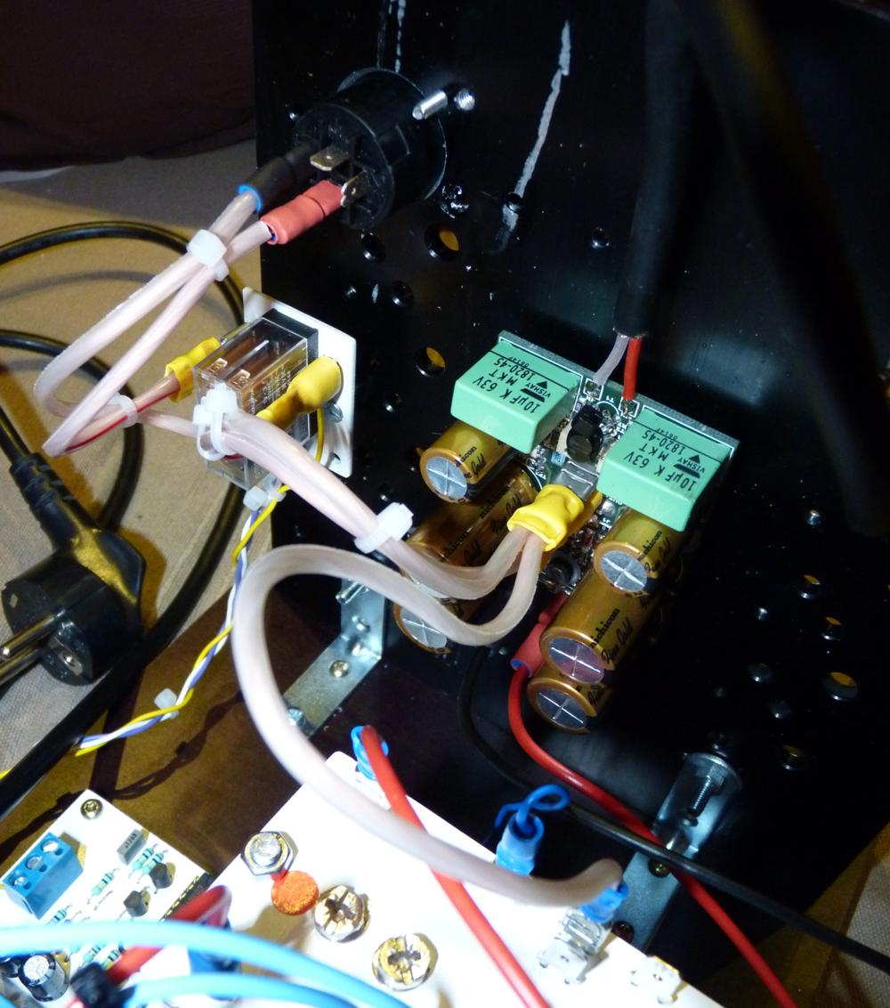

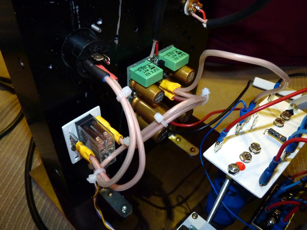

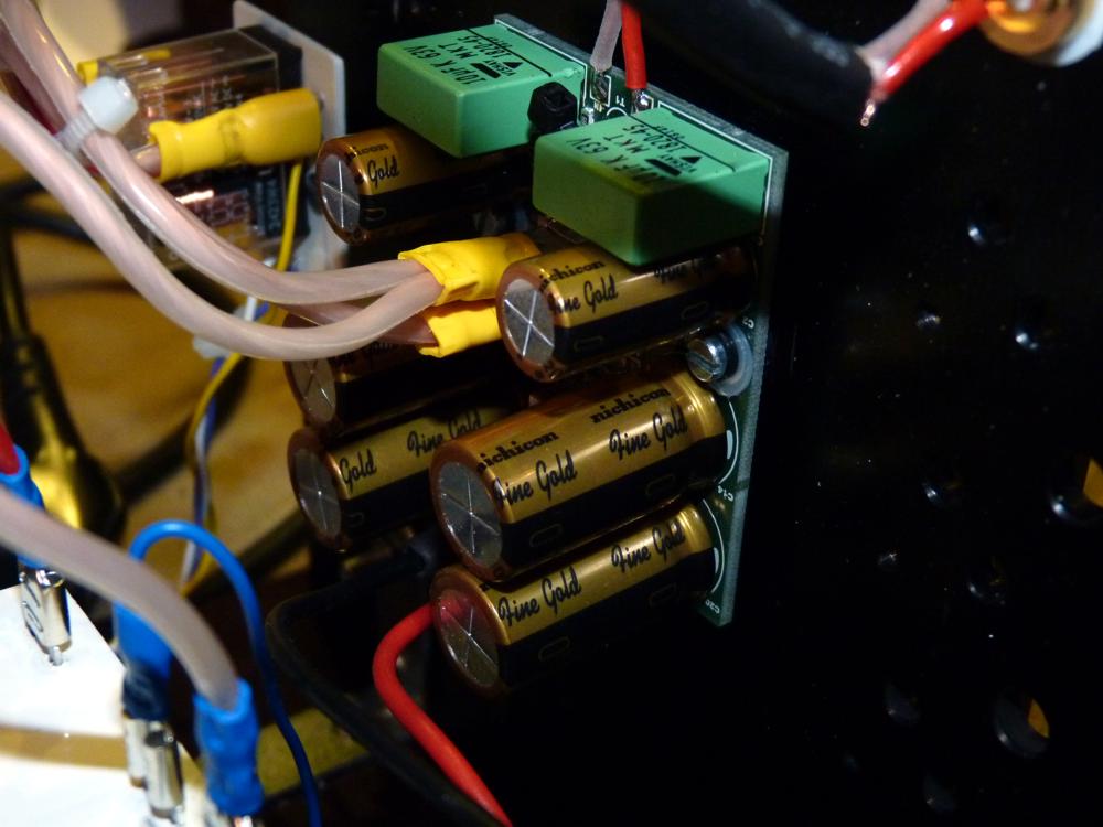

This morning i go foward to stage "ready to adjust" for the first chassis test. The second is on way but still need a little more work. On last serie picture my 22R pactch wire for first power on...
Marc
Expect no troubles if you'll follow the instructions and grounding schematic.
I follow them? You can follow the speaker "-" return path on picture above
=> speaker terminal=> VSSA GND=>PSU GND
Marc

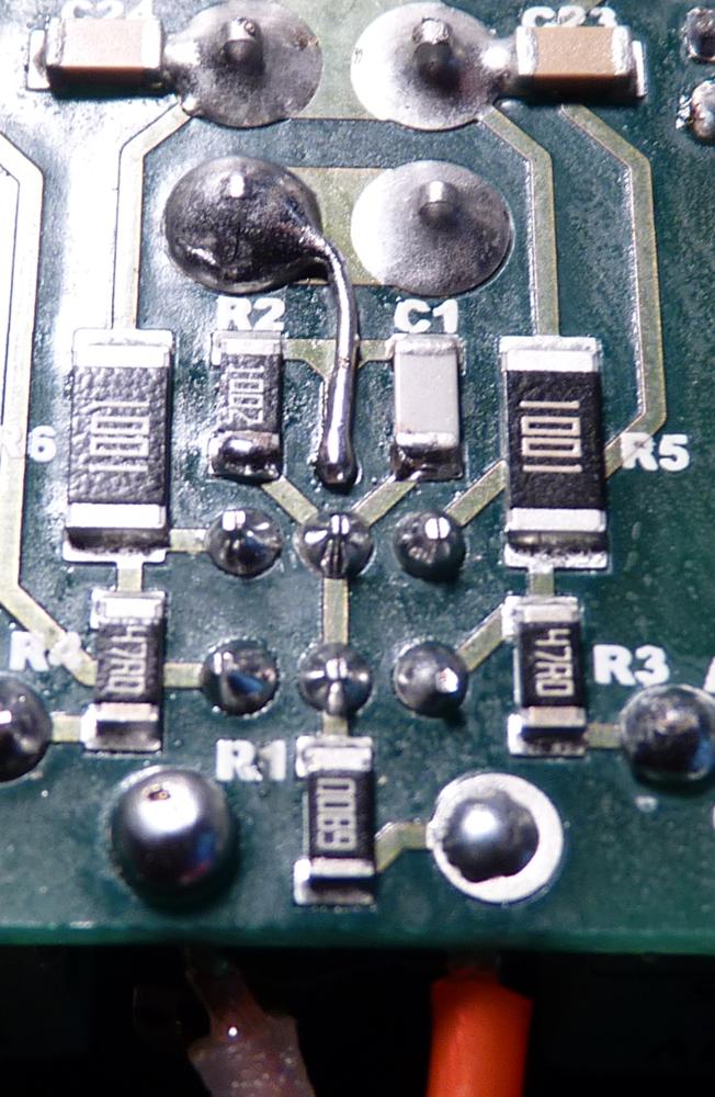

It's OK, it goes to central GND. You should also shorten R23 10 Ohm resistor.
I think i miss something about "this R23"...
Marc
I saw this schematic...do you speaking from the earth case connection...mine comes from caps rank and not from VSSA GND...The 10Ohms i have here is for test 'this just a test chassis) and can be shorten simply by plug earth chasis return on a faston spad befor the 10r.
Marc
Marc
Yes you could do that way too, as tested it has to be shorted with short wire i.e. from - IN to GND on VSSA PCB.
I just went to basement to see were this R23 lay....Just for validation : it can be shorten by a wire under pcb beteween gnd spad and a little via hole not so far from spad...
Marc

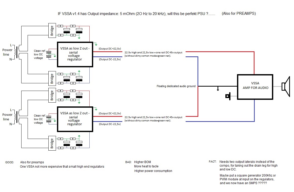

Voltage regulator suggestion
Hey Andrej and others
Because of the output impedance data from installation manual i have been inspired to do serial voltage regulator suggestion.
Please take a look in image and see if it is possible, hope not it is silly.
BR Ricky
BR Ricky
Your PSU is like to be for MM/MC preamp or for some very exotic electronics.Hey Andrej and others
BR Ricky
Please do not understand me wrong, technically is perfect, only a little overkill for VSSA don't you think hehe
Some regulated SMPS could also be OK but if you wish to try it, I can only suggest you to go for it.
