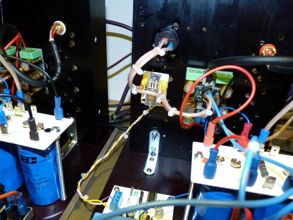

Day one : After some little nightmare due bad solder join on DC speaker relay card both chanel sing....some picture later..

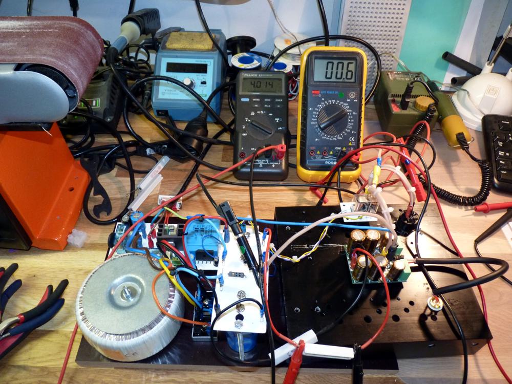

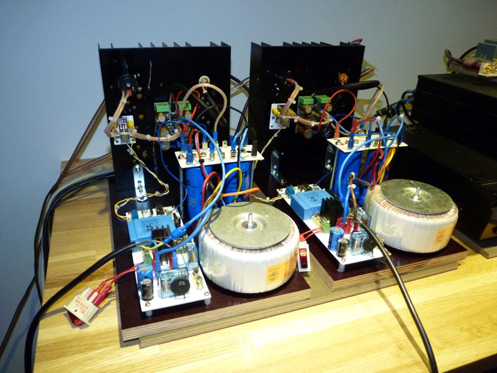

VSSA is running since 2 hours non stop.
I placed it in my current setup
- Philipps CD723 as drive on digital output
- TDA1541 DAC
- Preamplifier DIY UGS : ugs - audiyofield
- DIY Bookshelfs speakers (Troels gravesen project) : lifa - audiyofield
My listen room is in my basement house. It mesure 15m² and is quite good for bass reproduction.
Some pictures :

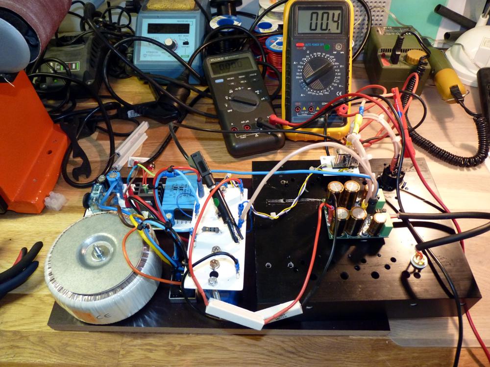

- 1 : Cinch with + and - soldered for adjuesting session
- 2 : Vas bias and offset adjusting
- 3 : ouput bias adjusting
- 4/5 : VSSA in my listening room

So my version is Crappy one : no hightech aluminium box, really crappy heatsink, no SMSPS or capacitance multiplier, non CRC nor CLC, no hightech rectifier diode just a 300Va 2x25Vac per bloc coupled at two 35A rectifier bridge, and follow with a good 22.000uf/40v screw cap per rail....
And even with no breakin this puppies are terrific...I have as many people my fetish music stuff that i listen more than 10 year long and that give me right some flags on what the system is capable....I say you these puppies are unbelieveble : details of course, bass line (grrrrrr dry as they must been but deep...and i have only a 14cm woofer...). One thigh that suprise me the most are the weigh of silence...it's quite diffcult to explain but when more time when sound is not so clean even during silence you have impression that somethings playing....
These puppies must yet take more breakin and me more pleasure time. Thanks LC for this present.
