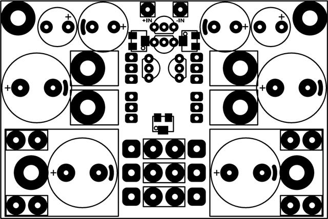

First One Mosfet Amplifier
Here's just a preliminary shot of a First One Mosfet Amplifier PCB just in development process.
Some "must" features expected from the First One amp:
- 100 Wrms/8 Ohm, 200 Wrms/4 Ohm, 220 Wrms/2 Ohm
- same 3 Mhz/-3 dB bandwidth as in VSSA
- SMPS400A180 power supply per channel
- 2 Ohm normal operation
- 75 x 50 mm dual layer PCB size, copper metalized up to 110 um
Expected group buy in September.

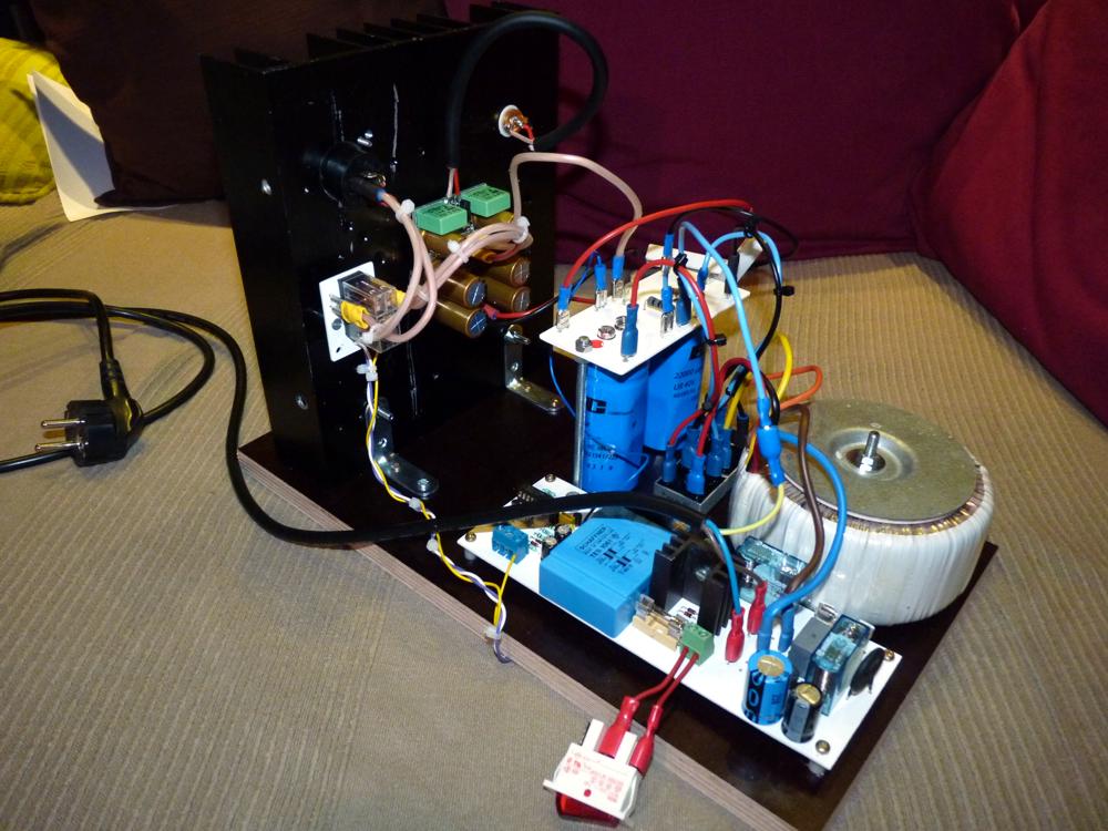

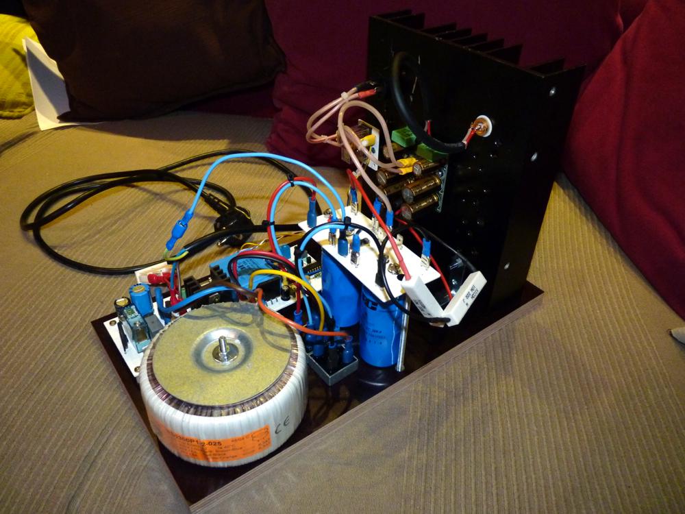

VSSA Crappy Mode
This morning i go foward to stage "ready to adjust" for the first chassis test. The second is on way but still need a little more work. On last serie picture my 22R pactch wire for first power on...
Marc
