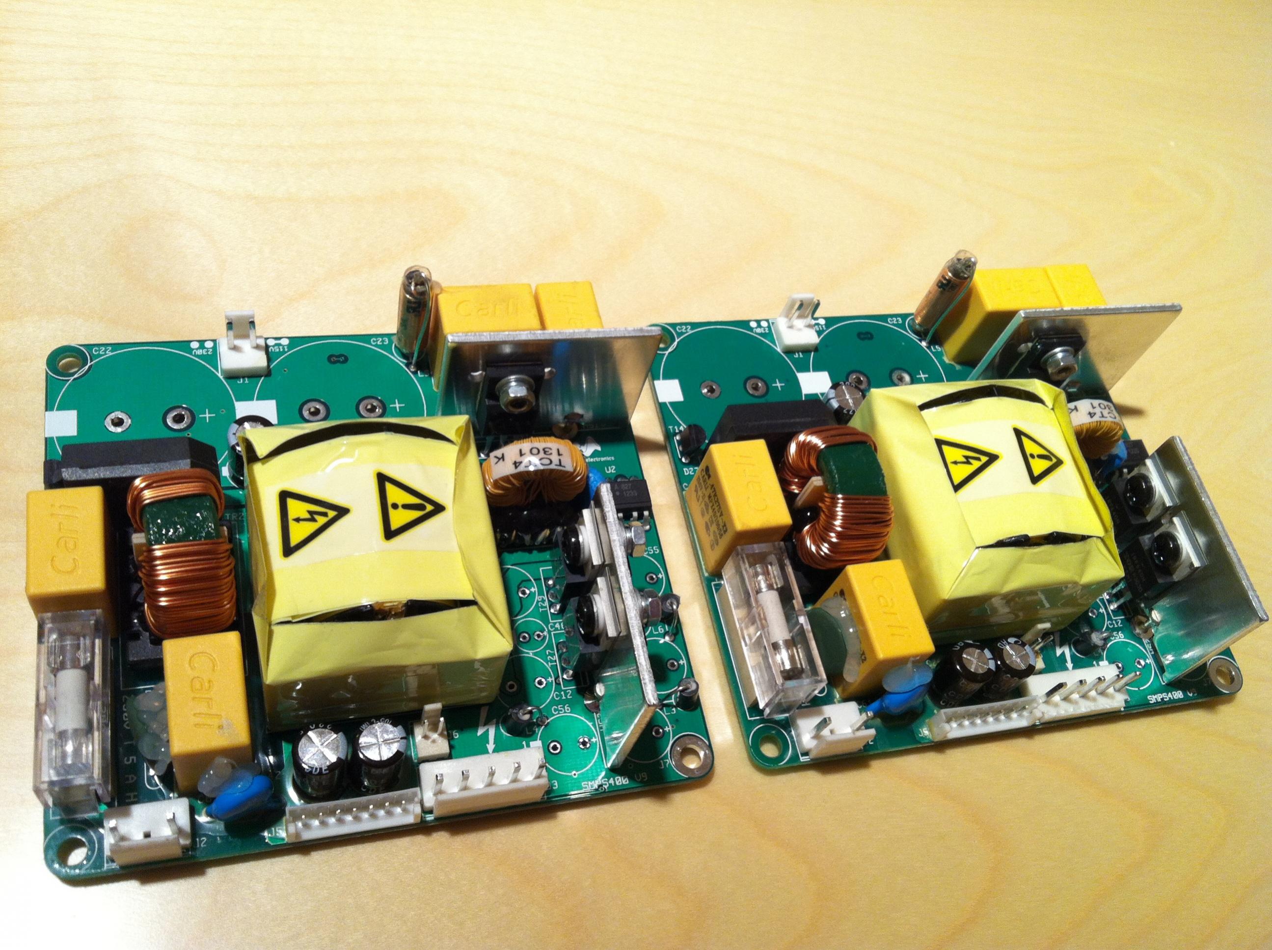

May-i insist only on one point ? With SMPS, take great care to shield carefully the smps from the analog parts (amp and wiring).
Two SMPS in preparation for the next project, cleared of Samwhas and ready to accept Panasonic elcos. :wiz:

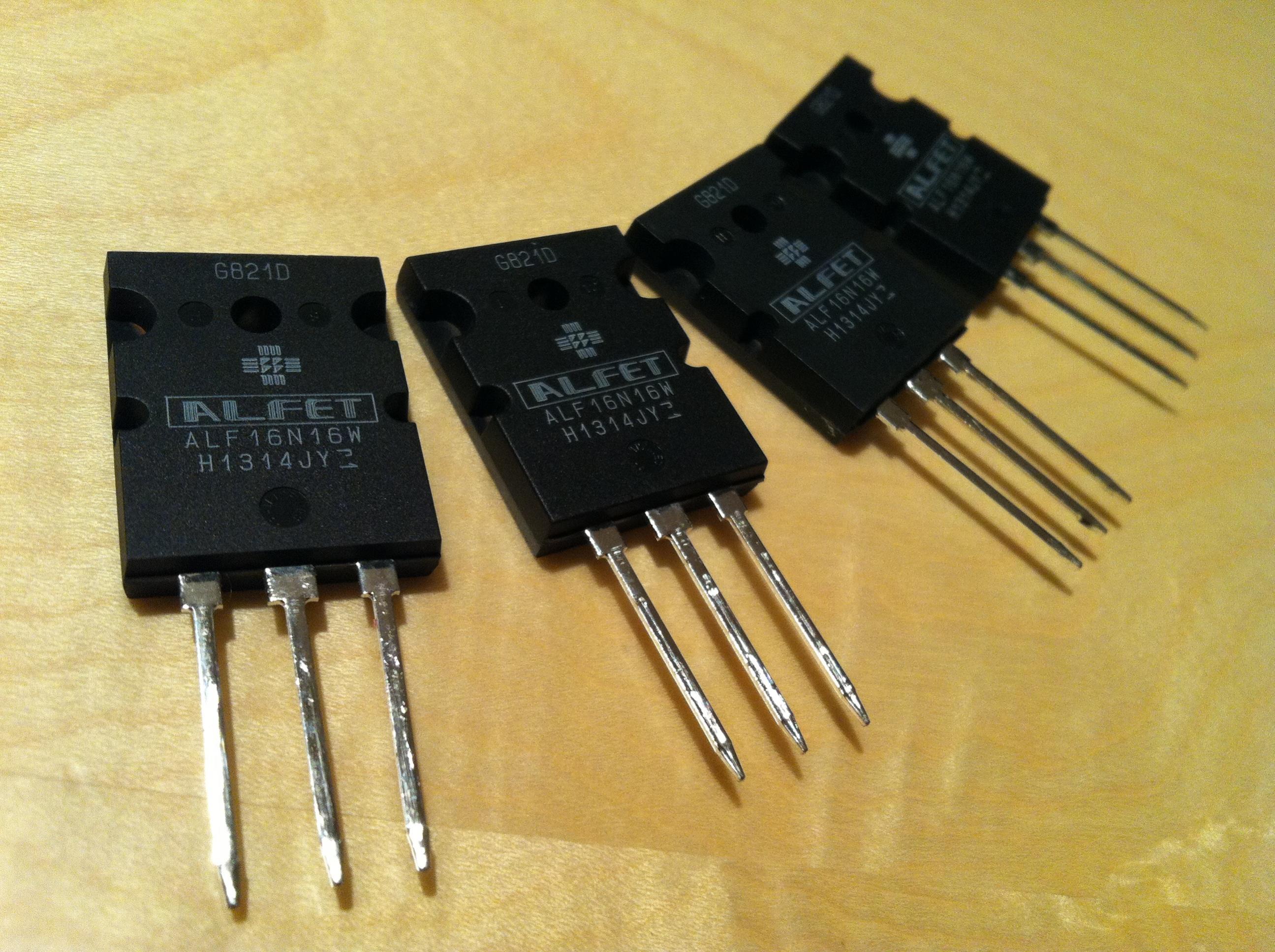

Double die 16 A/250 W laterals just arrived, also ready for the next project. :D
Did you get p-channel fets also? I have 8 n and 8 p for almost a year now, but besides building dac and your VSSA didn't have time for anything else.

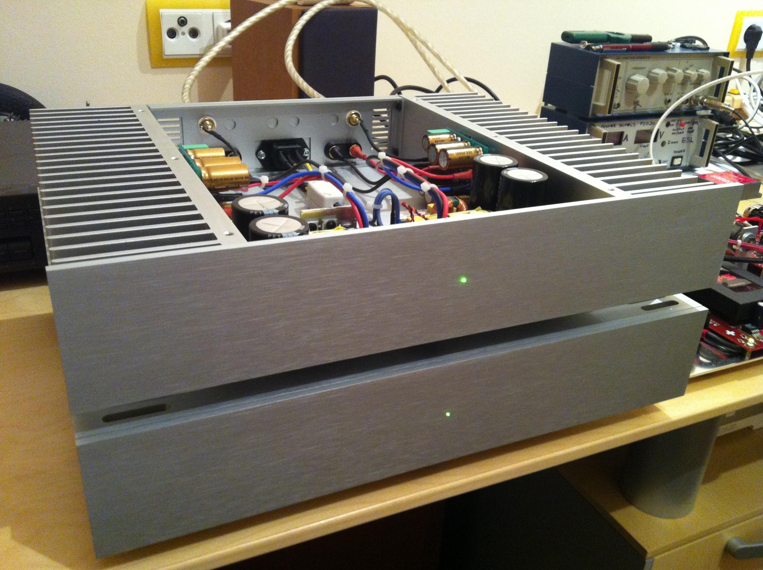

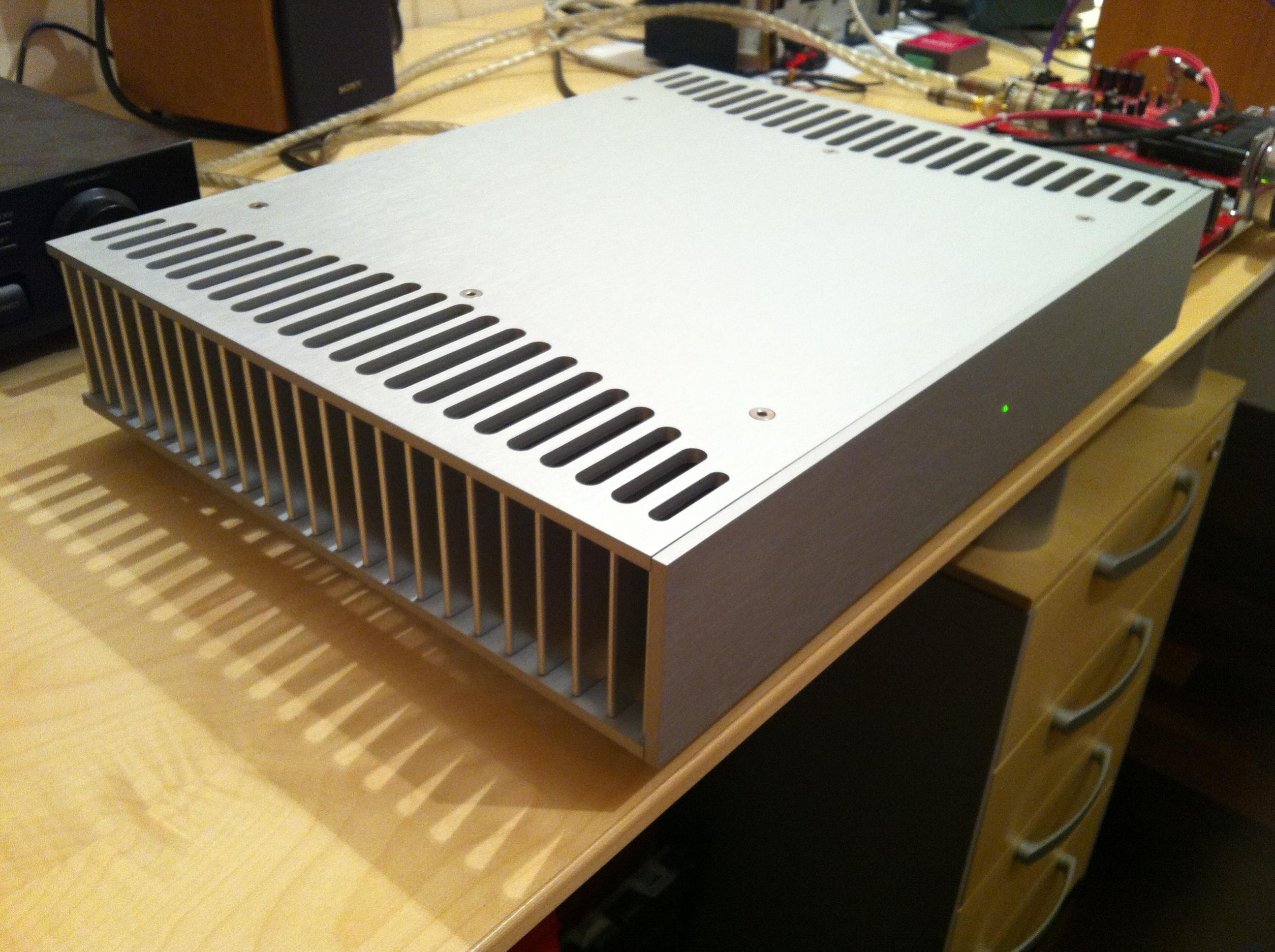

How does this case (SQ) compare to the other cases you filled earlier?
This VSSA official case is made out of the best Aluminum material possibly find around here because of the final brushing finish. All plates are fine brushed so the material needs to be very homogeneous. Plates thickness is 5 mm, they're pre-drilled with threads where needed and the case is adjusted to zero gap, plates tightly touches each other. :cool:
Regarding SQ (sound quality) I can tell that it is much better than my demo wooden "case" since the grounding is perfect so the lowest level signals are not lost in any kind of noise. No interferences from outside, all Aluminium material meaning no amplified magnetic fields formed in plate material. :cool:
